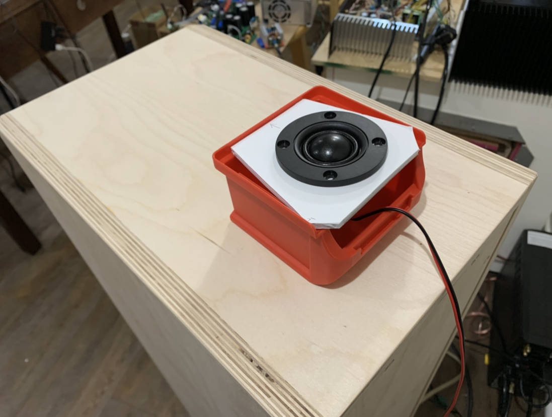

I was playing around with a 1in soft dome mounted in temporary parts bin box so that I could move it around. It’s an ND25FA-4 with 4.7ohm series and 1uF MKP connected to main binding posts of my 10F/RS225 FAST TL. Pointed straight up seems to give spaciousness to the soundstage and definitely more air and sparkle. But it’s not for all music. An on/off switch would be good.
So it’s a STAFAST? 🙂

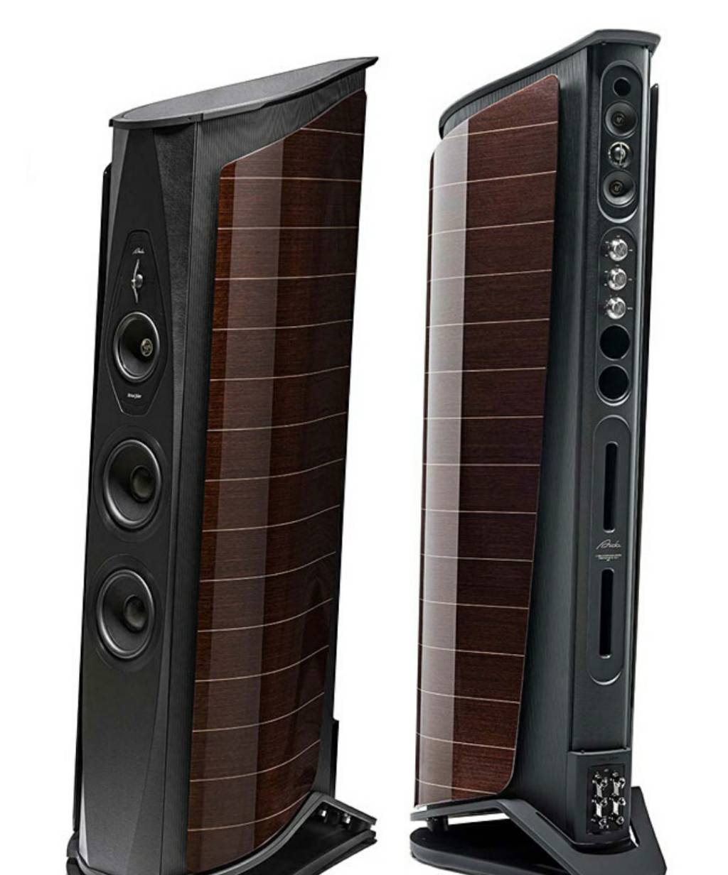

The theory is this, the reverb signal from the tweeter if less than 10ms delayed (I think, need to check it up) shows up as distortion. If more than 10ms, the brain processes it as a completely new signal and this signal gives a clue to the size of the space or the surrounding. After all, real musical instruments are omnidirectional. I hooked it up to my minidsp and added in more delay and the space can get deeper. However at about 30ms, you will hear it as a distinct echo and could be annoying.
This is not a new concept (and I didn't invent it), can be found in many 6 figure speakers such as Sonus faber and McIntosh.
Notice the 3 speakers on the rear of Sonus Faber Aida.
