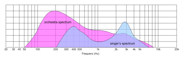

Much of intelligibility is helped from the letters s and t.
The uppermost harmonics of these letters is around 8khz.
I'm not sure what you mean by "delay sensitive region", is that anything smaller than your head? 🙂
I'm talking about the way that a crossover can be more critical to various issues when done at certain frequencies, similar to the (group) delay sensitivity variations or the Fletcher-Munson curve, which also have similarities.

xrk, I can't see the agreement. The mid is crossed around 5k, this isn't a natural rolloff on its own.
Based on the term 'super', I'd think a supertweeter is more 'added on' than 'crossed in'.
That Graph doesn't seem to match other references, which suggests a male voice goes down to 100Hz. 100Hz to 4kHz would seem to be the requirement there and the scanspeak 10F on paper seems to be a driver that would do that. Would a tweeter to infill the off axis drop be considered a 'supertweeter' in this case?

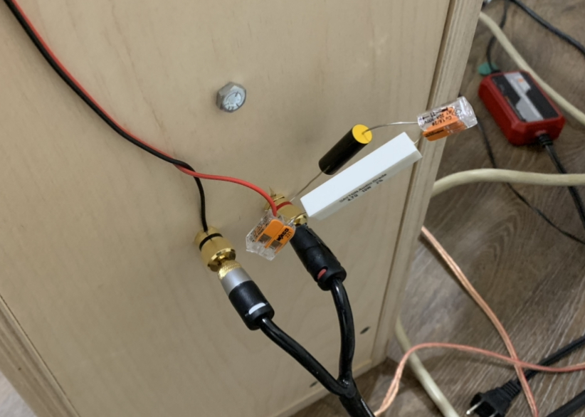

I have also played a lot with sTs, they sometimes work, sometimes not.
Have you any ideas what determines whether they work or not?
So that would mean you bring that tweeter in, above the 10F crossed high without a filter on the 10F?
That’s right, the 10F runs to its upper end full range. Only filter is the high pass crossover with the woofer near 900Hz (1st order).
I have the played with the ND25FA-4 tweeter with a single 1uF cap as a high pass. I used 4.7ohm series resistor to attenuate the level to match the 10F better.
