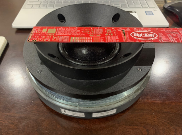

Does Volt VM752 count? I have been designing the ultimate 3-way on commission for a friend and it’s certainly a crazy special driver. The magnet is the size and weight of a 12 in pro audio driver.
Currently planning on RAAL 70-20XR tweeter in a waveguide and dual 8in woofers (TBD) in a tapered PMC like TL. Passive XO - as close to transient (super)* as possible.
*time and phase aligned at selected listening point.

The Volt driver has extremely comparable parameters and cost.......but if Vance’s measurements are accepted, the Volt does not have either the deep but very narrow notch at 4.8khz that the ATC does nor does it have the related energy storage shown in the waterfall........so on paper, it’s the better driver........but we both know the proof is in the listening. I certainly don’t have the resource to compare them side by side but when the stakes are this high......the crown of transducer performance, I’m sure someone will tackle this epic head to head.
I can’t fathom any other outcome for your design other than spectacular.......I’ve worked on several alignments using the ATC.......be prepared to be forever changed by the experience...........i’ll Be expecting afterwards to see a lot more of you over on the multiway forum! If your permitted by your client, please start a thread tracking your process.

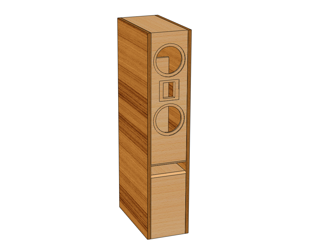

I have plans for a WTW TL using dual PTT6.5 and a RAAL 70-20xr. Idea is to cross at the top of the woofer’s falloff at 3.5kHz. It’s basically running as a full range even without a low pass filter. This is super tweeter assisted wide band? Drivers have been ordered. Cabinet plans ready to go.
