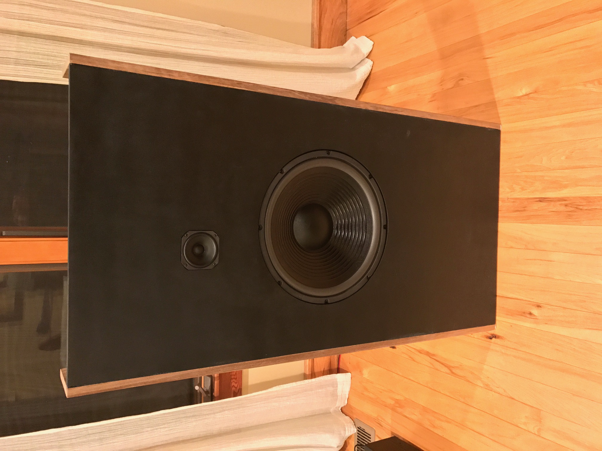

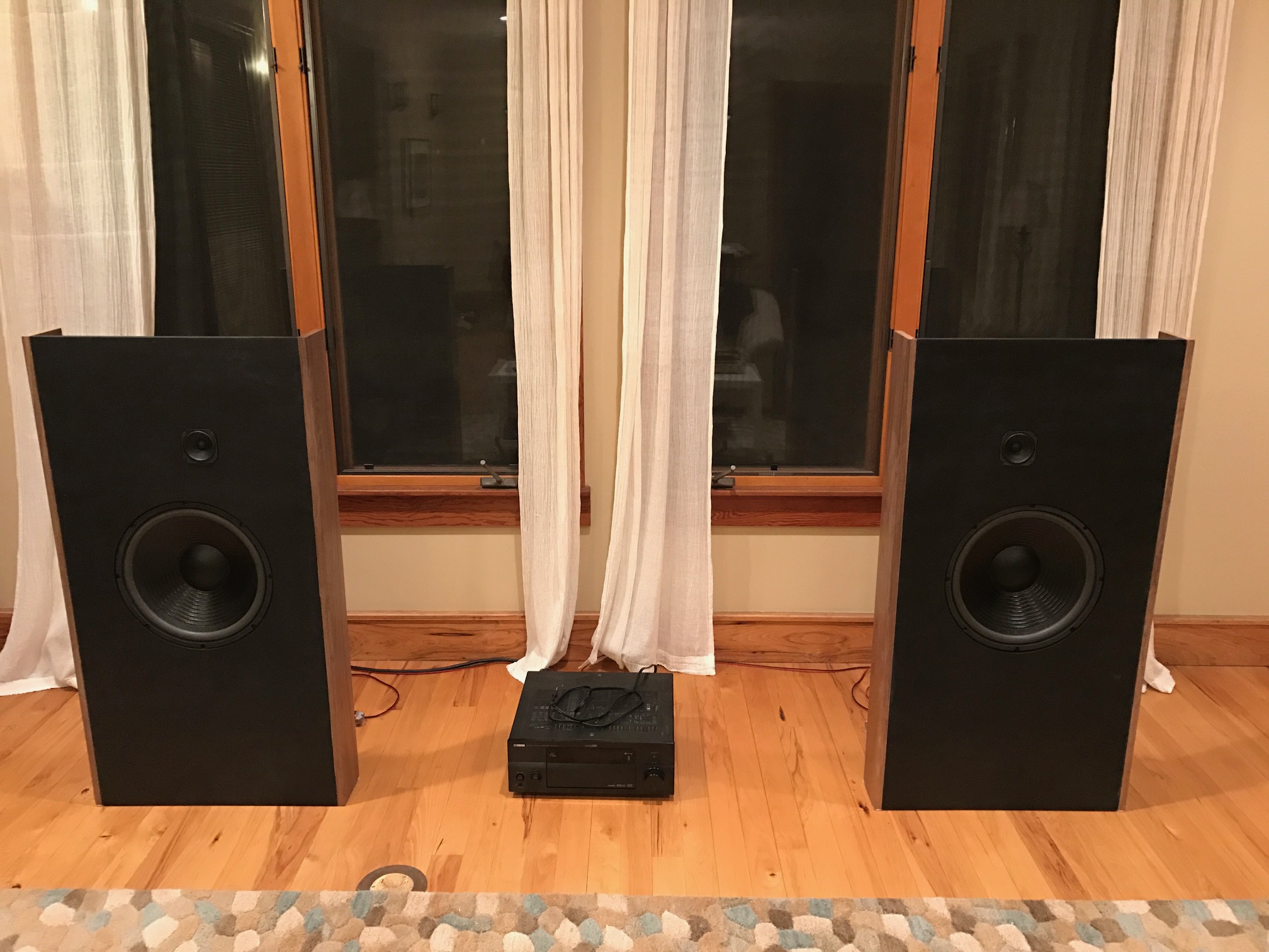

Here are the speakers in almost finished! Sound great on the first run. Will give more feedback as I get them broken in. Pictures for now. Great project - really enjoyed it. Thanks for all the support.

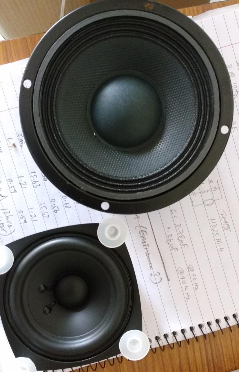

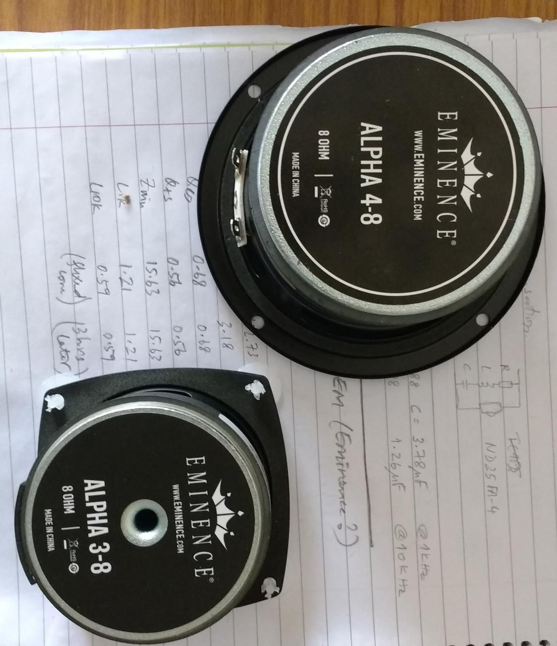

Just did a quick listen . Used the following drivers.
TC9FD-18-08
Eminence Alpha 3A-8
Eminence Alpha 4A-8
Eminence Alpha 6A
No crossovers used. Direct from a Behringer 500 power amp.
The Alpha 6 A is the most sensitive driver. Needs to be crossover over to a HF unit. As it is , it sounds a bit rough in the upper mid as there is a peak there.
The Tymphany TC9FD is noticeably less efficient than the Alpha 3A . It's surface area appears to be more and possibly can go a bit lower than the Alpha3A.The Alpha 3A appears to have more HF .....wonder if that is because it sounds louder than the TC9D! A direct ( same level signal ) side by side (A/B) comparison makes the TC9D sound dull compared to the Alpha 3A.
The Alpha 4A is significantly more efficient than the Alpha3A and has a very much larger surface area. More low end. Definitely needs support at the higher frequencies.....crossed over high.
I think the Alpha 4A with a 3/4 inch dome tweeter should sound very good. Don't really need a 1 inch dome unless there are other reasons ( like SQ ) to use that.
Will rig up one on an OB. I have a 1 inch neodymium dome . I don't have any 3/4 inch unit.

Thanks for the info on the Eminence drivers. It's good to look for other candidates for the fullrange tweeter. The TC9FD is a very good driver, but as you mention, not very efficient.
That lack of efficiency is just fine once you have tamed the tonal balance of the single OB woofer, it's not going to be very efficient on OB. But if you want to go to a double woofer build, the poor little TC9FD will run out of gas quickly - it just can't keep up.
Maybe it might be an interesting experiment to try the Eminence Alpha3A against a 1 inch dome tweeter crossed over at say 3Khz . With an active crossover. Can it really compete ? The 3A cone looks really small compared to the TC9FD.
Just occurred to me that the 4A and 3A could work together with a crossover !:) I need to measure their frequency response before doing any further tests. I'd probably do that on an open baffle. The 4A doesn't sound dull but certainly lacks 'air' ....sparkle!
