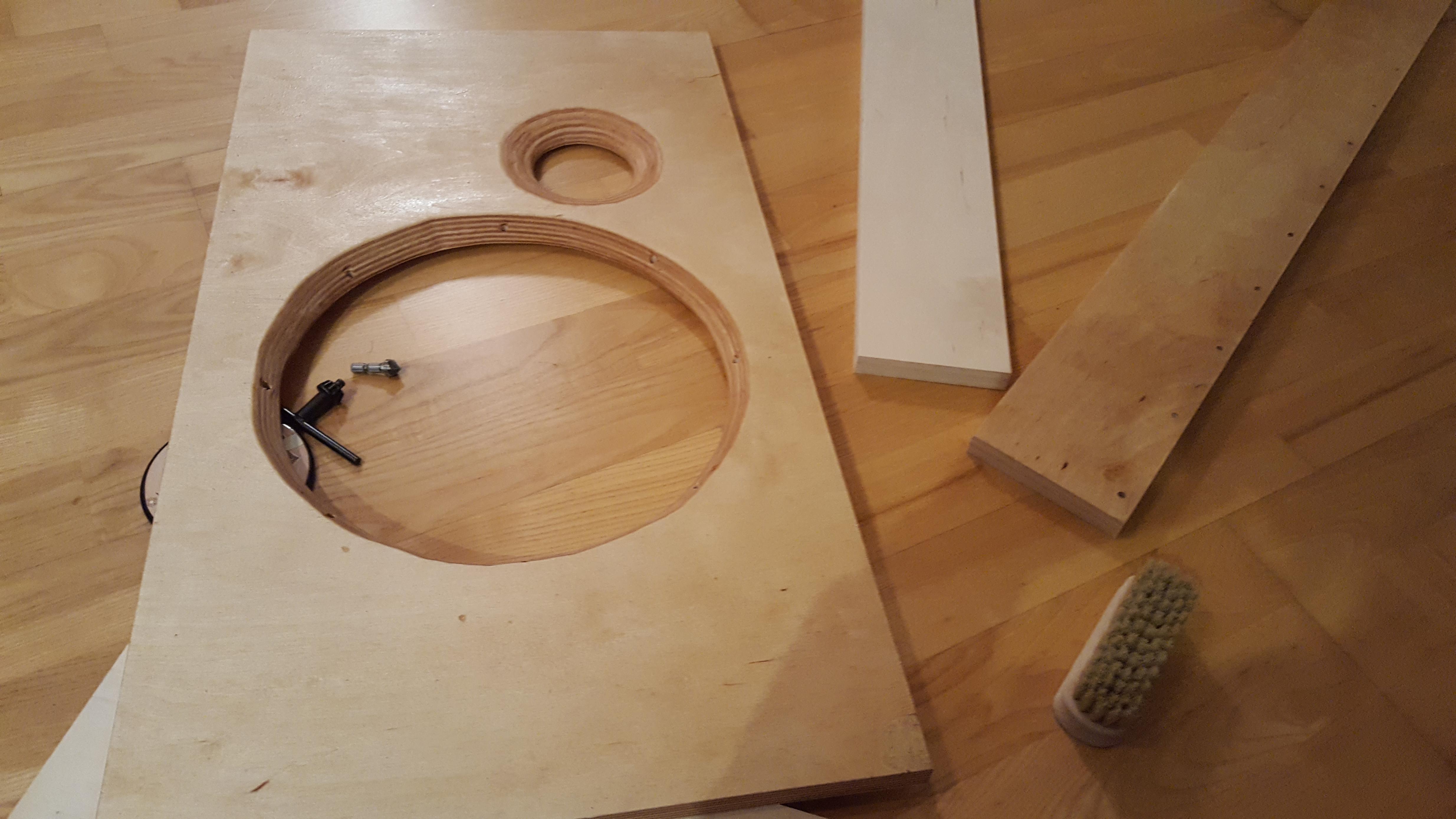

I have just fired up the first Manzi and it's a bit of a mixed bag. Lots of grainy midrange and treble plus some amazing very low notes occasionally. Seems like 4.7R padding is way too low for my room. Or could this be because I made the back of the Vifa baffle into something of a flare?

Last night a fellow audiophile friend came to listen to my new baby and we tweaked the speaker some more.
First, we established that by moving it to 1m from the wall did indeed flesh the music. It wasn't enough though, it still didn't sound right in comparison with a good HiFi floorstander - there were some distinct bass notes, but strangely disconnected from the rest of the music, male vocals sounded thin and upper midrange was shouty.
So we grabbed a tone generator app and played some tones. Turned out the speaker was very much unbalanced - above 600Hz or so it was loud, below that it was quiet.
So I went and installed a ridiculous 18R pad and finally we were onto something. The music started to gel, and the speakers blended together into a coherent performance. I felt Vifa could do with slightly more padding, but even as it was, it played some very satisfying music.
Also, I discovered a slight gap between Vifa and the baffle, so I may have been unfair to this little speaker. I'll re-mount it today and see what difference that makes.
In any case, I am starting to fall in love with Manzi!
Especially the Peerless part - the bass is ridiculous on that speaker, it is easily both the meatiest AND the most airy tuneful bass I've ever heard!
BINGO! The gap is the problem.
How do I know? Well, let's just say my woodworking skills aren't all that good ...
My speakers had a gap around the Vifa and the sound was very much like you describe it. Too thin with a pronounced rise in the mids and treble. A bit of rope caulk around the Vifa filled in the gap nicely and the midrange fleshed out.
I'm going to guess you'll have to change the resistor again after the gap gets fixed.
