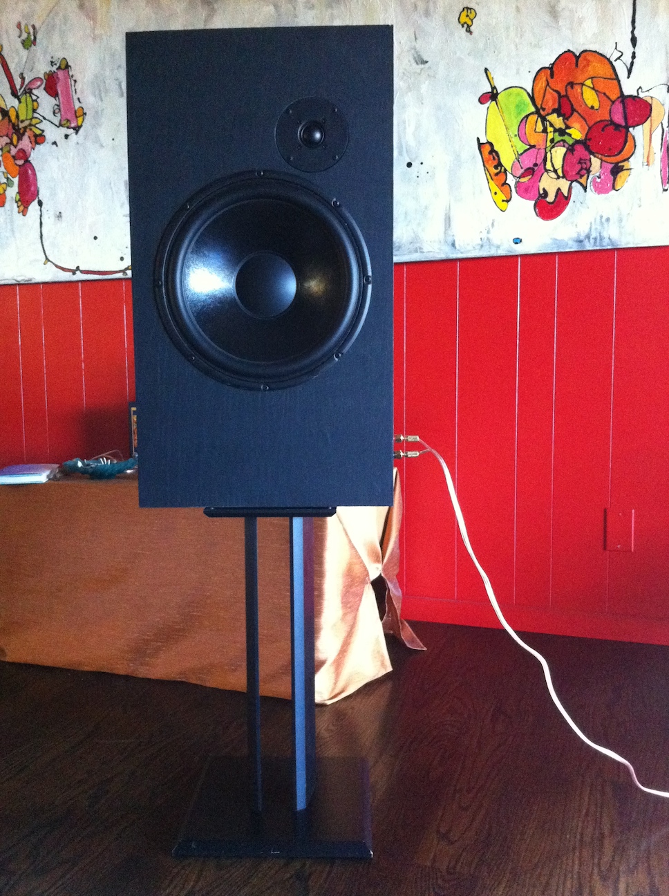

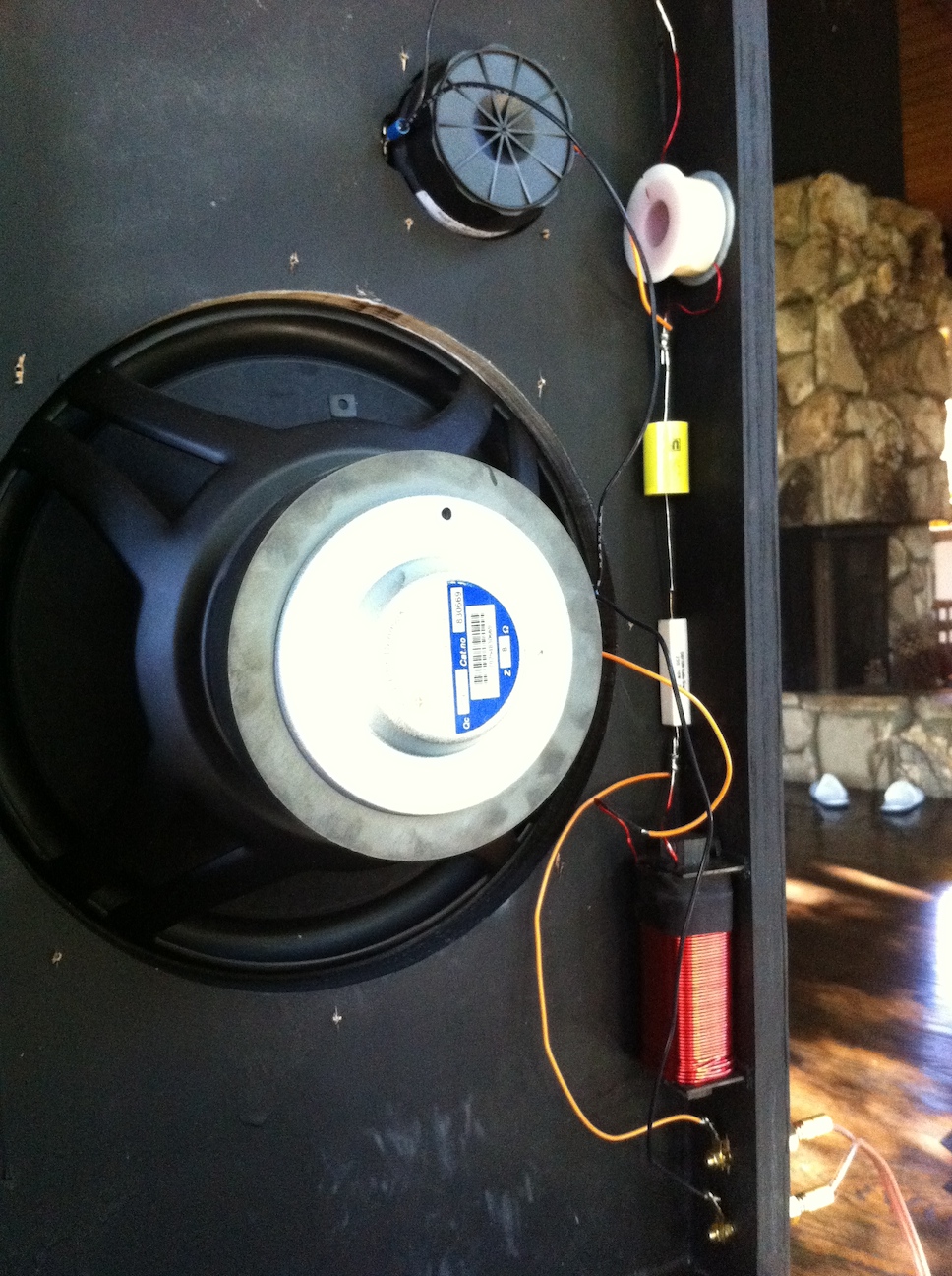

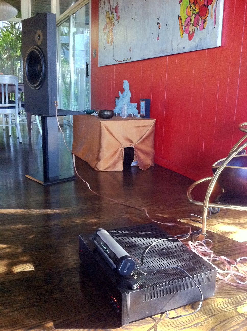

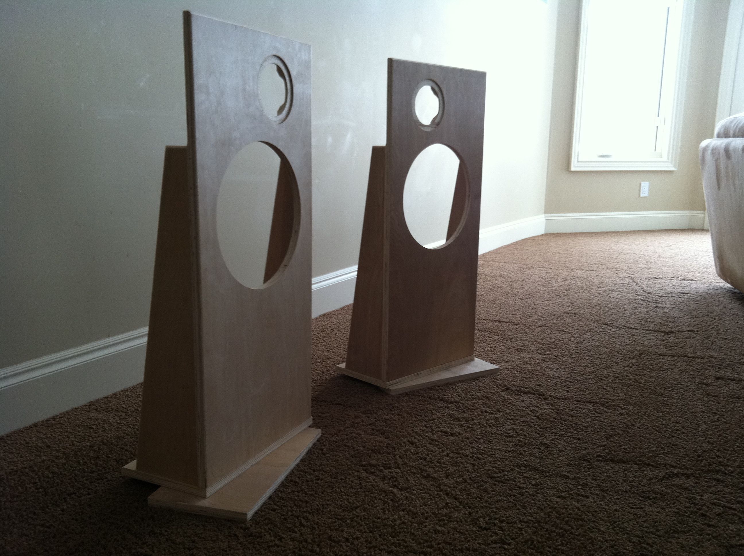

Thanks for the fast response John and thank you for documenting this build. I whipped up a quick baffle for today using "jermone69's" slightly shorter baffle and an LCR trap for the woofers' break up node.
So far I'm pretty impressed. This speaker sucks up power like nothing else! But it's worth it for that balanced bass response. I'll post up some pictures when I get a chance and maybe start a new thread when I start tinkering with it a bit more.
From that alone, I know you've done it right.
The low efficiency is the trade off you must make for good bass in an open baffle speaker of that size. Not many people realize this - at least judging by many of the open baffle projects I've heard. One nice thing about that Peerless woofer is that it can take the power needed.

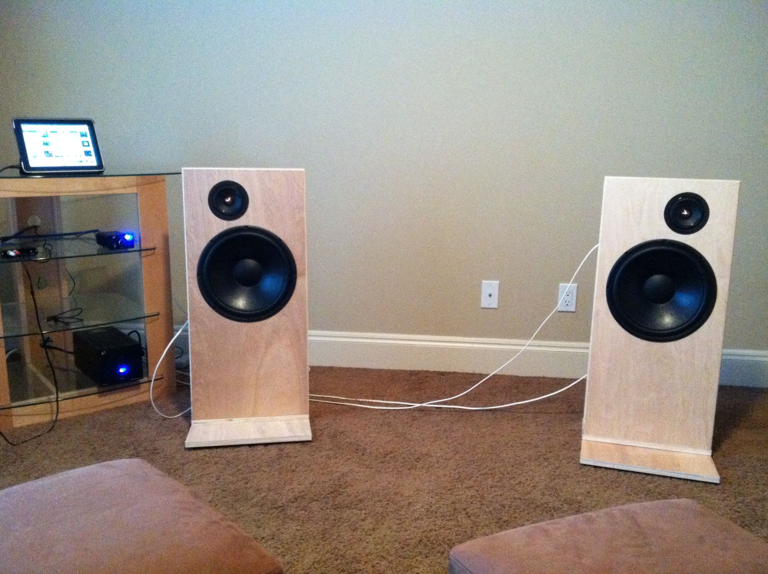

For my second speaker project, I humbly submit these which are heavily influenced by this thread. They use the same Peerless SLS 12" woofers. The high frequencies are handled by CSS FR125SR's. Crossovers are active using a MiniDSP. The baffles are 15" wide by 32" tall with 24" tall side supports (winglets) that vary from 6" wide at the bottom to 2" at the top. Right now, the drivers are breaking in -- they have about 18 hours on them.
The crossover is centered at just over 200 hz for the initial set-up and PEQ filters in the MiniDSP are great for compensating for rising baffle response. They are basically flat down to 40 hz (but, as Pano and others have mentioned, you really have to pump the gain on the woofer amp to feed them with this sort of compensation).
So far, I'll just say that the bass is really tight and well defined. The mids and highs are also very detailed. They're very enjoyable to listen to -- not tiring at all. I love open baffle sound.

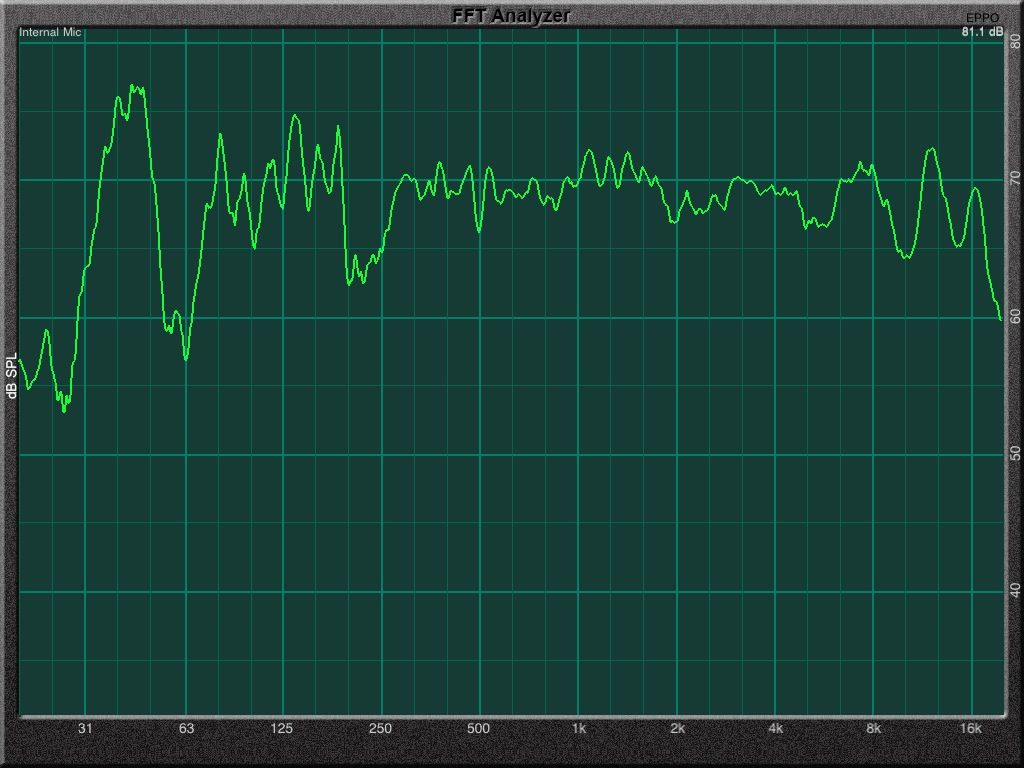

I use a MiniDSP with the crossover set at 200 Hz (24 db/octave both ways). In addition, the Peerless 12 inch have a PEQ filter that ramps off 11 db as the frequency goes from 50 to 200 Hz and the CSS have a broad PEQ filter that reduces up to 4 db to compenate for the dipole baffle peak between about 500 and 3000 Hz. My best friend and my wife both think they sound great (so do I).
I'm using AudioTools on an iPad (available for iPhone, too) to take RTA and FFT measurements in room.

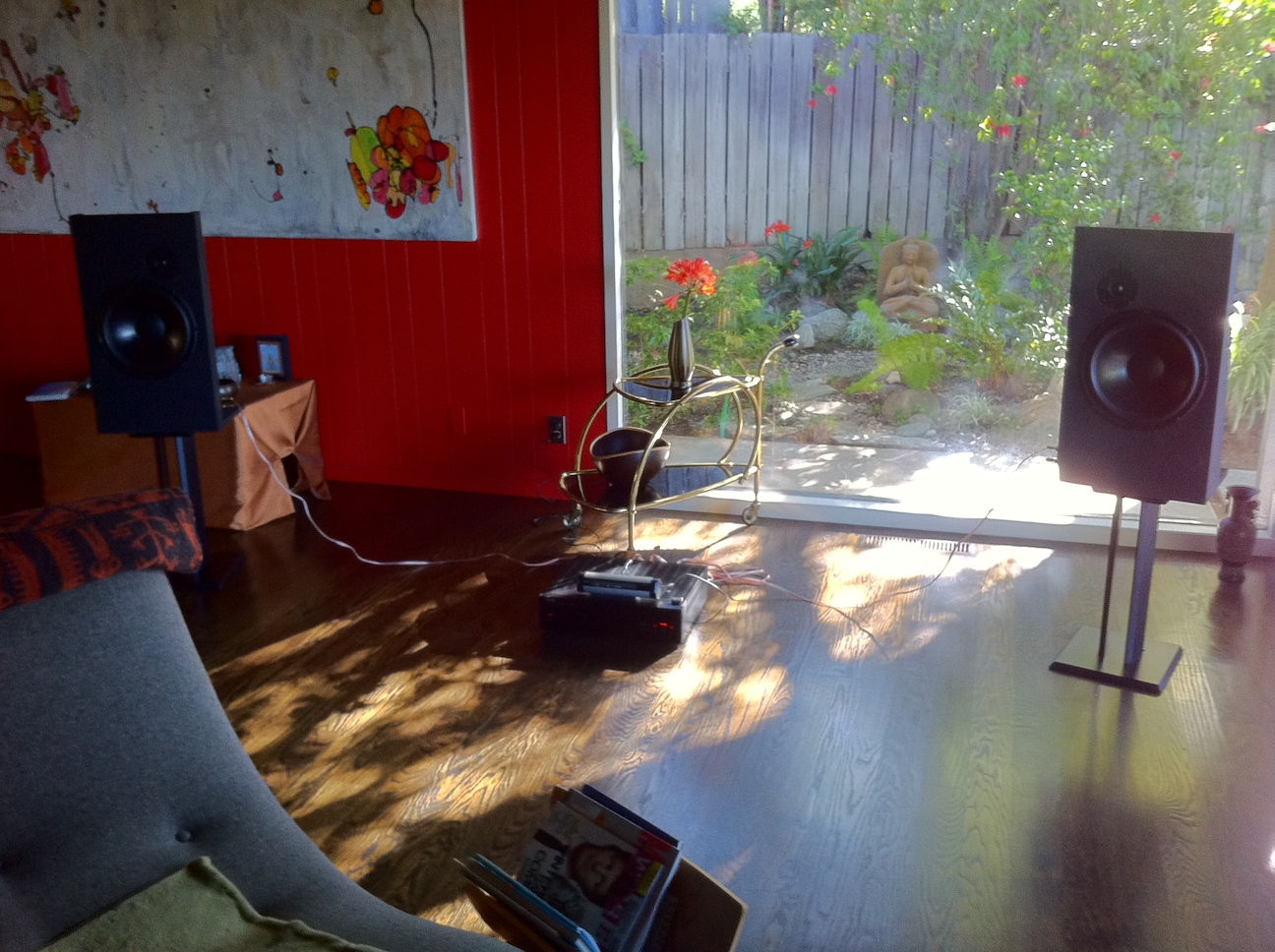

And another pair (actually two pairs) goes live!
Together with a friend we built two pairs. Mine just went home this past weekend. This is the original Manzanita design. All passive with the crossover done p2p on the back of the baffle (see tail picture). It is currently on provisional stands in a provisional location getting broken in. Driven at this time by a six channel Rotel unit (two bridged). Boy, these babies drink up the power... (But you all knew that... ) The surface is painted with chalk board paint and will be beautified with a hand drawn chalk painting.
So far so good. I am not yet very happy with the accuracy of the imaging I must admit. But the tonal balance is good. The baffle vibrates quite a bit and I can now see why people consider "naked" speakers. Maybe that's next. But first I want to run some experiments with active crossover (Behringer) to see what's possible in that direction. Curious to see whether the sound would benefit from that.
Overall a very satisfying project.

Yeah! Way cool
- thanks for posting that. Glad you had fun.
Yes, these beasts are power hungry. That's the trade-off to get bass out of an OB that size. No free lunch.
After you've gotten used to them, try adding the triangular side wing as seen in the top of the thread. It should flesh them out a bit and may change the imaging. Let us know what you think.
Then after you've lived with them for a few months, you may want to try a small fullrange driver in place of the tweeter. But we'll get into that later. BTW, which tweeter did you use?
