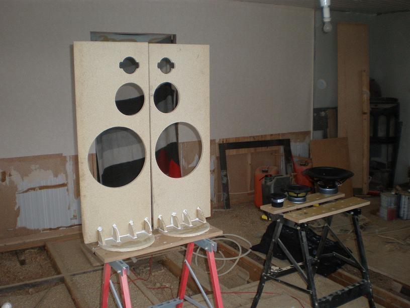

Cool! I like the feet. Hmmm... I wonder where you found those? 😉
Yes, add the wings for sure. They will help with the bass and efficiency.

This looks like a nice project! Can anybody tell me if my listeningroom (6 x 4 meters) is big enough for this speaker?
Greetings,
Bartel
Greetings,
Bartel
As per Pano's reply, your room size is fine. One important issue is distance from the front of the baffle to the rear wall. 1 meter to 1.2 meters is typical. This usually provides the best tonal balance and image - sound stage. Naturally, every room has it's own sonic qualities, and some speaker placement experimentation is required. Moderate toe in can also help with image depth and width. Please let us know what ends up working best for you.
