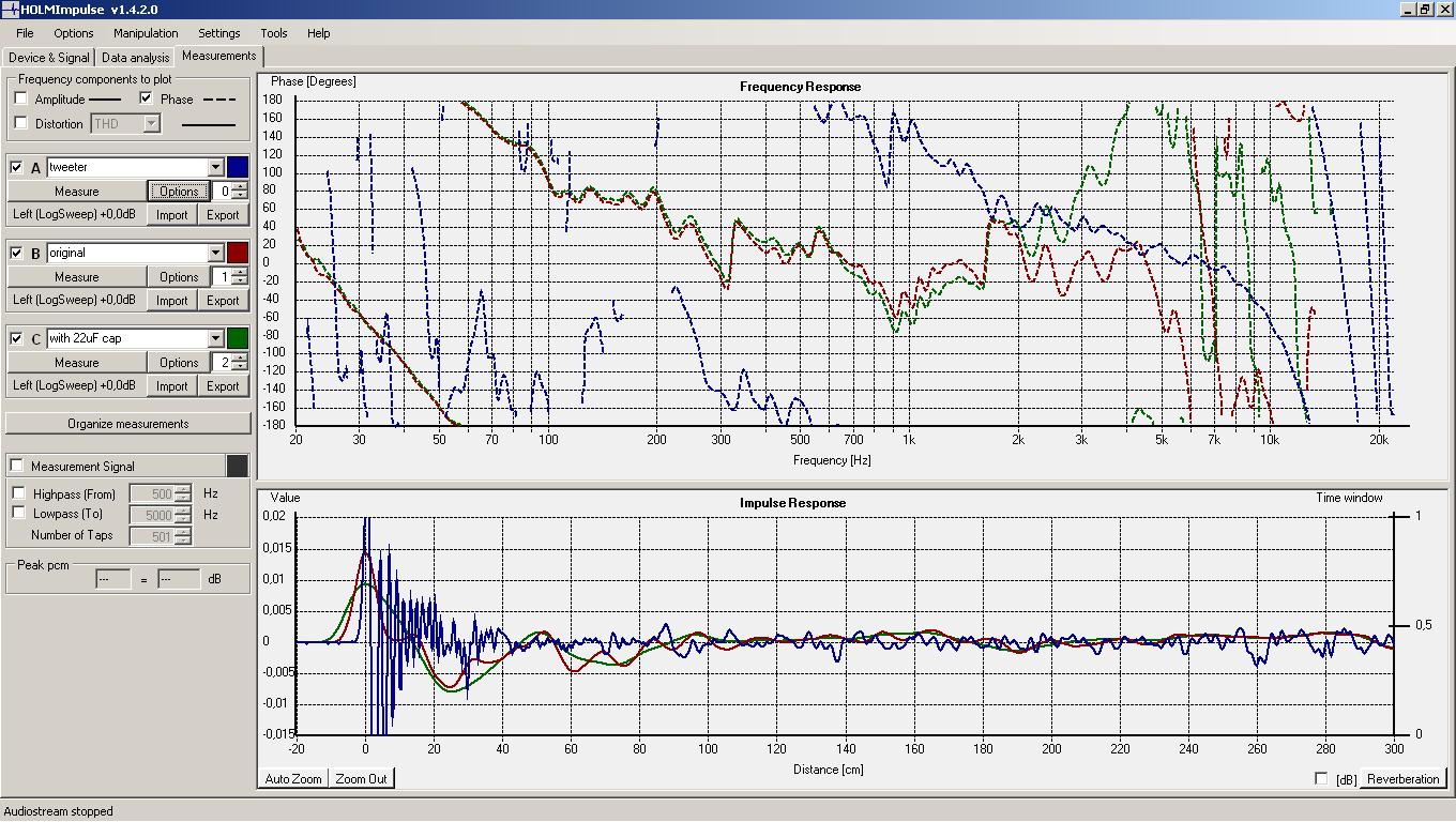

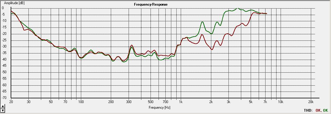

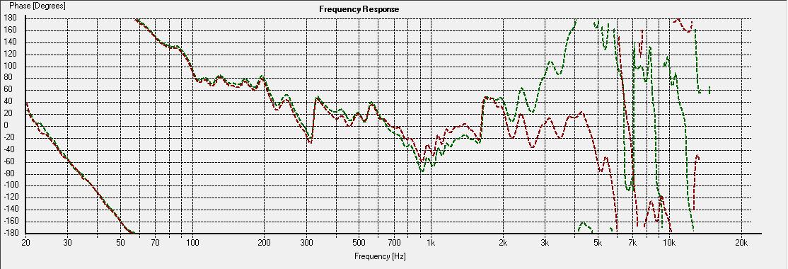

Here it comes: dont put to much value into my measurements as they are done in a "not ideal room" at all, espesially the thd since the S/N in my room where only about 40-45dB during the measurement. You can however use them to see simple trends 🙂
All measurements are shown with 1/12 octave smoothing.
pic 1: shows the woofer amplitude with and without the extra capacitor.
pic 2: shows phase w/wo extra cap.
pic 3: (sort of) shows the THD w/wo extra cap.
pic 4: shows the tweeter and woffer response with my mods
pic 5: shows the tweeter and the two woofer filter versions phase.
Mabe I will ad a picture of the baffle the drivers are mounted in a bit later. And mabe even a xo schema so there will be no confusion to what i have done 😉

Thanks for posting your measurements...very informative
Appreciate your sharing your measurements. Have often thought about a narrow trap for the Peerless centered around 2.1K. About 6-9 db of depth would do the trick. But the cap you have selected does obviously help and is inkeeping with my original "KISS" design theme.
