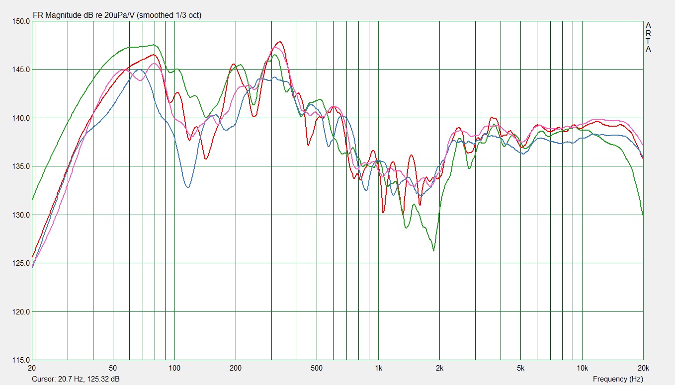

First measurements: trying to sort things out
So I finally got around to hooking up all my measurement stuff and took the first measurements of my Manzanitas (original design) tonight. Below is the screen grab from ARTA. Basically I took several measurements varying the distance to the back wall (from 1-2.5m) and the distance of the measurement microphone from 0.5-1.5m. The overall shape of the response is pretty much the same. I took the measurements in a room which is fairly "bright." Overall dimension along the measurement direction is 8m. The overall trend of everything from 1-2kHz on up being relatively lower than the frequency response below that matches what I am hearing. I was comparing the Manzanitas the other day with my Plutos and there definitely is less volume in the higher frequencies on the Manzanitas. So it looks like I need to think about less attenuation in the high frequency path. On that note, what is the cross over frequency for the Manzanitas? Does it coincide with the drop that I am seeing from 1-2kHz on up? I wonder whether others have seen this too or whether that is particular to my listening environment. As that case may be, one question is what I should do to the cross over to lift the higher end.
My overall goal in these measurements (and the ones to follow) is to see how things will turn out if I go active. Has anyone tried this? I have a DCX2496 that I want to use for this purpose. Any stories to share on that kind of setup?
Thanks much!
Peter
