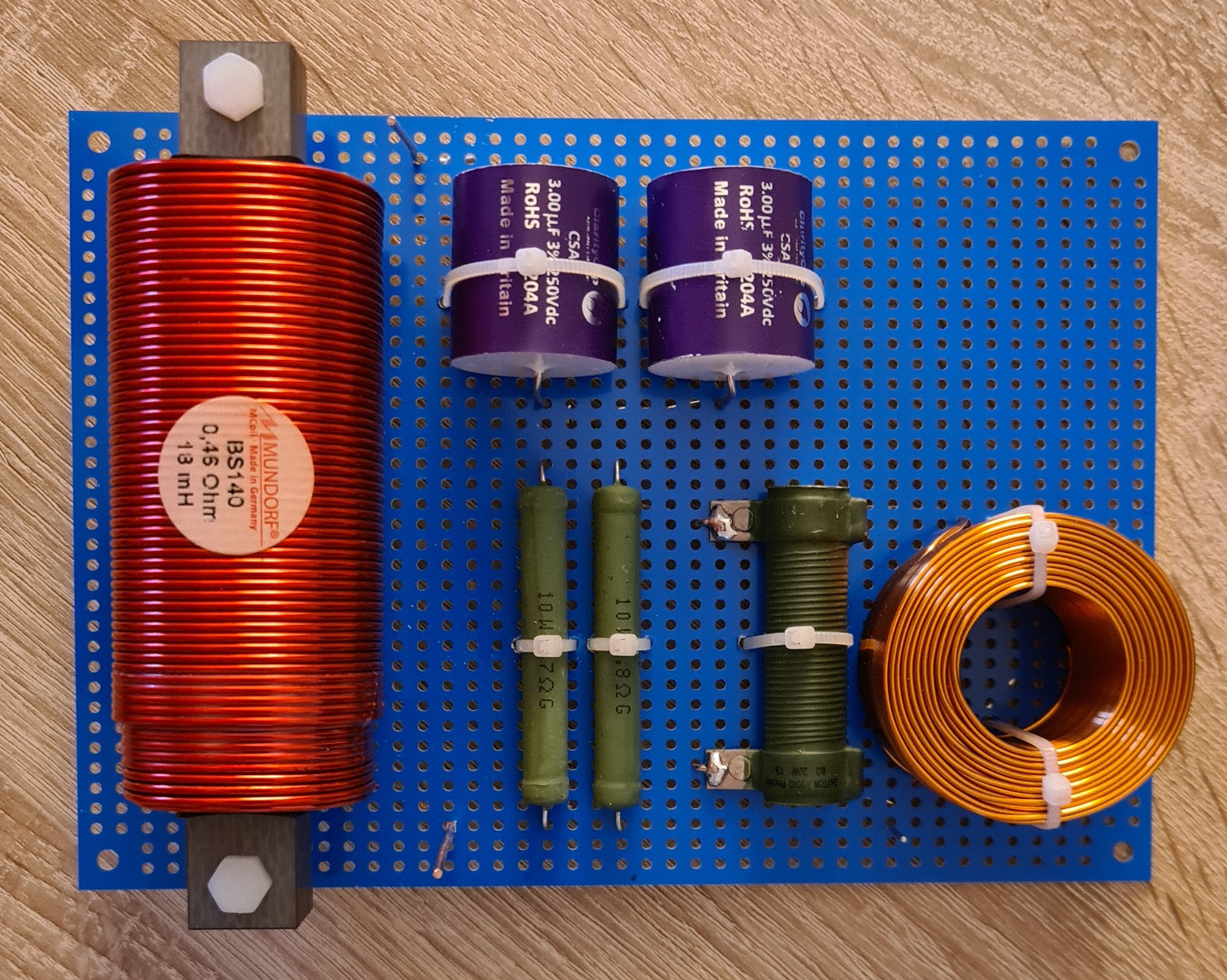

The parts for the xo arrived today, so some soldering work had to be done. I think, tomorrow will be the day of the first listening.

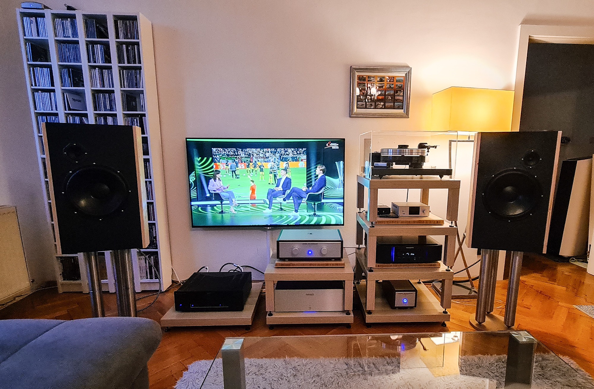

Ugly-nitas finally received last parts, and are now plugged in.
Jeeeeeeeezus_christ_almighty:
Never have I ever heard a good pair of speakers before
OR headphones for that matter...
sincerely thanks to Pano for keeping this thread Up and alive and John for inventing the whole goddamn thing.
I am totally amazed and will probaby continue to be for the next week or month every time I switch on the amplifier.
Thank you
Sampo
Ps. all this while still streaming through spotify
Thank you
Sampo

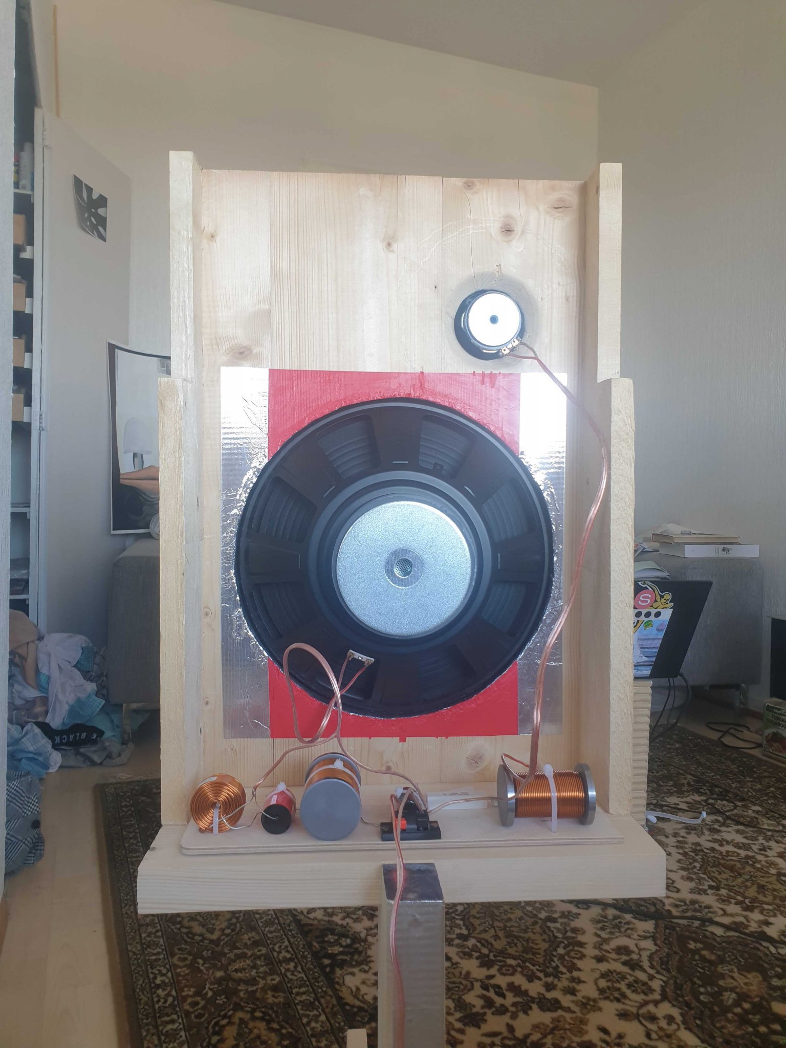

I had read this thread many times, and I admit that all pictures supplied in it has inspired me to build my own pair. As I decided to maker the baffles more narrow, I perhaps overdid them. But I am not a person who just aren't doing things by the book if there is any. So by esthetical reasons, I narrowed them down and made the wings deeper. It is not by much, perhaps in total a narrowing by 2 inches more than recommended. It has been a bit of struggle sometimes, and I must say it is only my stubborness that has kept me towards the goal, to make them audible for both "easy" music to more complex (rock). So today I went home from work at the lunch as I work in a company that make surveillance drones 700 meters from where I live. Ate a fast lunch an sat down to listen on how my internally dampened Manzanitas would sound.
So how do they sound? The damping made them in a lack of better words...calmer. The soundstage might not be so big as before, but still sound great. It simply isn't so much going on now as it used to, and I like that.
In the end it all comes down to personal taste and this really works for me. I can listen to David Brubeck Quartet or Miles Davis and really enjoy. Pink Floyd, Sophie Zelmani and other singer/songwriter music just makes me wanna listen more. And finally, they can reproduce rock tracks to an enjoyable listening degree. Ghosts latest release sounded quite well, I suspect it is well produced. Pink, AC/DC sounds nice, Led Zeppelin actually sounds better on these than previously on my boxed speakers.
All in all, for the money put into them, they sound really good with a quality and free from boxiness that is refreshing.
So now, all that are left is the back side fabric, front covers and Sonic Design feets to finish it all off. I'll return with pictures.

Hey Arne, glad to hear that you are making progress.
Before you start building the rear covers, is there any way that you can make a clean removal of your top wing? John and I have used a top wing on some builds, but usually not full width and not square shape. If you have any way of trying the speakers without the top wing, or with one that is only half width, give it a try.
Unfortunately not, and I wonder how my choice of top wing has affected the design. I must admit that I missed that the top wing was not a part of the original design..
Of course, a holesaw would ventilate the top but it is a bit irreversible as well. What would the benefits be if I did that, in theory?

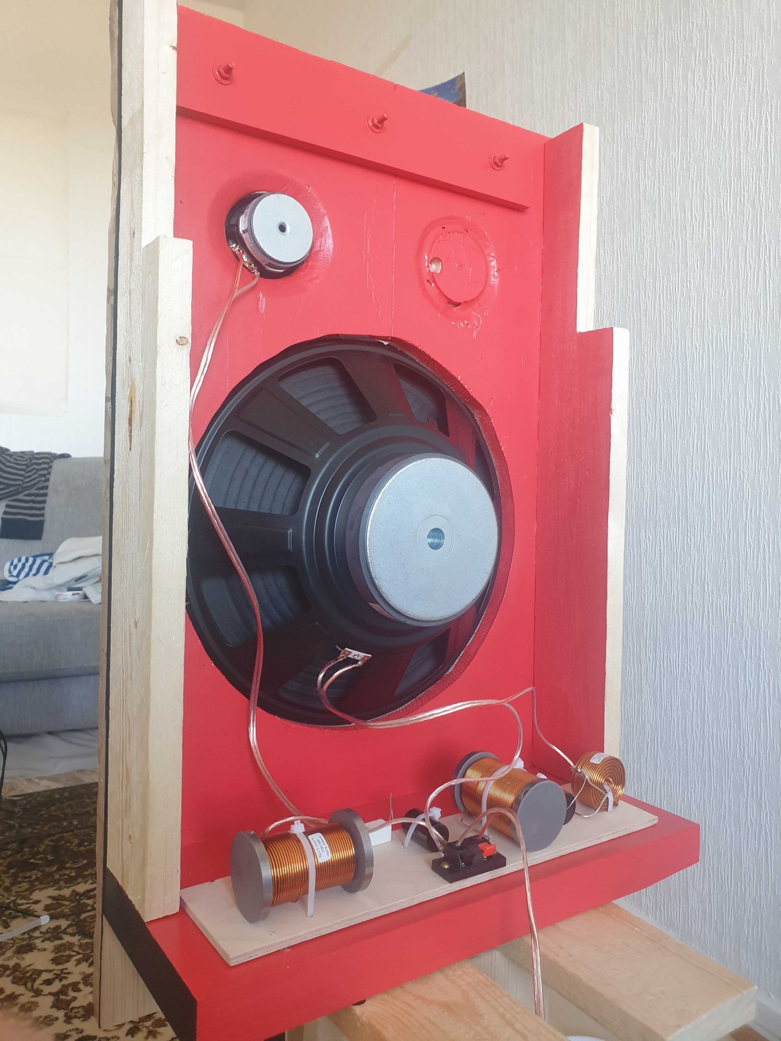

If I remember correctly it took a while for them to settle in. Early on there was a bit of an edge which went away over time. That will likely make bad recordings sound a bit better.
I think you'd end up with fewer cavity resonances. Looking at your build it looks a little boxy - certainly it's a very open box, but it has more and closer cavity than the original design. Of course you have mitigated some of that with the foam, which is good. The modification would be up to you, don't mutilate your speakers if you don't feel good about it. But you've mentioned some problems and they are right in line with what I see from your build.Unfortunately not, and I wonder how my choice of top wing has affected the design. I must admit that I missed that the top wing was not a part of the original design..

One thing you might try is a temporary double or triple layer of foam on that top wing. You should be able to hear if it makes a difference. If you give us your exact build dimensions (in cm) I might be able to see what's happening in a simulation.
I now noticed that I had a wrong placement, the TC9 should be "inside"
Correction made - and there is a big difference. The mids are even more present and live, and some confusion has gone.

Indeed, that may be one of the issues going on. I'll try the tip of the extra foam on top ronsee if it gets any better. Must say that now, with the foam, they really sound good and nice. Perhaps that foam was all that they needed. But of course, it would be interesting to share my numbers to see if a simulation will reveal something.
The outside measurements are:
H 680mm
W 320mm
D 150mm
Inside measurements are:
H 640mm
W 280mm
D 130mm

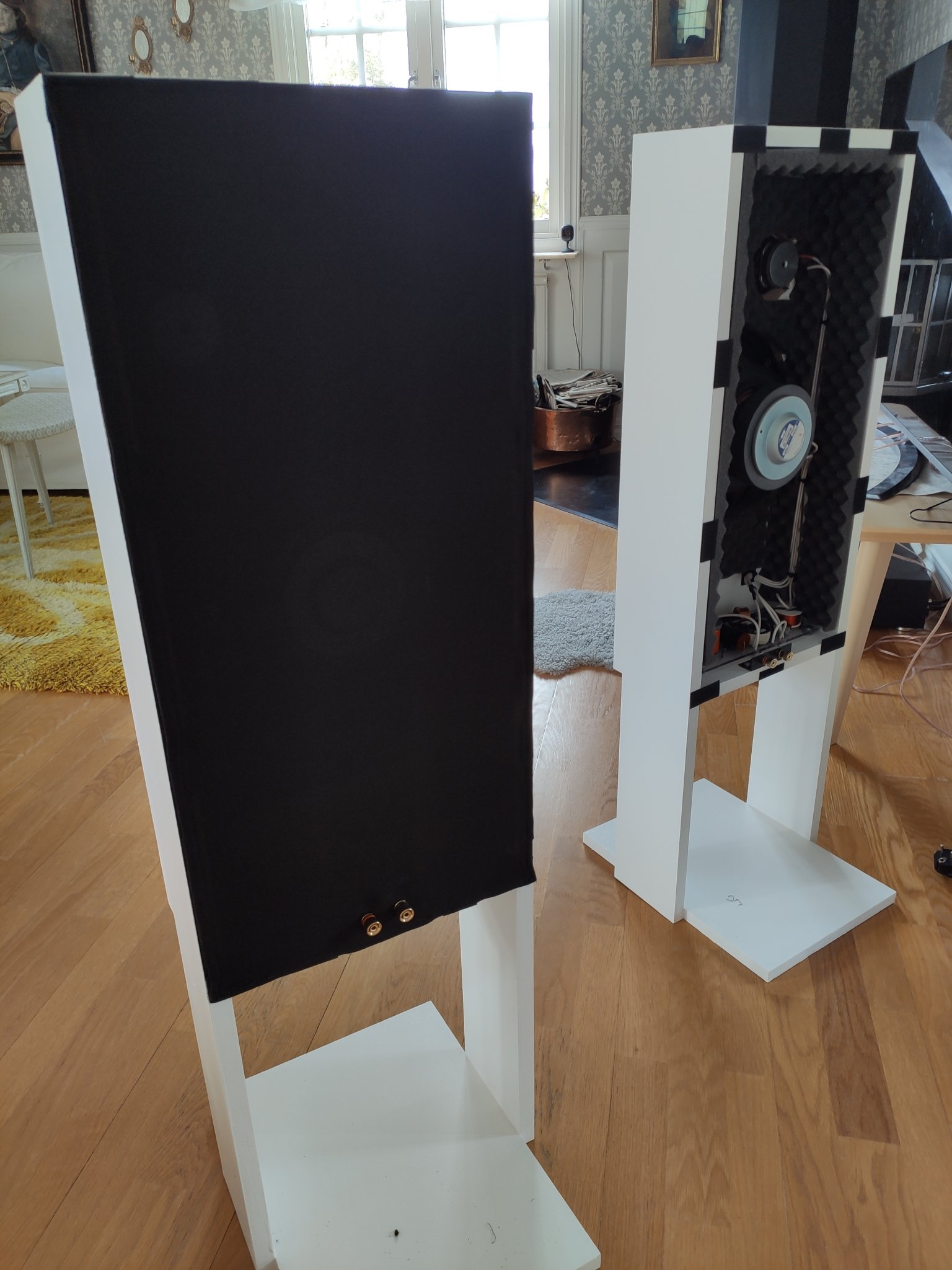

I took one of the last steps today to make the speakers more representable in my livingroom. Crude MDF board does not fly well with my wife, although she is very understanding of my build.
Anyway, I took black loudspeaker front fabric and sewed a back cover for them. They are attached with velcro for easy access to the rear. Unscrewed the terminals and made holes in the fabric and screwed them in place. It looks very neat and tidy.
Just the front covers left. I am still pondering about to saw circular frames for each element in plywood, glue the fabric to them, glue magnets in the same pattern as the fastening screws for the elements...
Or just make a square frame and attach the fabric to it...

Listening time today: 6.5 hours
Fine tauning... I think I have an issue with the bass section. From the 12" Peerless woofer I would expect plenty of bass, but I miss the punch (I mean, that's whining at a high level, there is a very nice bass). So I think I have to change something. I use an 18 mH coil - I could use a 22 mH instead. I don't use the woofer trap - should I try it? The distance to the wall is about 75 cm, the height of the speaker stands is 22".
Regarding R1 and R1: increasing of R1 would decrease the volume of the TC9, and increasing of R2 would decrease the highs - is that right? Thanks a lot in advance.
Before you change the crossover spend some time moving them around. The open baffle speakers react differently to a room than a box speaker but they are still VERY sensitive to placement. Mine tend to get more bass when they are 3 or 4 feet from the wall. Sidewalls sometimes have an impact, too.
Let them settle in for many hours and move them about and live with them in several positions for a bit. Crossover tweaks come later, IMHO.
