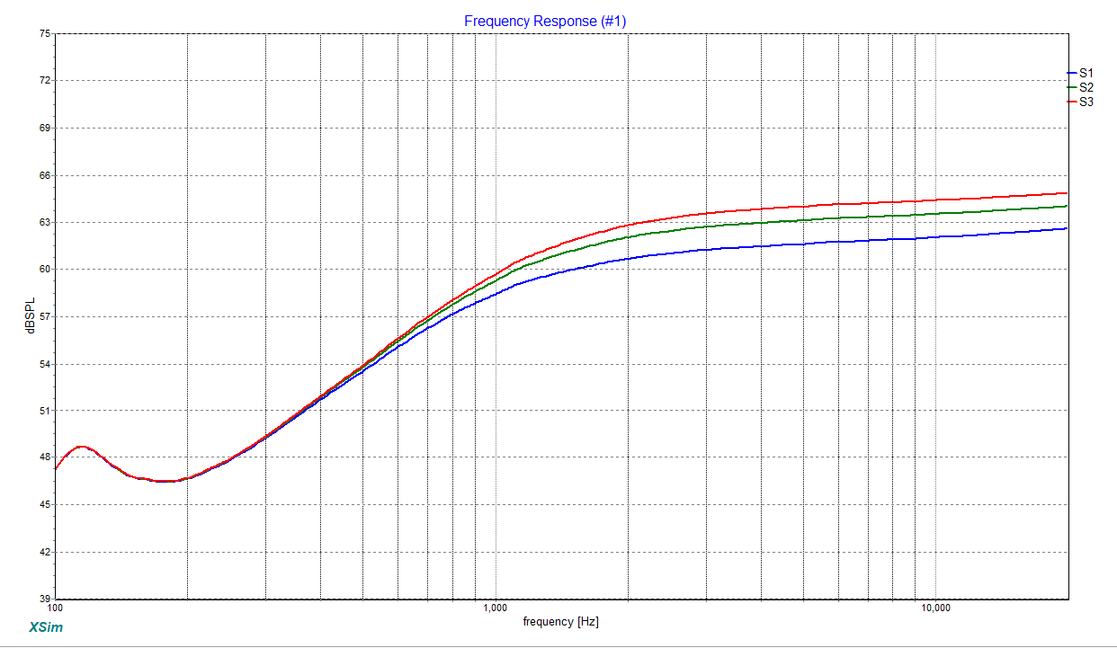

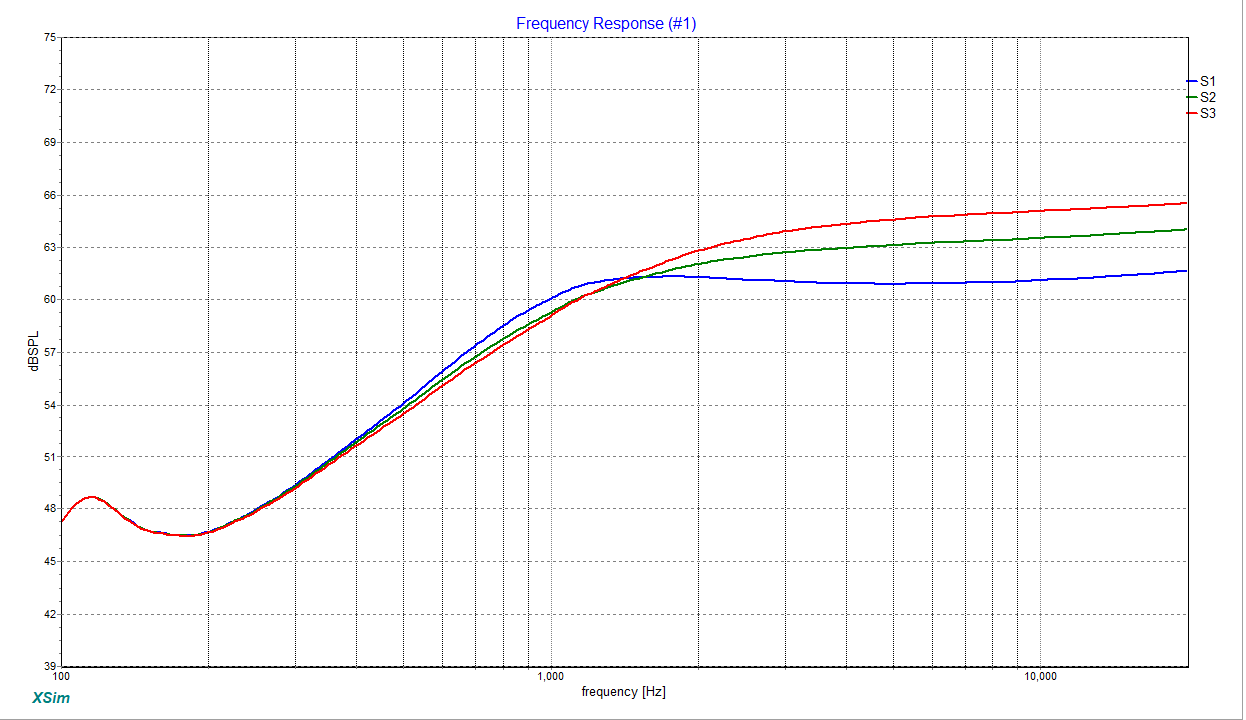

However changing R1 in this crossover doesn't change the crossover as much as one might think. See below a plot of R1 as 2.2R, 4.5R and 9R. You can see that the attenuation but the crossover point doesn't shift by much. That's because (I think) of the shelf filter of R2 L2

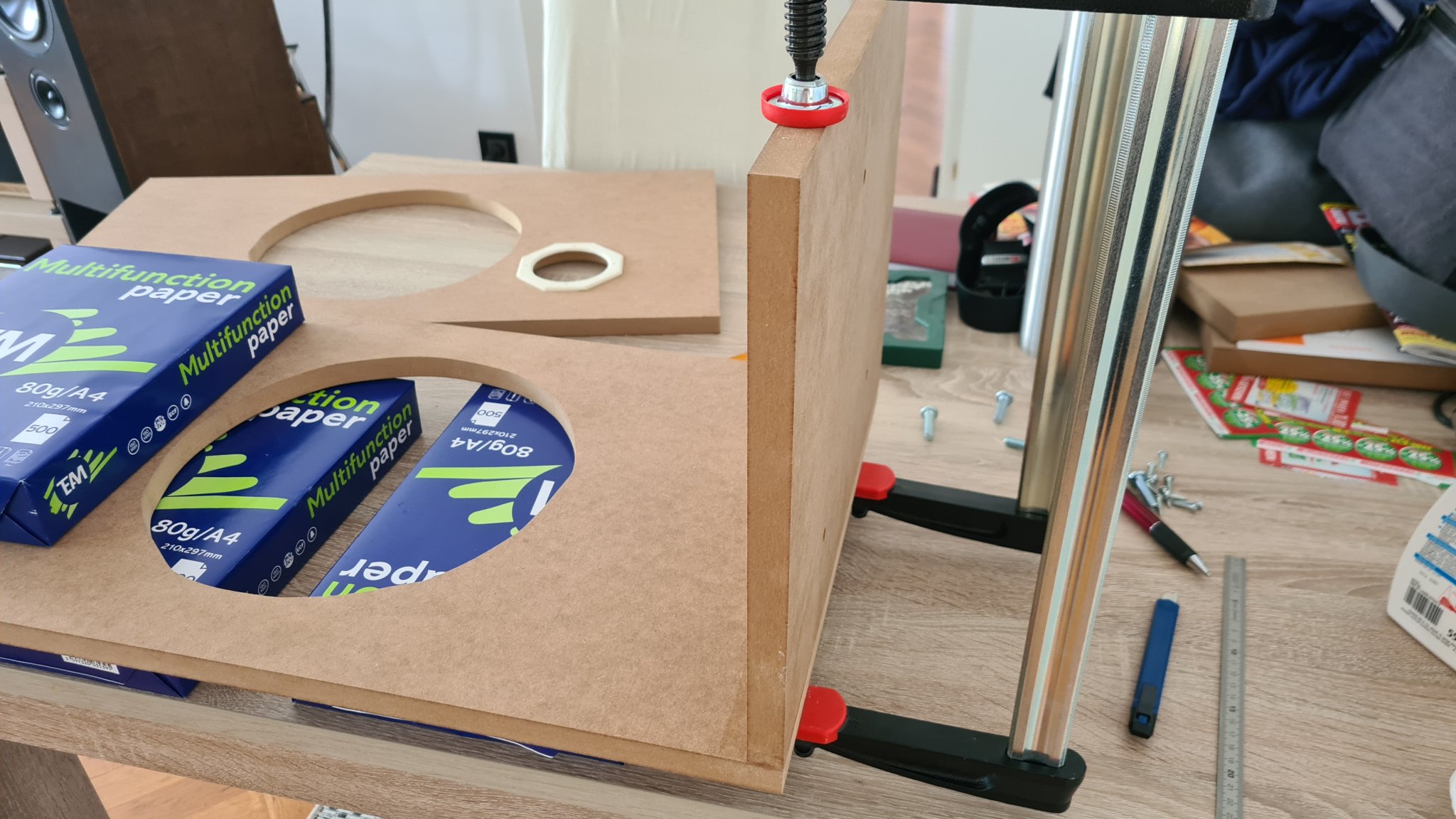

I was busy finishing another project (Iron Pumpkin pre), but now: the Manzanita
MDF, wood for the wings and thin ply for the sub-baffle are here, the xo-parts will arrive next week.

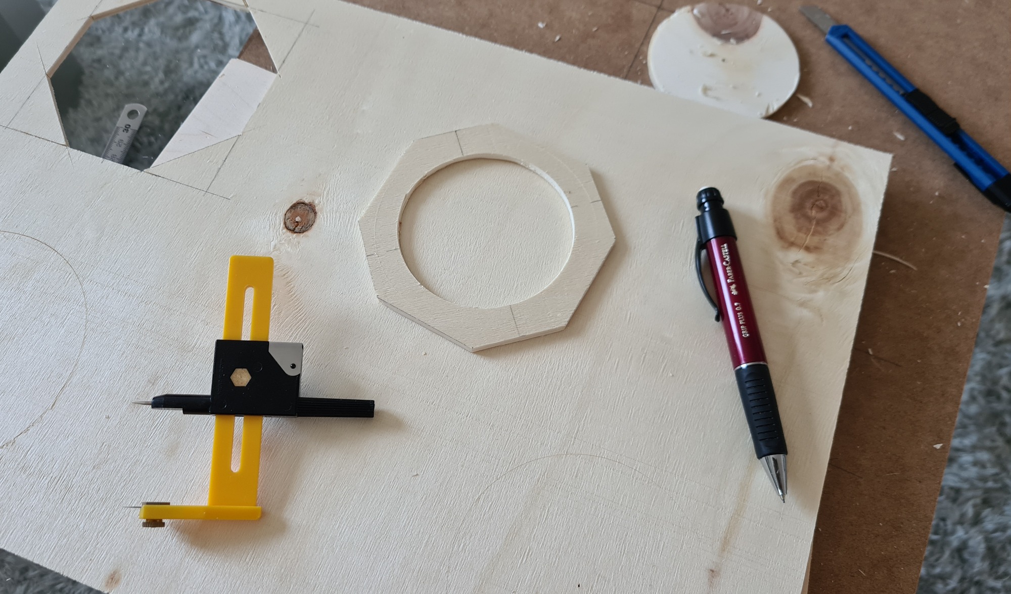

As I wrote, I will mount the TC9 into a sub-baffle; I have a router but a) I have absolutely no experience with it and b) no place to use it and Mrs. Plott wouldn't be amused when I make my trials in the living room
I will cut the holes with a jigsaw (much less dirt).

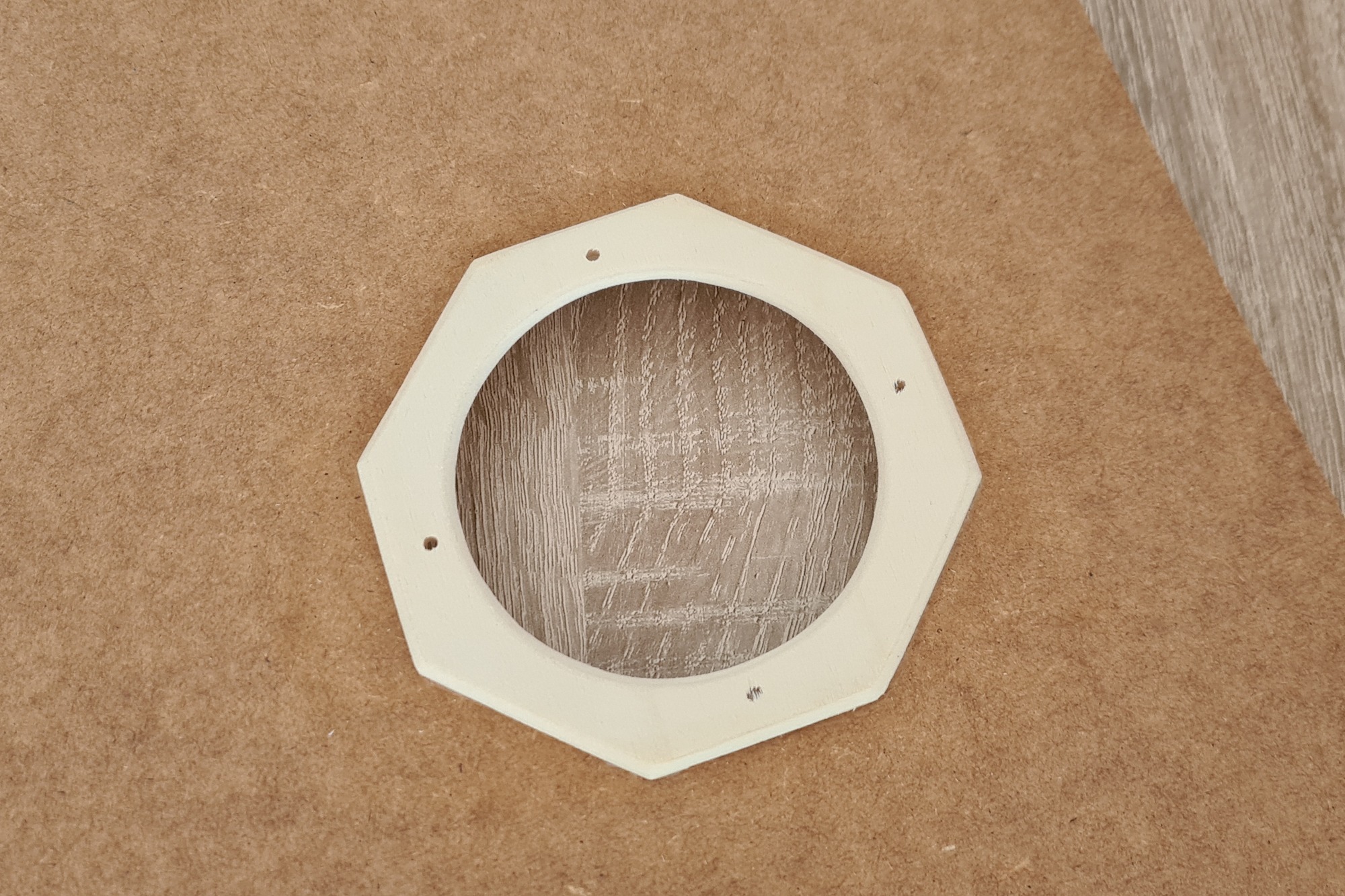

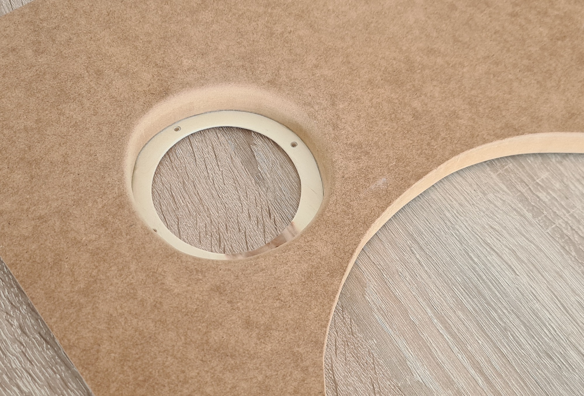

Now I prepared the sub-baffle for the TC9 (I will sand the edges in 45°), but I don't know (I can't decide), should I mount it from the back or from the front. It has a seal on the front which implies that mounting should be done on the back of the baffle. So it would be in line with the woofer again, and time alignment would no longer be a problem. If mounted from the front (on the baffle) the TC9 would be about 4mm further forward.
I kindly ask you for some hints

Looks like some nice cuts. You did those with a jigsaw?
If your sub-baffle material is thin then you can mount the Vifa onto the back of the sub-baffle. Then mount the sub-baffle flush with the front face of your main baffle. It's best if you can smooth the edges of the cutout for the Vifa.

Hi Pano,
many thanks. That's exactly what i did; my sub-baffle is - after some sanding down - only 3 mm thin, so the TC9 will be mounted from the back. This cutout was made with a circle cutter, the straight cuts with a scalpel along a metal ruler. It takes only a few minutes, because of the thin material.
For the cutouts in the front I used a jigsaw and then I smoothed/sanded the holes with P80 sandpaper. The hole for the TC9 is heavily rounded, so there are no sharp edges, and hope there will be no "screaming".

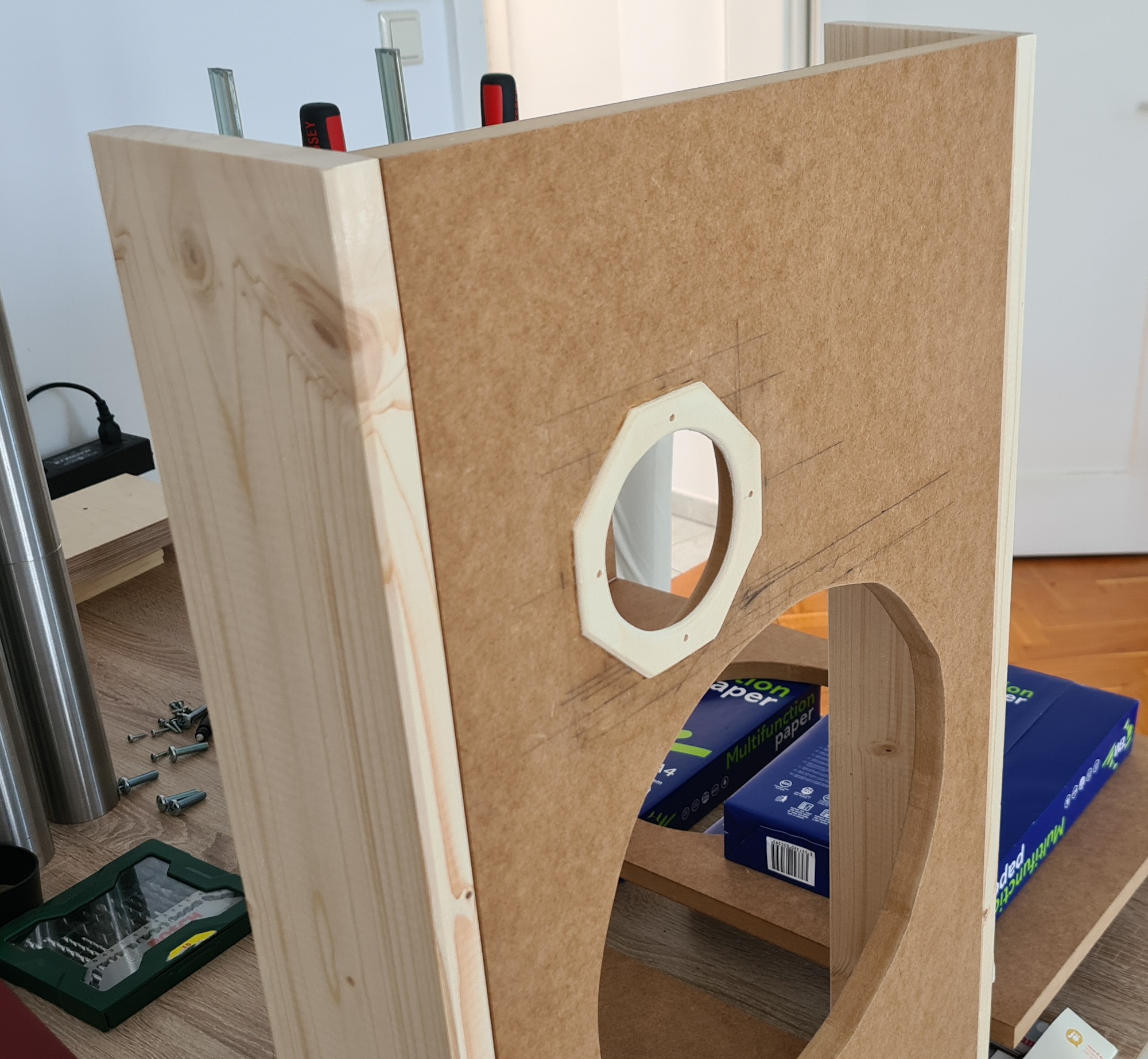

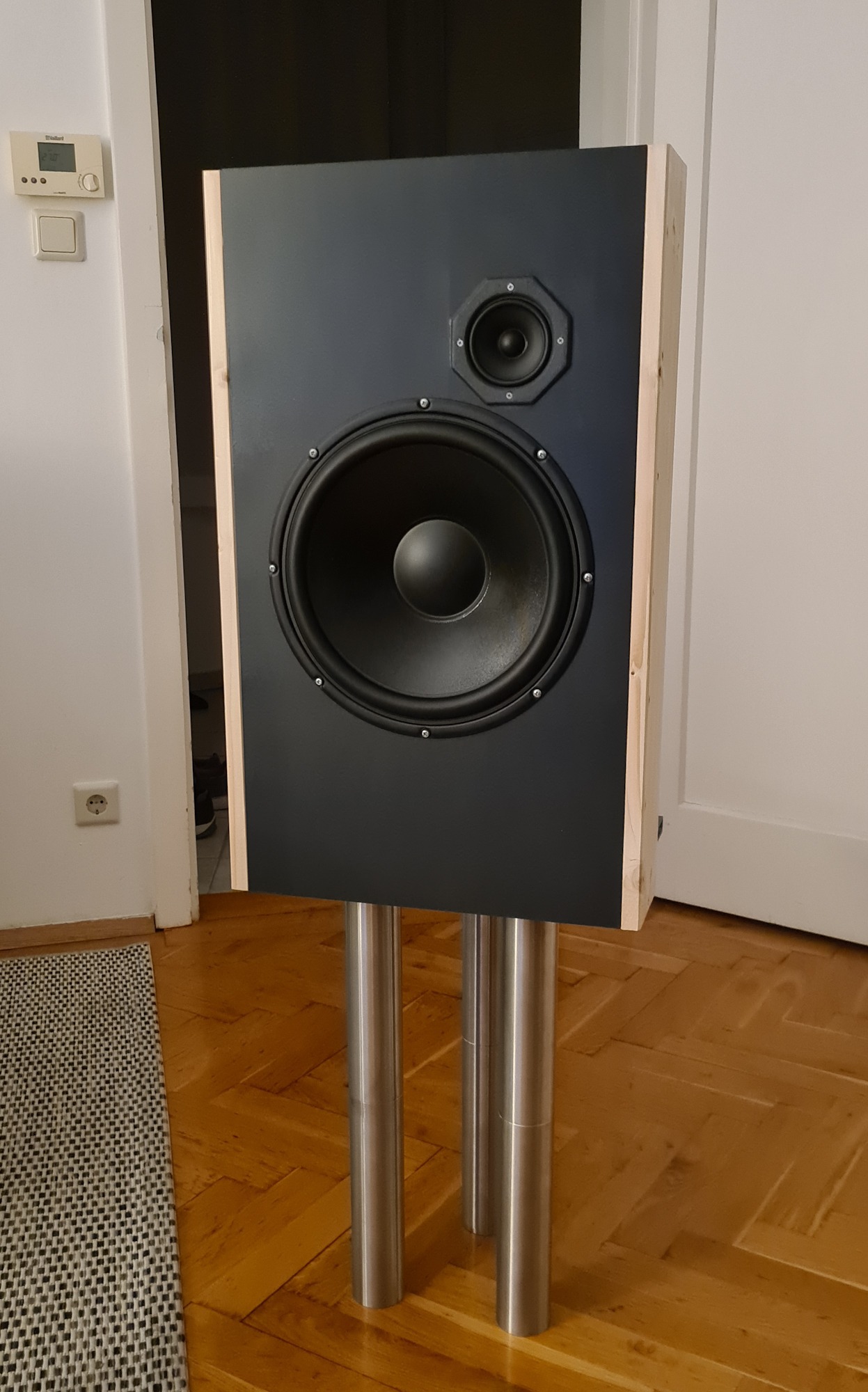

Now, some gluing in progress, sub-baffle already mounted Yes, it is really a fast and fun project

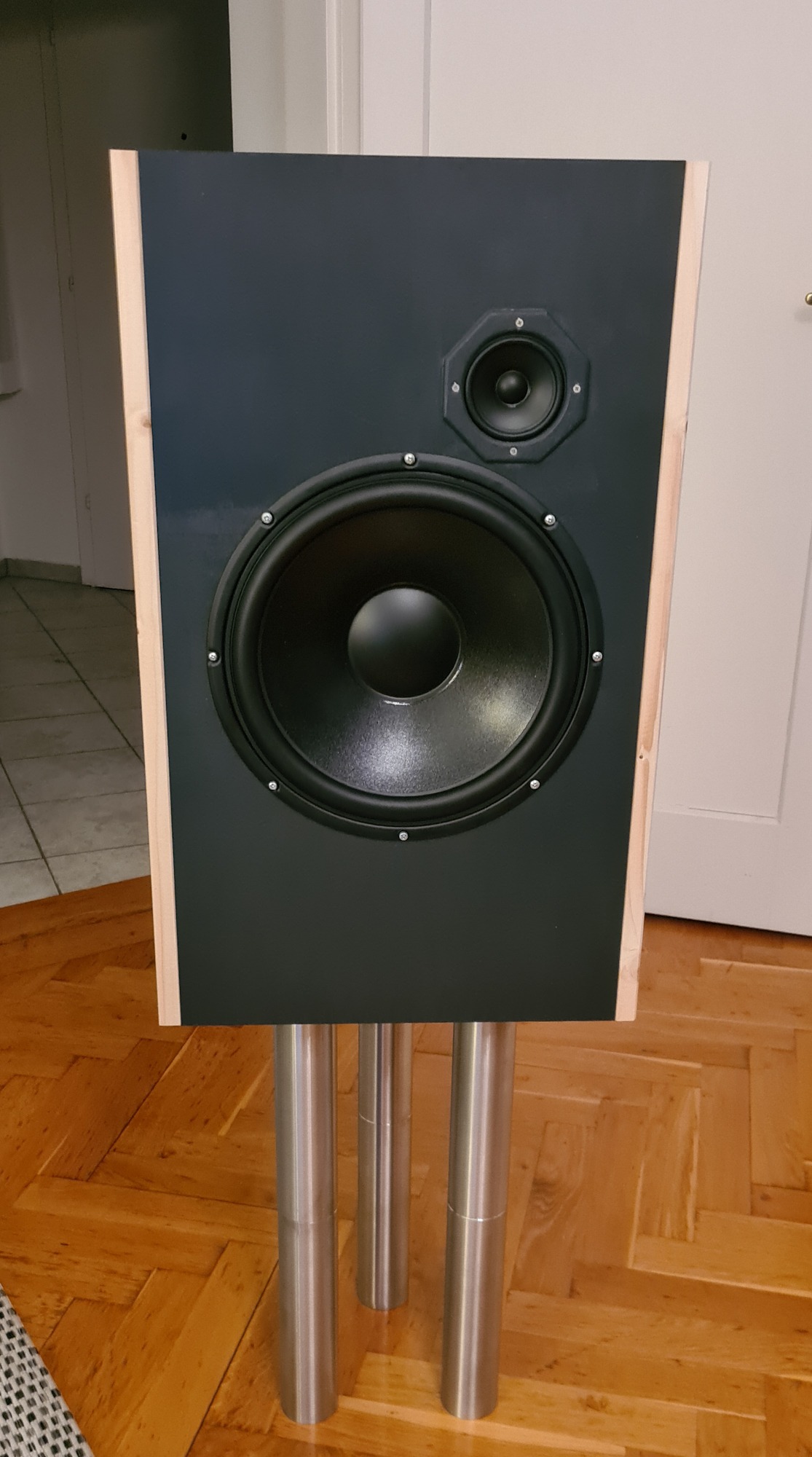

Some progress
The baffle was painted with an acrylic paint, the wings with acrylic gloss clear.
The legs are parts of my old (first) diy audio rack.
The parts of the xo will come in two days or so, but I think I can't finish it this week, lot to do... will see

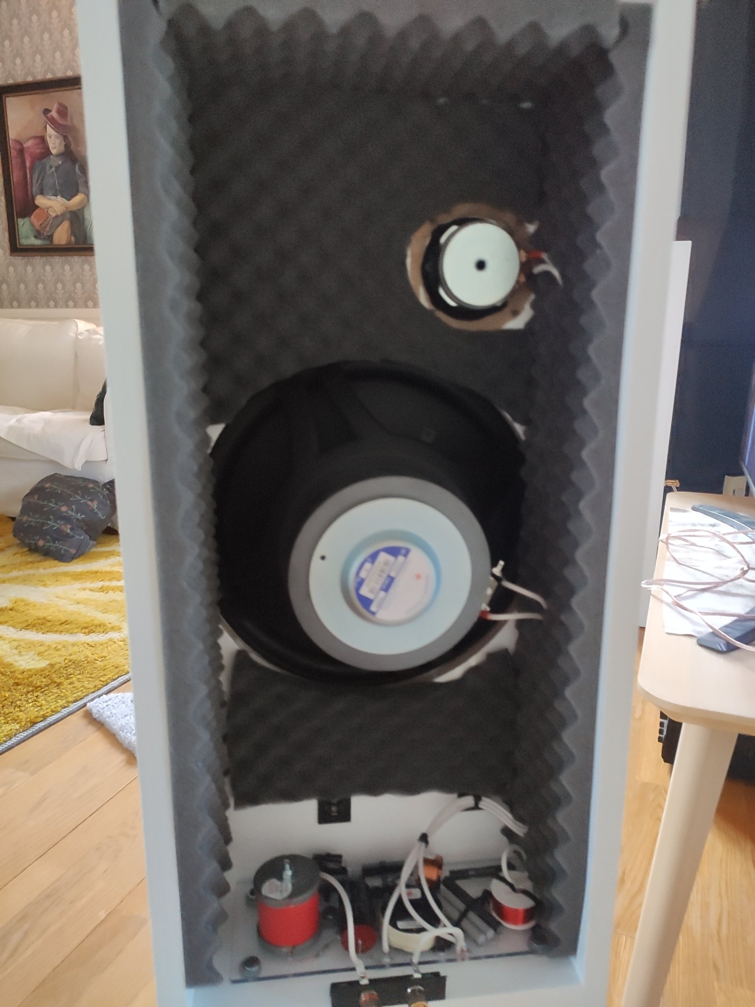

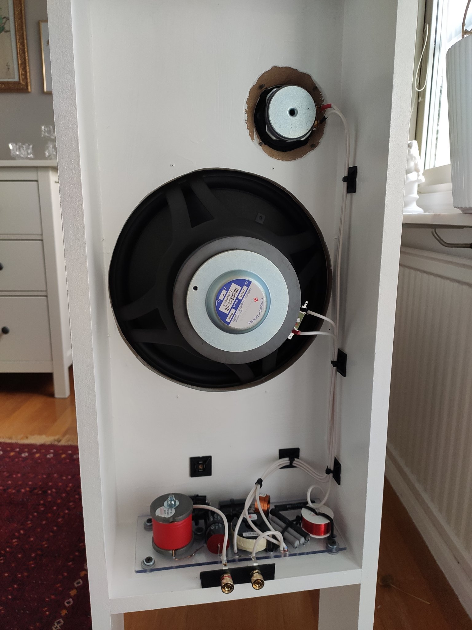

After some fiddling around, I tried different crossover settings, adjusted the crossover point up a bit, and no big revelations came to surface. So I decided that the design had to be finished and more fiddling is due to later, If I want. So for now, I am building them to be finished. When I see the original designs, I think that I may be suffering from a bit of cavity issues since the TC9 is closer to the side wing than original. I will put damping inside my speakers to at least reduce this, so mor pict to be added later. This is how they look now..
Thank you all
@nouvolare, I particularly like your xo on glass (acryl?), very cool 😎
It is a regular polycarbonate glass 😊 Unfortunatelly, it will not be visible when I am finished. I intend to use black front cover fabric at the rear as well to protect it from prying child fingers and other...Thank you all
