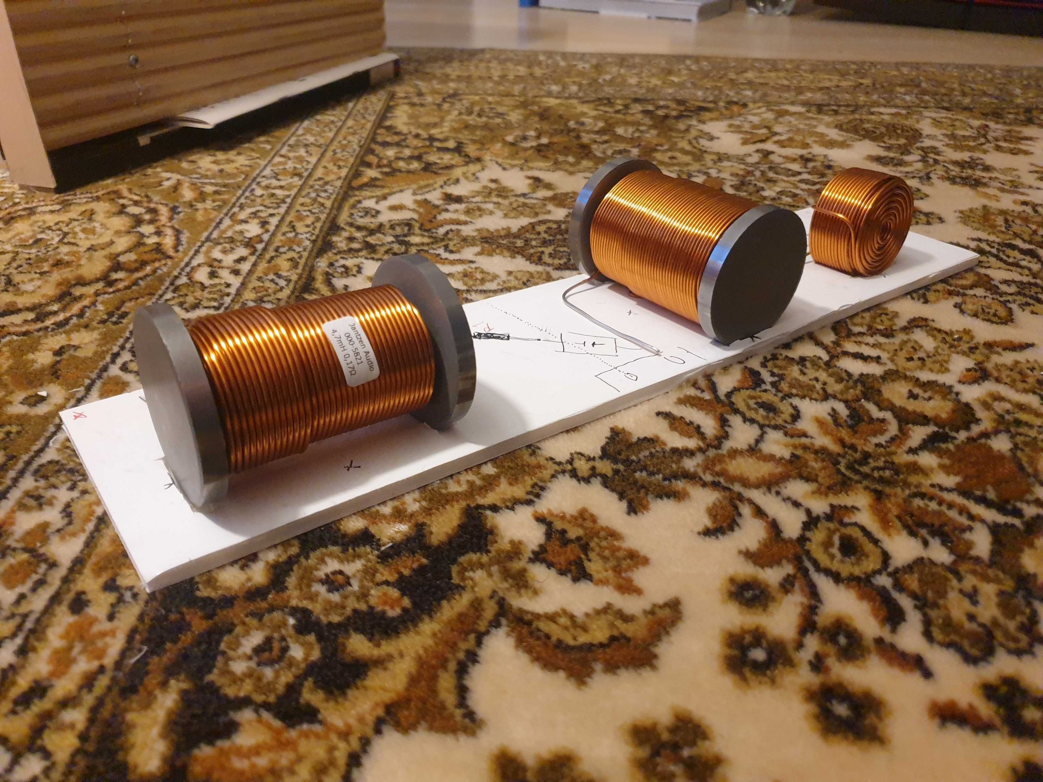

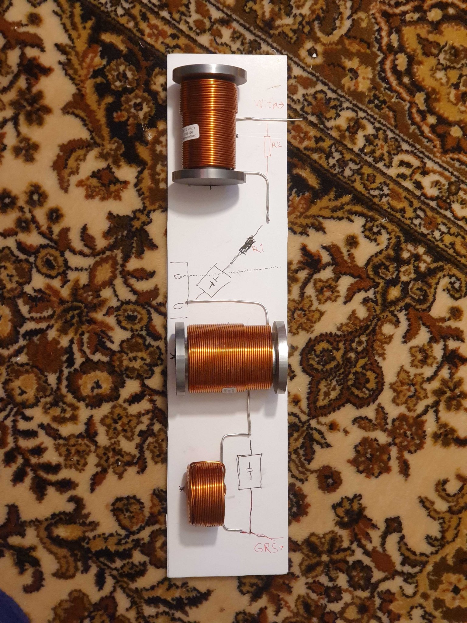

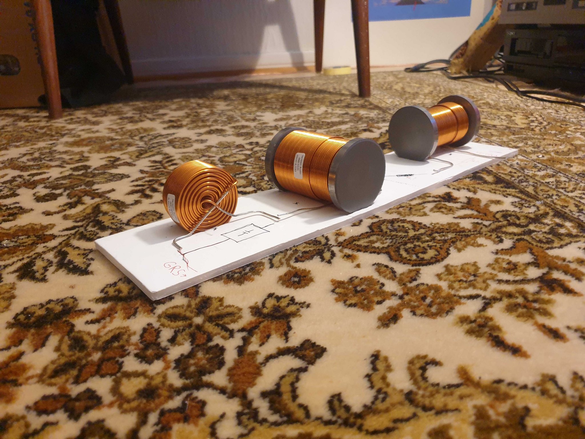

Update on the Ugl-o-nitas:
Inductors have arrived! (and boy are they heavy...)
If the rest of the build is bound to be a bit on the Ugly side the same won't hopefully be true for the xo-section.
Eagerly waiting for the rest of the parts to get these beauties going
and please do mention if I've gotten anything wrong about the wiring...

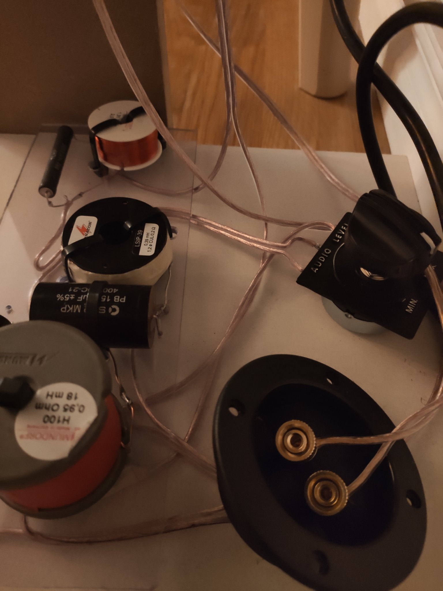

Allright, on again with it. Assembled the elements after paint, it turned out nice, I must say. Fiddled around with the crossover and tried to improve things. Connected my Lpads instead of the R2 resistor. Unfortunatelly, they only managed to have a max of 8 Ohms, so I could only adjust them to be louder, and it was quite little difference between 8 or 4 Ohms. At 4 Ohm, it was more "alive" on moderate levels, but too much on voices or electric guitars at higher levels. For me, that is critical. I must be able to play on high levels without the vocals turn nasty on your ears. Can I do that without the music sounds dull on lower levels, It is allright. I will connect the L-pads in series with the R2 and see where I find the right level, being able to acheive 16 Ohms at the extreme end.
After that, I returned to adjust R1 and revised my earlier statement of 5.1-5.2 Ohms and landed on a 5.4 Ohm where I could play loud without the vocals get screamy.
So, give it a last test with the L-pads in series with R2 and after that, I'll clean up the crossover components and solderings for install in the cabinets.

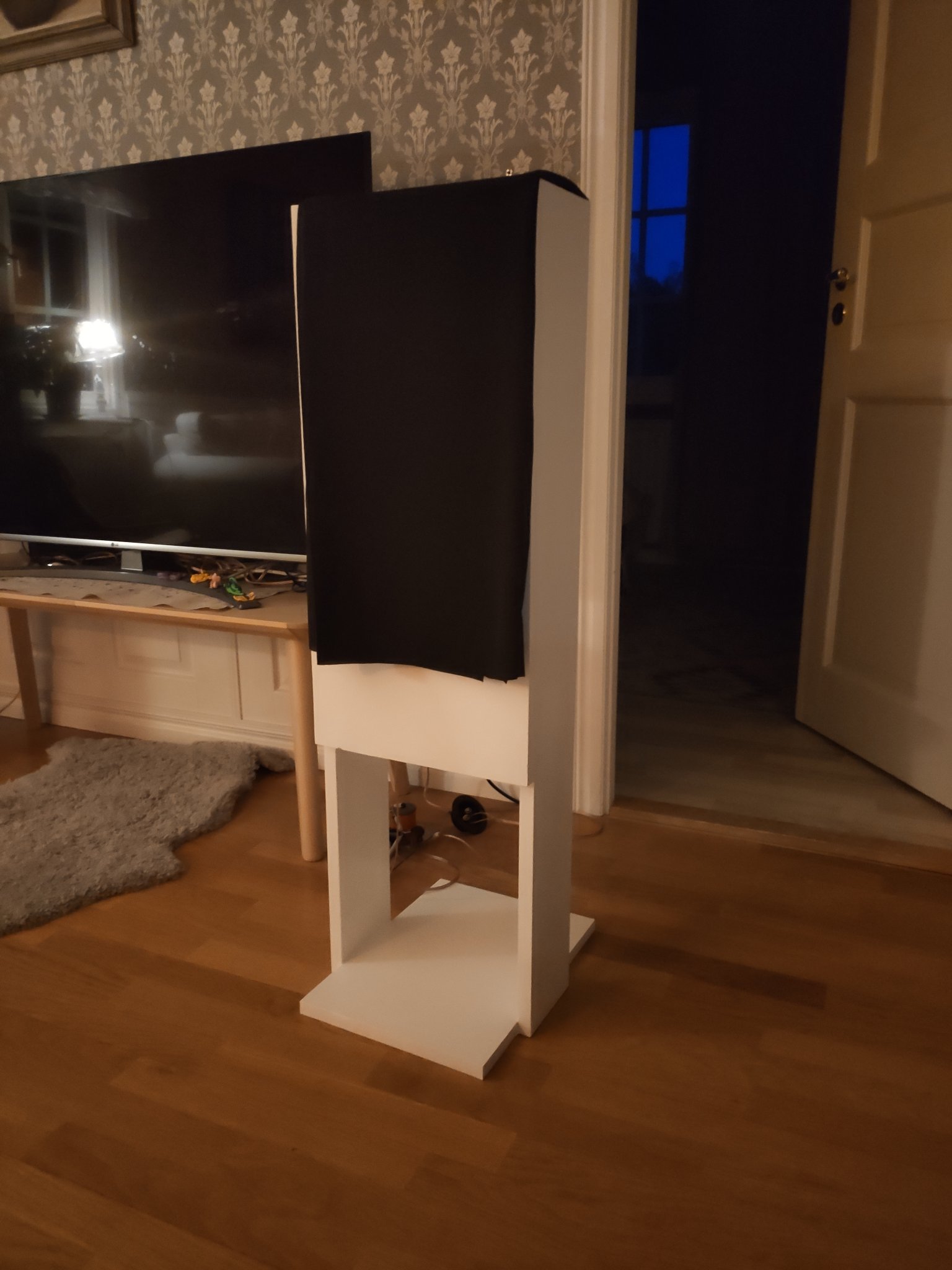

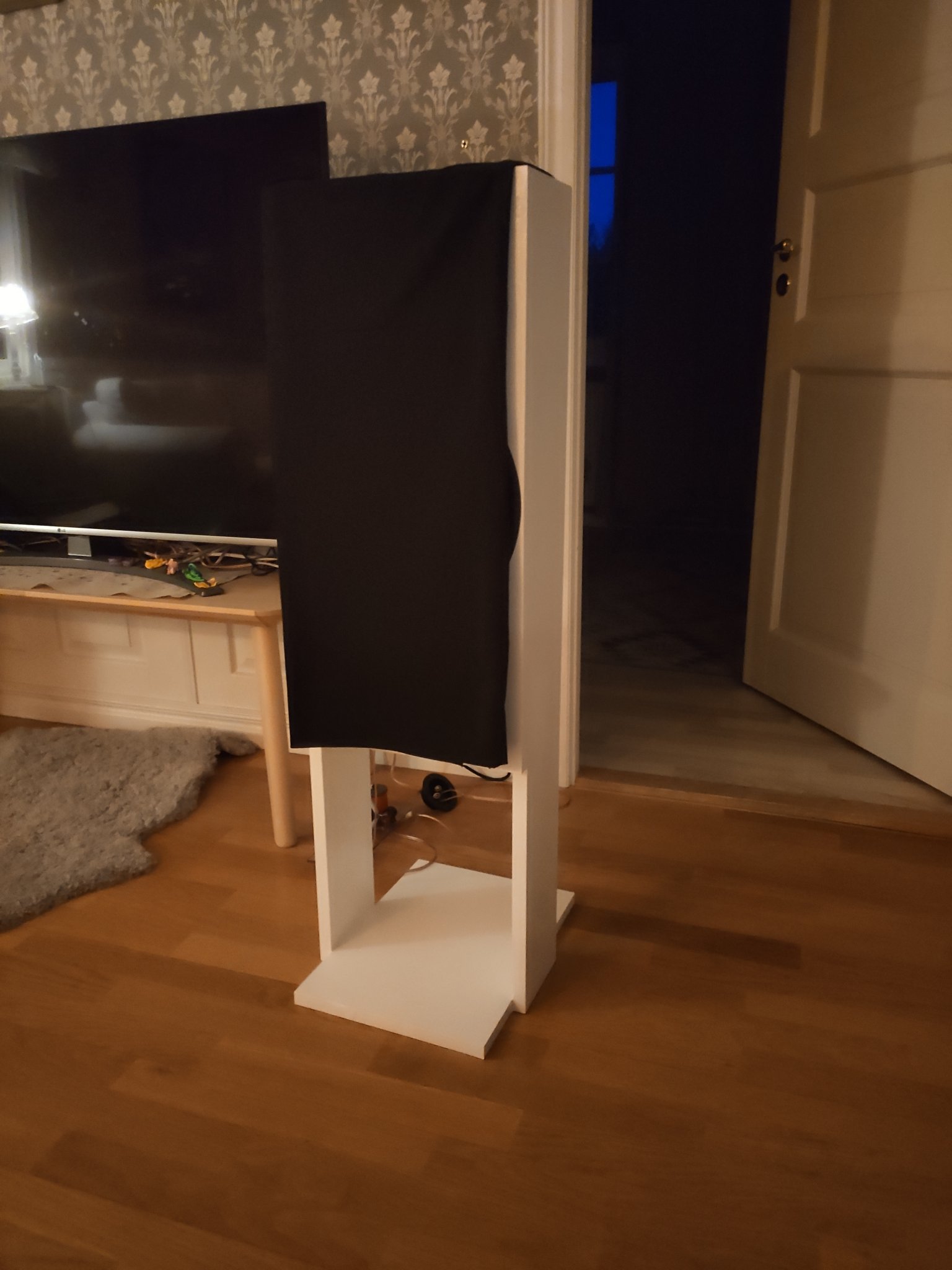

How low down shall I make the front covers?
Like this:
Or this?
/Arne
The higher one. 🙂
For your L-Pad, how are you wiring it? If it's a classic constant impedance L-pad then you need to connect between only two terminals. Usually there will be a side that gives you 16 ohms, sometimes 32. Do you have a photo?
I started by connecting them the classic way, but ended up like a variable resistor. Measured them to 8 ohms max. But I did not measure the other terminal.....
That said, I must say, and it might depend on their low quality, they degrade the music, making it sound more raw and harsh. Exchanging it for a resistor with the same value cleans up the music quite a bit...

OK, good, Check the other side of the L-Pad, it might be a higher value.. And yes, not all of them are great, some can be very scratchy.
Your baffle is narrow, so you may need to tweak a good bit. Also experiment with opening and closing the door behind the speaker.
While you are experimenting, try the L-Pad in place of R1. That will have a different effect.

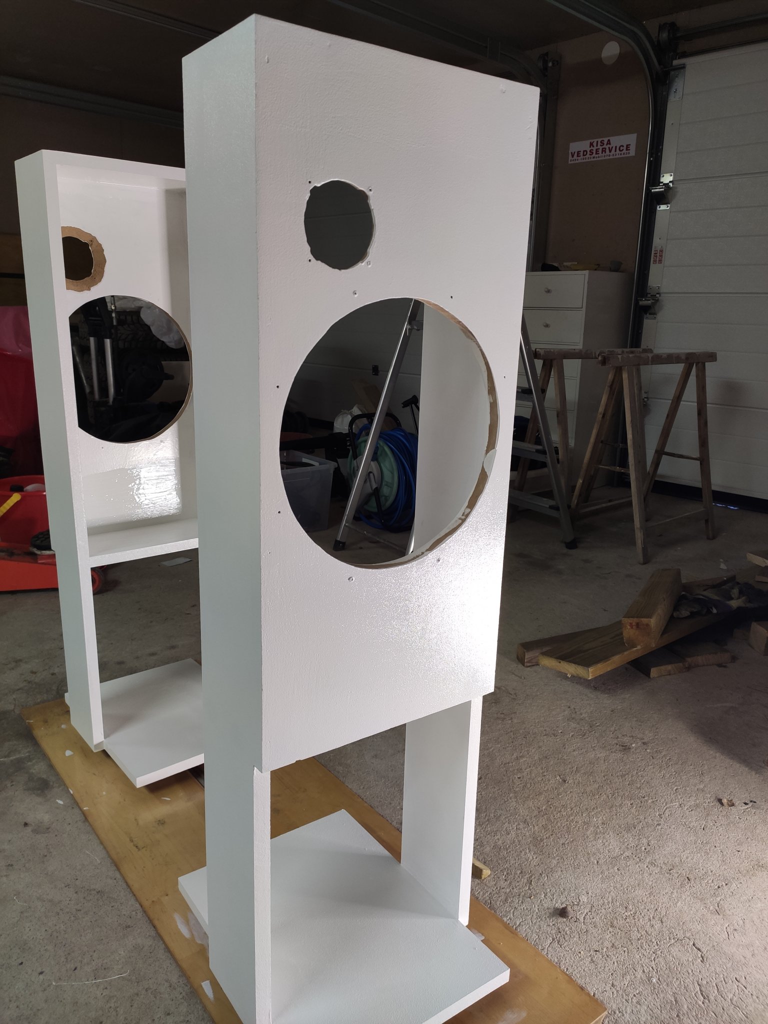

Is it a good idea to glue 20mm foam at the back of the cabinets around the elements?
I have not tried foam, maybe someone else here has. I worry a little about your frame around the back of the baffle, it looks like you might catch a few resonances in there. Try a think foam piece under the top brace. See if you can kill and reflections or resonances that it might cause. And continue to tune the crossover, a number of builders found that the sound popped into place once they got the crossover adjusted to their room.
