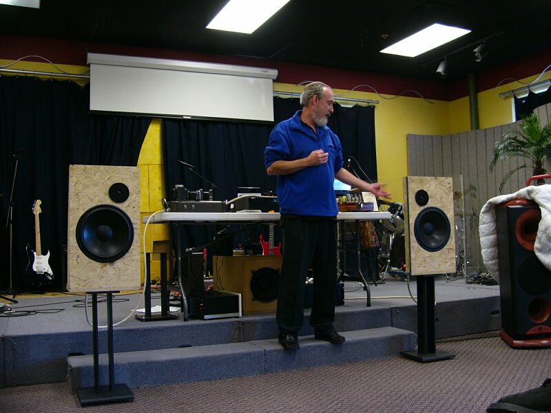

What's been missed in all of this (and I apologize) is that the small Manzie is made to sit on a speaker stand. Sitting on the stand the speaker is well up at listening height.I'm planning to build the Manzanita and am wondering if it makes any sense to build it taller and move the drivers up higher. Plans call for the center of the SLS woofer to be 13" above the floor and the center of the Vifa full range to be at 22.5".
You could build wings that go all the way to the floor instead of speaker stands, leaving an open space. That's been discussed a few times somewhere in the thread. Of course you can go all the way to the floor with the baffle, but that is going to change the woofer response and require some crossover tweaks.
My suggestion would be to make the lower baffle removable. That way you can test the speaker as designed (in the air) and with the baffle to the floor.
Who's the ugly guy with the beard?
Time to add a few design comments.... Most and or all of what I am going to add here has been discussed before. During early Manzanita baffle design experiments, crude measurements along with extensive listening sessions indicated a couple of things that needed addressed. Floor reflection(s) was one of them. Initially started out with a floor standing, 40" tall x 14" wide baffle. No wings. Woofer close to the floor. Tweeter about 34" off the floor to get it close to ear level for a seated listener. Once I flattened the bass output with zobel and large inductor the bass at a 8-10' listening distance was a bit weak and quite lumpy. Notice when I measured again with the baffle 24" or so off the floor, the lumps smoothed out quite a bit. Played with card board wings of various shapes and depths trying to obtain more bass extension with out adding cavity resonances.
In keeping with KISS, wanted the baffle to be as small and light-weight as possible. Easy to fabricate from inexpensive, readily available low cost materials. So evolved the stand mounted original Manzanita. The revised design target morphed into building a speaker that was roughly the size of the larger bookshelf offerings of the 60's- mid 80's. The mid - tweet upgrade to the Vifa TC9 3.5" full range completed that goal. Large woofer two way not that much larger than say the original Large Advent in terms of baffle dimensions. Bass extension and efficiency are similar when both are operated on a stand and out a way from a rear wall where both designs offer the best tonal balance.
One more thing.... the larger Ultra woofer location is more or less the same in terms of height above the floor. So you can do a floor mounted version, but floor bounce will be a bit more than the stand mounted version. And the woofer will be a bit more efficient, so the tweeter pad resistor is an ohm or two lower for most listener tastes. The high pass cap may need to be trimmed a bit too in order to retain the intended crossover point.
