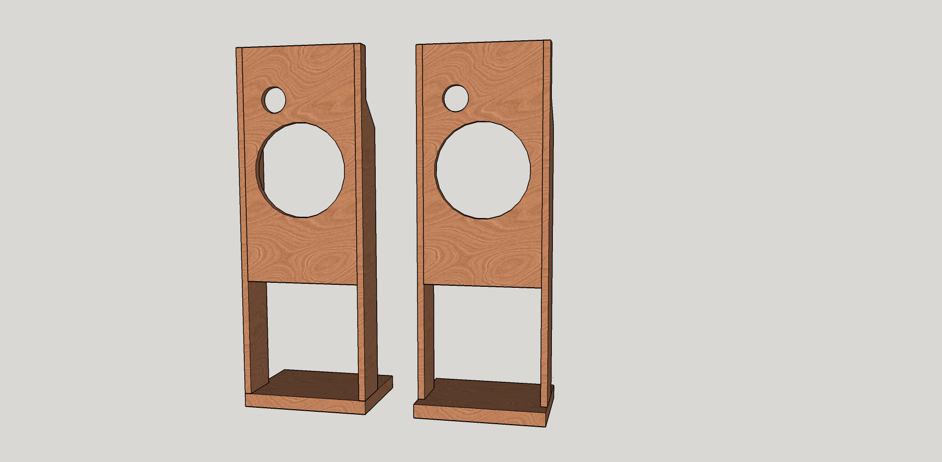

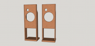

Pano, John,
Thank you both for the clarifications. You've confirmed what I have been planning to do all along. That is to build a combination stand/wings to raise the baffle up to listening height.
Here is a SketchUp drawing of the design. The only difference between the two views is an extension of the base forward in one version to increase stability. I don't think that will make any acoustic difference.

Save the image to your computer, then use the attach dialog here to upload and attach it.
How to attach images to your posts.
So just to be sure about some of the things that have been discussed.
These configurations with the open area below the baffle will work fine with the crossover that was been presented back in Post #1601. The only component that might need adjusting is the attenuation resistor R1 to better match the room.
Does that sound about right?

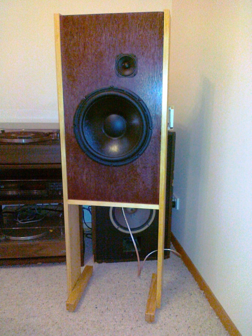

OK, time to take a survey of the many who watch this thread... Have a larger cost effective Manzanita inspired speaker with the following advantages and disadvantages:
Advantages:
Similar design goals of simplicity brought forward from from the original Manzanita. Bang for buck, easy to build with simple tools and use of common off the shelf materials and components.
4 db of added net efficiency. Solid 8 ohm easy to drive load.
Bass extension to 32 Hz.
Improved over all performance over the entire usable frequency range. (32-18.5K)
Off the shelf name brand drivers available nearly everywhere in the world.
Simple wood working skills to fabricate.
Simple fabrication and construction with basic wood working tools.
Higher power handling and way more acoustic output.
Disadvantages:
Larger system in terms of dimensions & weight.
Higher material costs... estimated at $280 - $300 each.
Floor standing configuration that requires a bit more floor space. Kind of an Ultra but with major upgrades.
Baffle dimensions are around 19" wide, 12" deep and 40" high. About 45 pounds net. Two way using an 18" and 4.5" (world class Neo).
10 element crossover.
Look forward to hearing back from all who care to reply. J

Update from Mr. Slow Man.....
Good morning all... Must apologize for the lack of progress on this project... Health and time issues have really slowed things down. (Ironically hearing - balance issues!) Covid hasn't helped either. (now over 70 and have to be careful) Have all the components and built a mock up - test baffle. Prototype crossover built. Some listening - auditioning and crossover tweaking. Next I need to modify a pair of finished Ultra floor standing baffles I have in storage and put it all together. Want to have a completed project for pictures. The original Manzanita took a year or so of off and on progress to get something worth sharing. J
