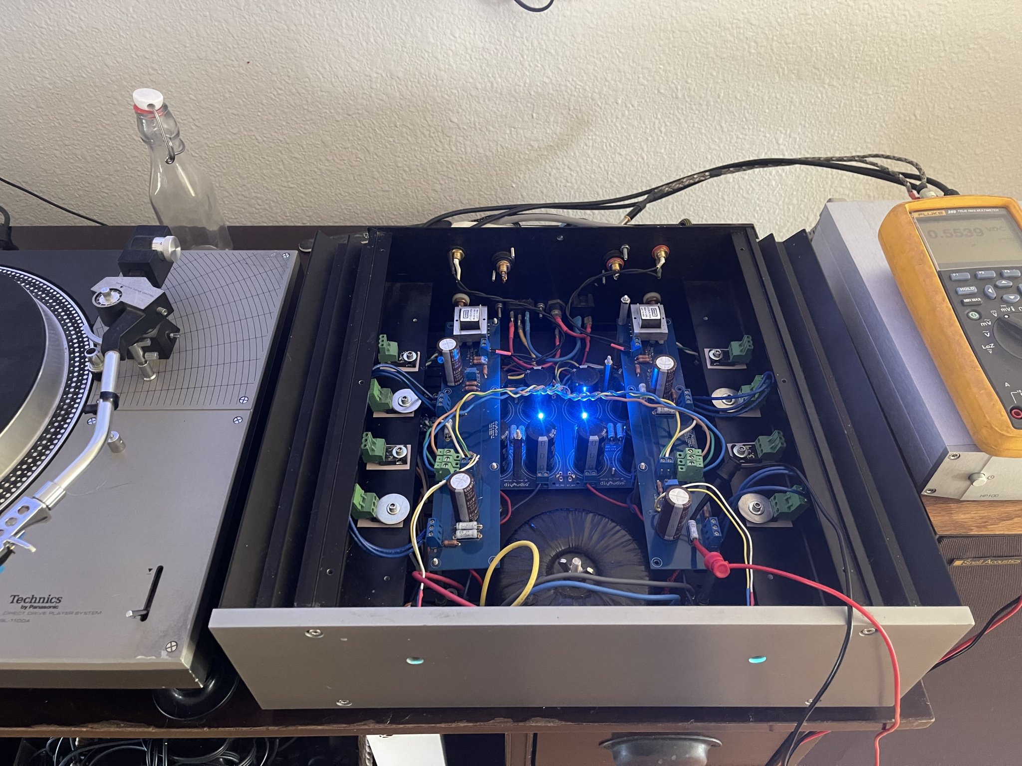

I wanted to see if anyone on here can help me trouble shoot my F6.
When I turn it on, I let it warm up for a half hour or so, then set the bias according the build guide like 6L6 said.
I set the bias around 530 on both channels then zero out DC and one channel seems absolutely locked in. The other has a bit of drift and is much harder to zero the offset on.
What is odd is this "drifty" channel will end up sounding quite congested and muted.... but when I put the pins of the test meter on the source resistor every now and then, the congested sound will disappear and it will open up and sound crystal clear and brilliant. Inevitably it will become congested again and I end up essentially tapping the source resistor with the test pins until I get the clear sound again. It's crazy making because I can hear just how amazing the amp wants to sound but only get to hear it like that for fleeting moments.
I reflowed the joint concerned it was the resistor connection but it made no difference. I took everything apart and reassembled it carefully and still have the same problem. Rather than wasting time with amateur troubleshooting, swapping out mosfets I figured maybe someone with better knowledge would have an idea. Why would it sound congested on one channel, be drifty in terms of bias and when connecting fluke meter to the source resistor would the congestion disappear temporarily?

I pulled the source resistor and replaced it with another .47 that tested closer to the actual value. The imbalance between the channels seems better but the channel is still drifty after an hour warming up. And the clarity still opens up every now and then when I have the test pins on the source resistor.

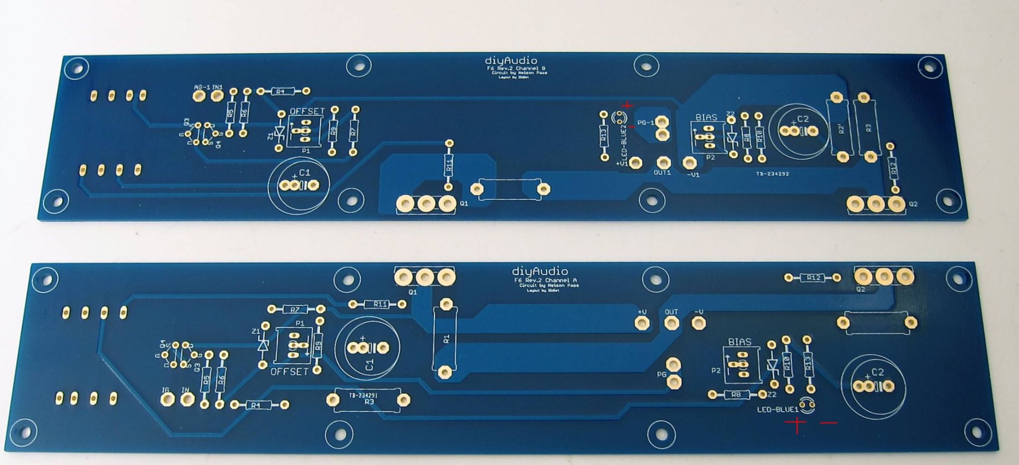

Also check capacitors C1 and C2 and their solder joints.
I am going to pull the board out since it was a nightmare pulling one resistor in place. While it is out I'll check caps.

Also novice thought looking at PCB vs. schematic,
I maxed out the Zener diodes at 9.1V (1N4739) based on forum recommendation. Is there any way this could be contributing to the drift/ bias issue?
Are you saying you are using 9.1V zeners for Z1 and Z2? What resistor values are you using for R7 and R8?
Yes. When I bought the boards and all my parts (this was a few years ago to be fair) in the original BOM it stated that the spec'd 5.1V diodes didn't provide sufficient voltage to bias properly so a number of builders had opted for 9.1V and no one had encountered any problems doing it that way.
I did not revise the resistor values for R7 & R8 they are 10K.
I am away from home during week but I'll test voltage across the diodes and report back this weekend.
THNX
I am definitely in the twiddly trim pot neighborhood.
I think I get it. The 10k resistor isn't providing enough current relative to 9.1v/5k
So I need to lower resistance (at R7 & R8 ) so it will give me more than 1.82ma.
In my layman terms I have zener diodes that aren't providing stable current for bias/ offset.

Just a follow up. Want to thank everyone for helping me. I checked voltage on zener it was erratic so changed resistor values and got 9.1V stable which enabled me to set stable bias but I still had channel imbalance and it sounded like there was a sock in the port or something. Pulled boards, and found culprit. The solder on electrolytic next to source resistor hadn't bonded to one leg, so it looked good but tapping on the cap, I could see the lead moving through the solder joint. When I was tapping the source resistor with my probes I was probably getting momentary connection of the cap giving the open clear sound I wanted. Interesting that adding/ deleting that one component was such a significant difference in the quality of the sound.
Anyway, all's well that ends well. The sound coming out of the amp is sublime. Working on chassis for my Nutube B1 preamp now.
