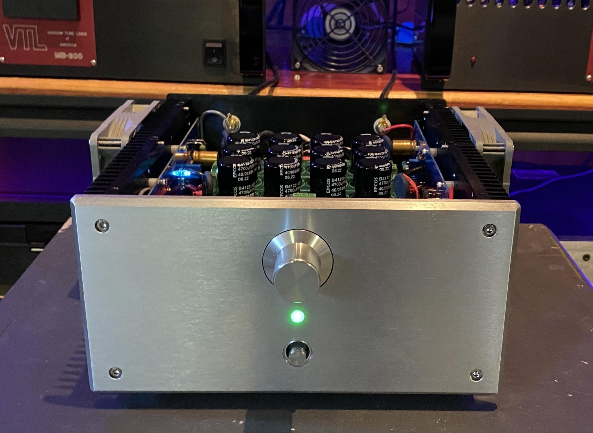

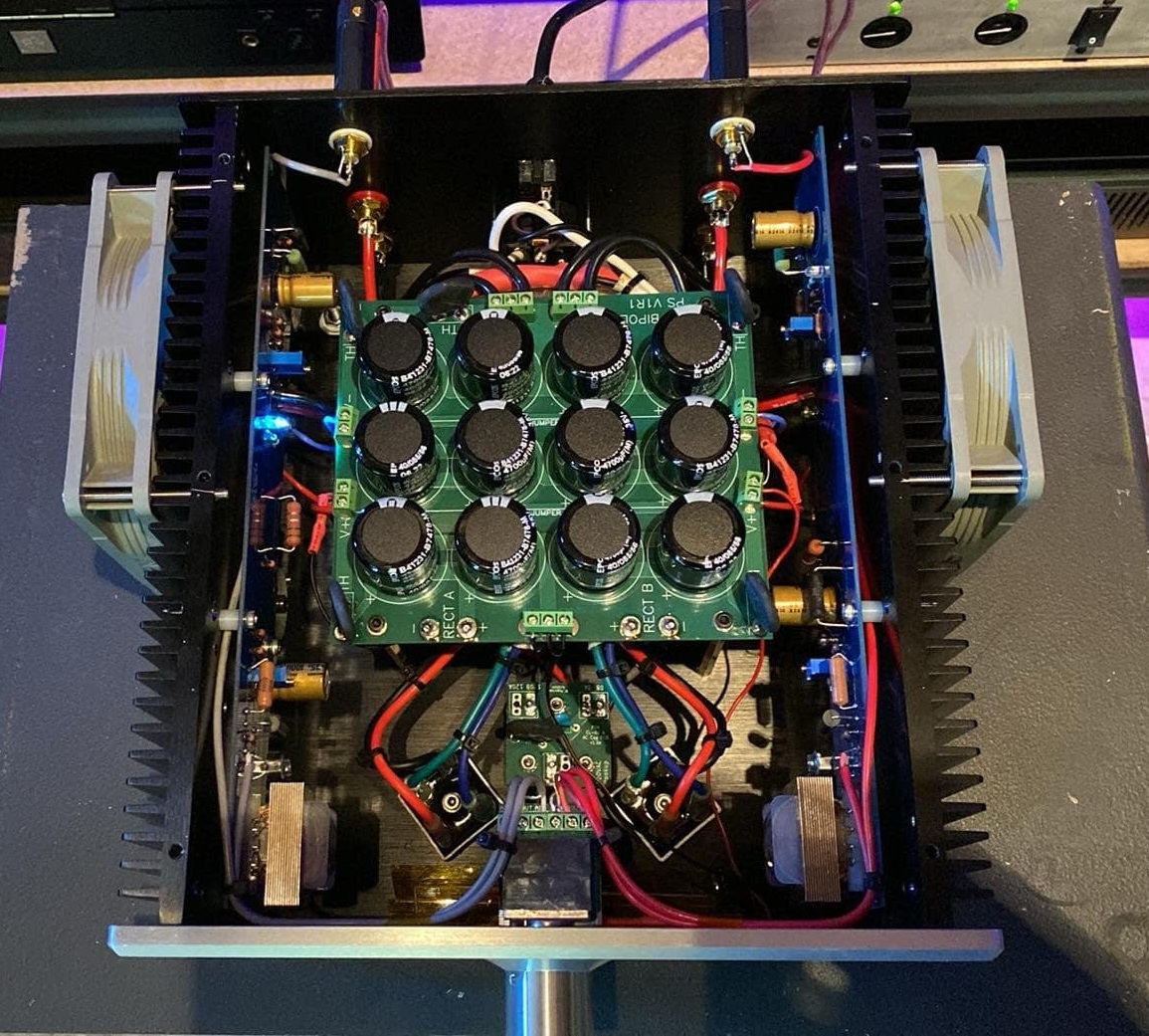

Ladies 'n gents, I present, Smolf6.
Conservatively biased at around 1A per side, the little heatsinks along with the Noctua fans seem to do a good job.
Also, I've used the Cinemag transformers that are supposed to be an "upgrade/replacement" for the Jensens. Not sure how much of an upgrade they actually are, but they seem to be working just fine! (RE-123FLPC)
