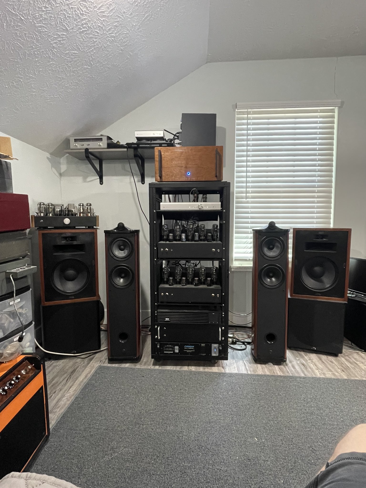

Another Aleph J has come to life today. Completely separate channels sans power cord. I’d like to thank Mr. Pass for this wonderful design. Also MZM, 6L6 and everyone else. Couldn’t have done it without you guys 🙂
