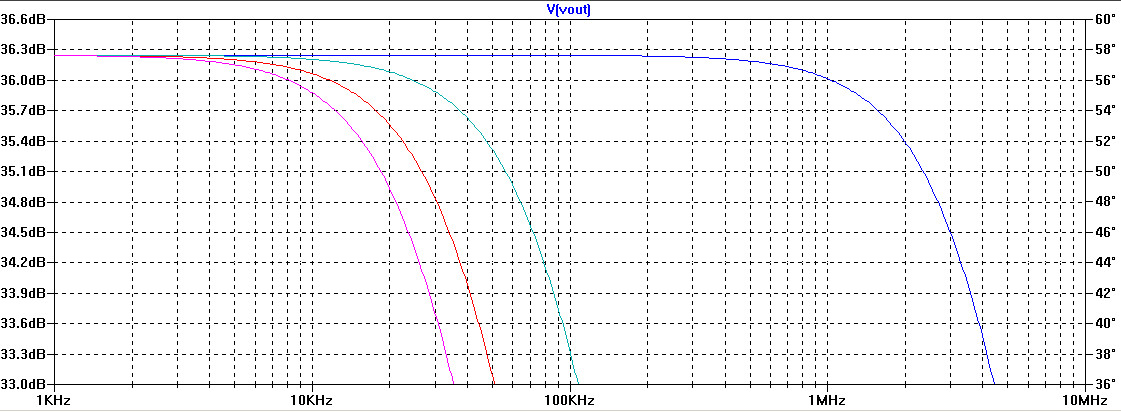

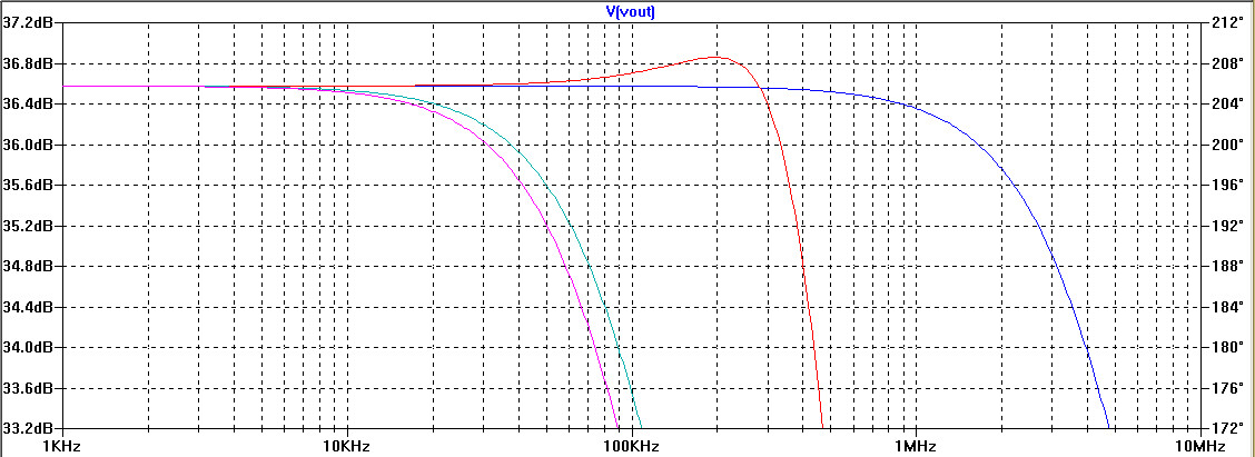

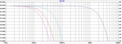

Here are two sets of the open-loop frequency response sweeps (using LTSpice) with different assumptions about FET and transformer capacitances. The two sets of sweeps are with(left) and without(right) cascoded outputs. The parameter Kc is multiplied by all FET capacitances. The parameter Ct is the transformer interwinding capacitance. The 4 sweeps are:
Kc Ct
1 18nF violet "normal" caps
1 0nF orange only FET caps
0 18nF cyan only transformer caps
0 0nF blue no caps
With cascoding, the effect due to FET capacitances is greatly reduced and transformer capacitances dominate. Without cascoding, the we see the exact opposite - FET caps dominate.

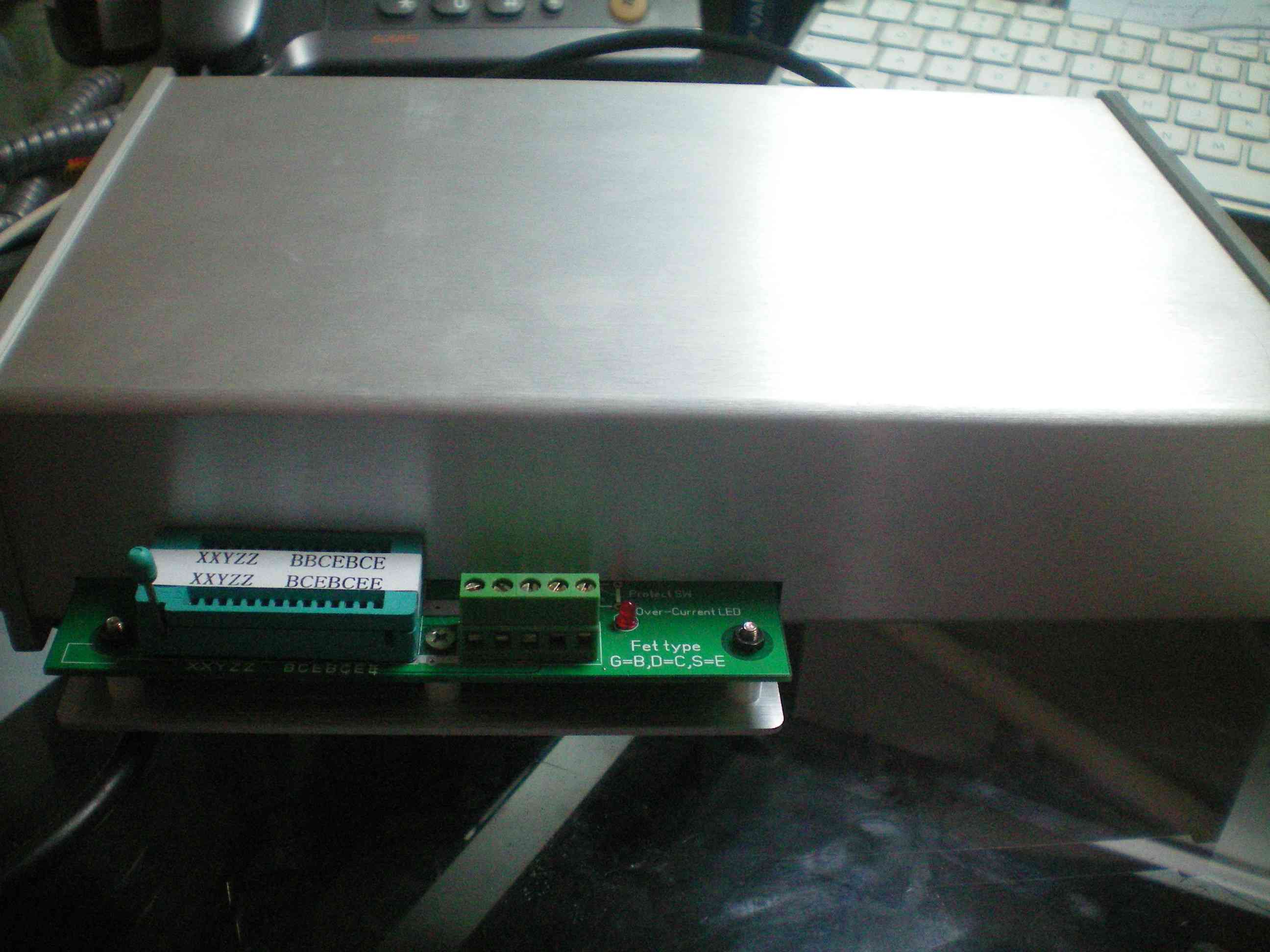

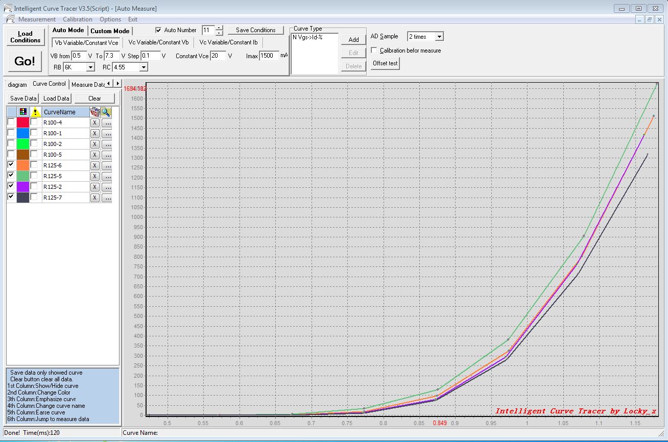

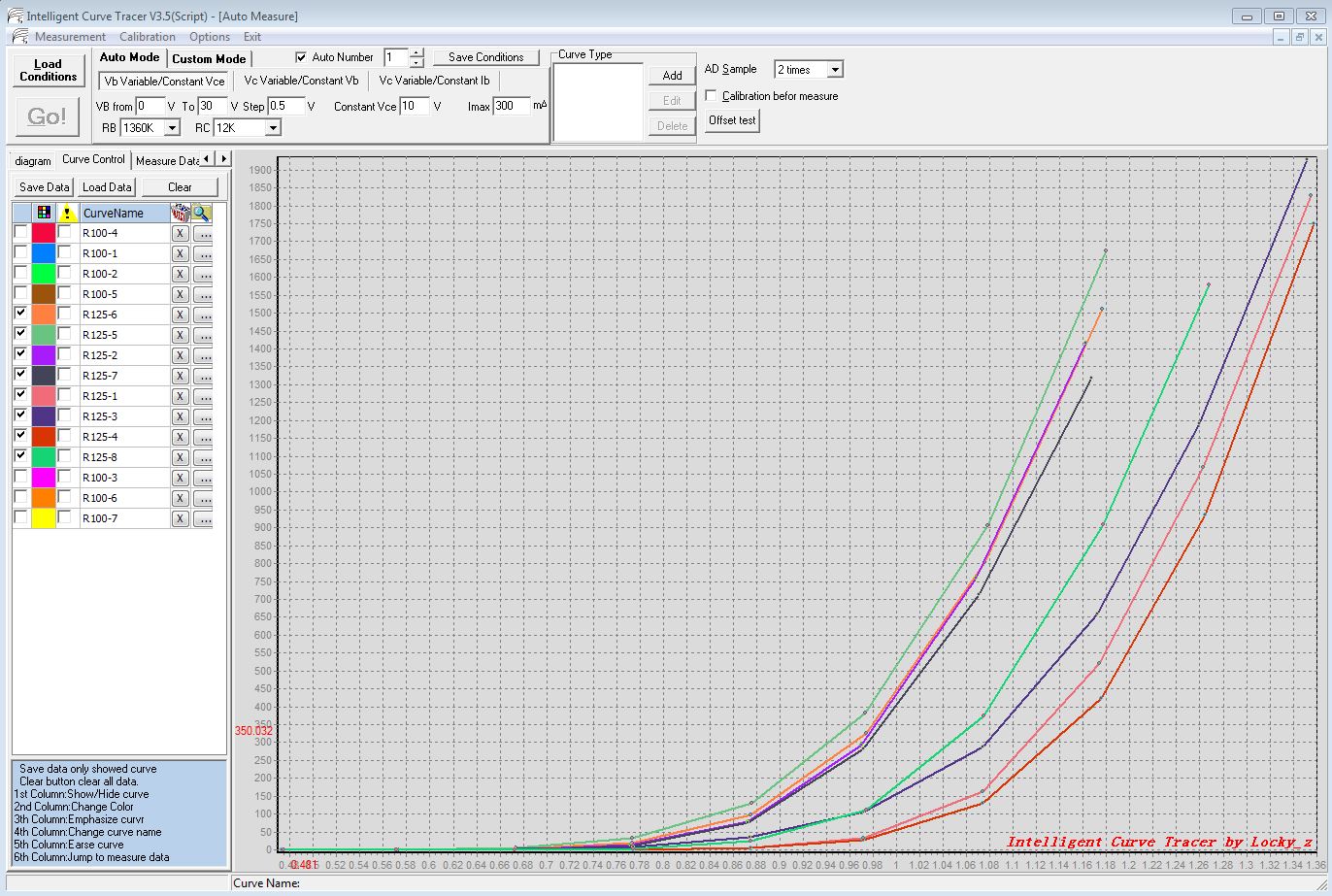

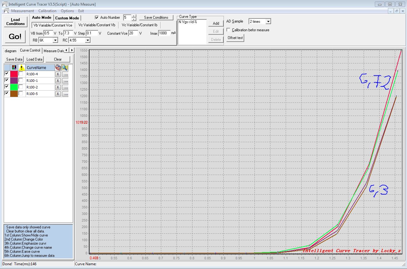

I got the curve tracer from locky-z here on the forum yesterday and played with it to cure my Semisouth problem...
here you see all my fund 8x R100 and 8x R125....
x-axis the Vgs, y axis Id
As you see they are all fairly different...at the first glance you can not separate R100 and R125....
(continued)

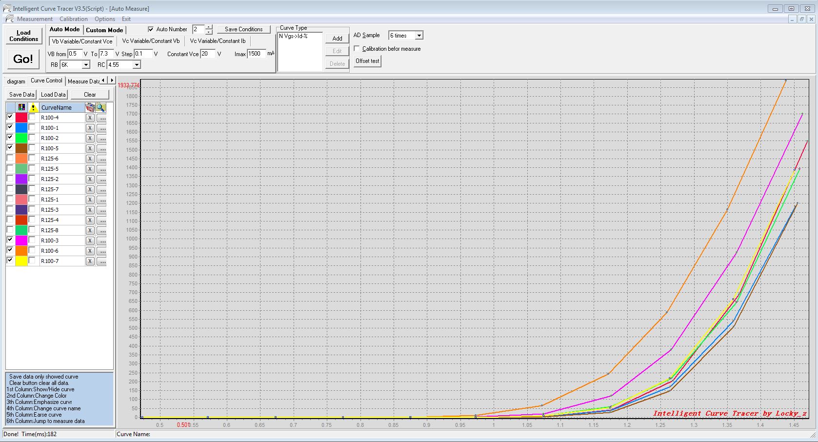

the next two pictures show
left the R125
right the R100
there are the known differences
- R125 a bit lower Vgs and maybe a bit more transconductance......
- R100 higher Vgs and ................😀
(continued)

so i found some pairs....
left R125
right R100
it is so easy now!😀
and the best.... the pairs i found are more or less the same I got by solder and unsolder all the combinations and measuring the distortion by ARTA and other programs. This took endless hours.....!
So next days I will rebuild F6 and my J2 clone....
of course even the pairs have small transconductance differences and I will see how much distortion this will produce at 1kHz and what kind of phase I can get....

BTW, increase your sample rate, check calibrate before masurement, change Vstep to .05, lower RB, and put the fets in the oven or on hot sink to get internal temp up. Still will get variation on YFS on well matched pairs, but DC conditions are pretty solid.

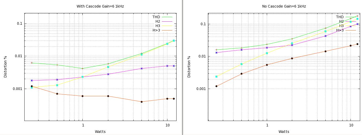

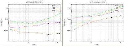

Here are sweeps of harmonics vs. watts at 1kHz into 8 ohms. Bias is 1.3A. No AC degeneration.
Left is with cascoding, right is without. Obviously cascoding reduces all harmonics, particularly H3 and higher.
Sorry, I misread the colors on the cascoded plots. With cascoding H2 and >H3 harmonics are greatly reduced and much flatter curves. H3 increases at about the same rate, but at much lower overall levels.

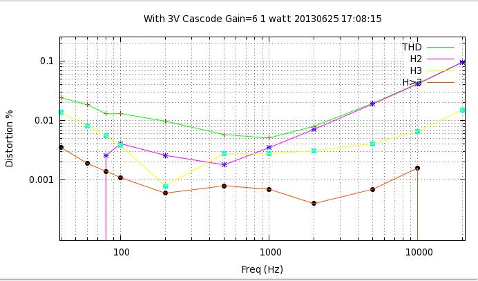

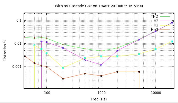

Here is an experiment is different cascode voltages. On the left is a 1watt THD sweep with Vds=3V on the drive FETs. On the right is a sweep with Vds=8V.
No significant difference.
it's begging for rails voltage decrease ; even if cascoded , I believe entire shebang will behave sweeter having more proper voltage across cascoded (active) mosfets
that's at least my experience with Jfets - in yore , when I compared Papa Borbely approach ( "voltage starved" ) vs. Papa approach (put them in sweet spot and cascode)
I am still trying to figure out what you intended to say here. Why do you say "rails voltage decrease"? Are you suggesting that I reduce Vds of the drive FETs below 3V? Without cascoding, these FETs do rather well at about Vds=20V to 30V. With cascoding at Vds=3V, I am seeing 5x-10x decrease in distortion. At Vds=8V I do not see any significant improvement. I did not even consider Vds=20V because that would double idle power dissipation.
