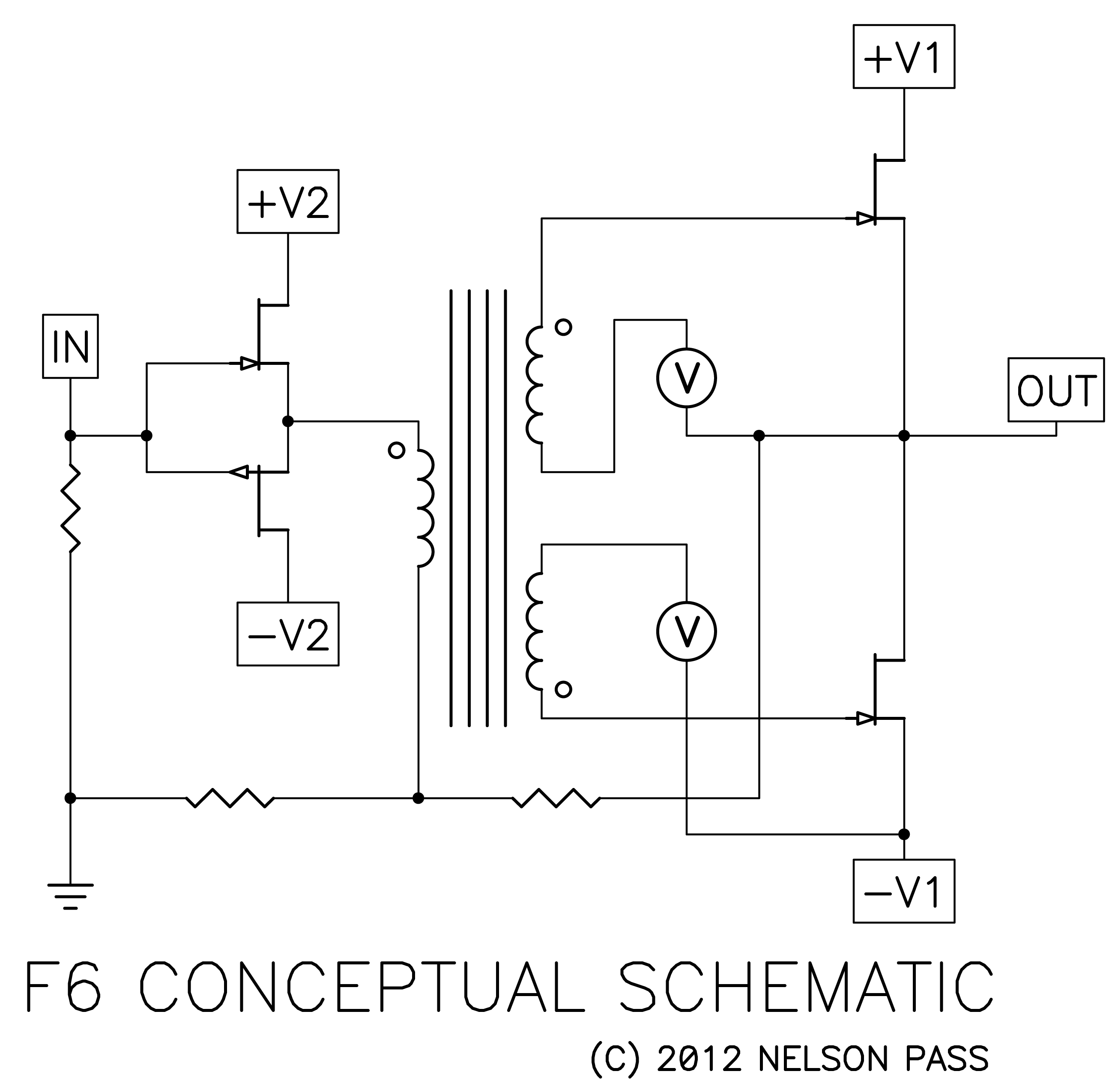

I reread the F6 article on Firstwatt website. Nelson clearly states that F6 was build with SemiSouth SJEP 120100.
As I'm going to upgrade my F6 to Mk II version soon (I will add second PSU to make it a dual mono), maybe I could test it with some other output devises. Can you suggest any other alternatives with reasonable prices and availability (FET rolling!)?

The original F6 was with now obsolete power jFETs. Is the UJ3N065080K3S SIC jFET useable? I have not seen a reference to this yet.
However, one might need mighty tricks to handle it: because the nice behaviour is only there at low Vds --> a cascode os needed?

The production FW F6 uses IRFP240, not Semisouth devices - see page 9 of the F6 owners manual.
There are a few SemiSouth R100 built F6s running around but only Papa Nelson can tell you how many of those there are.
This last item makes for an interesting story because the F6 started out as a very nice amplifier using the SemiSouth R100 enhancement-mode power Jfets. While SemiSouth is no more, I have an adequate stock to support production, and I originally thought to use them for this. However I was in no hurry to get it out, and so had the time to play around with other gain devices, including the R085 depletion-mode Jfets and the SIT-1 transistors.
It was surprising that the R085 and SIT transistors did not perform as well since they had done a little bit better job than the R100's in single-ended circuits. By this I mean that people did not like the sound as much – the specs were ok.
The primary difference is that the R100 has a higher Drain impedance, that is to say that it behaves more like a voltage controlled current source, where the other parts behave a bit more like voltage controlled resistors. In tube vernacular you would say that the R100 is “Pentode-like” and the others were more “Triode-like”.
The single-ended J2 and SIT-1 amplifiers are fine examples where the best performance is obtained by low impedance Drain types of transistors, and in both cases they are fed current by (relatively) distortion-free current sources – in the case of the SIT-1 a big power resistor. Meanwhile, I have examples of pushpull circuits where the “Pentode-like” devices are preferred.
This of course led me back toward a device more like a Pentode than the R100, of which the IRFP240 is a fine example. Putting that device in this topology resulted in better sound, so it stayed.
