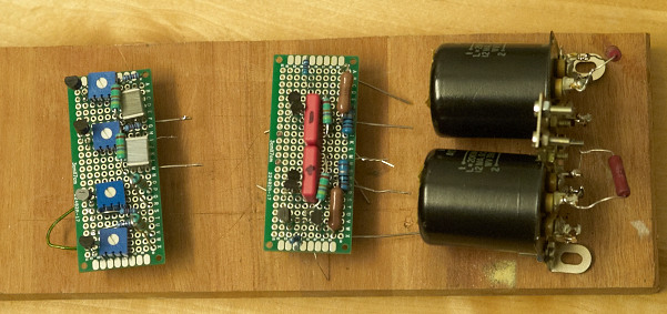

I do have the Jensen transformers so need only a PCB. Just to replace my test outfit:

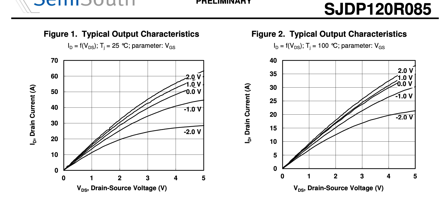

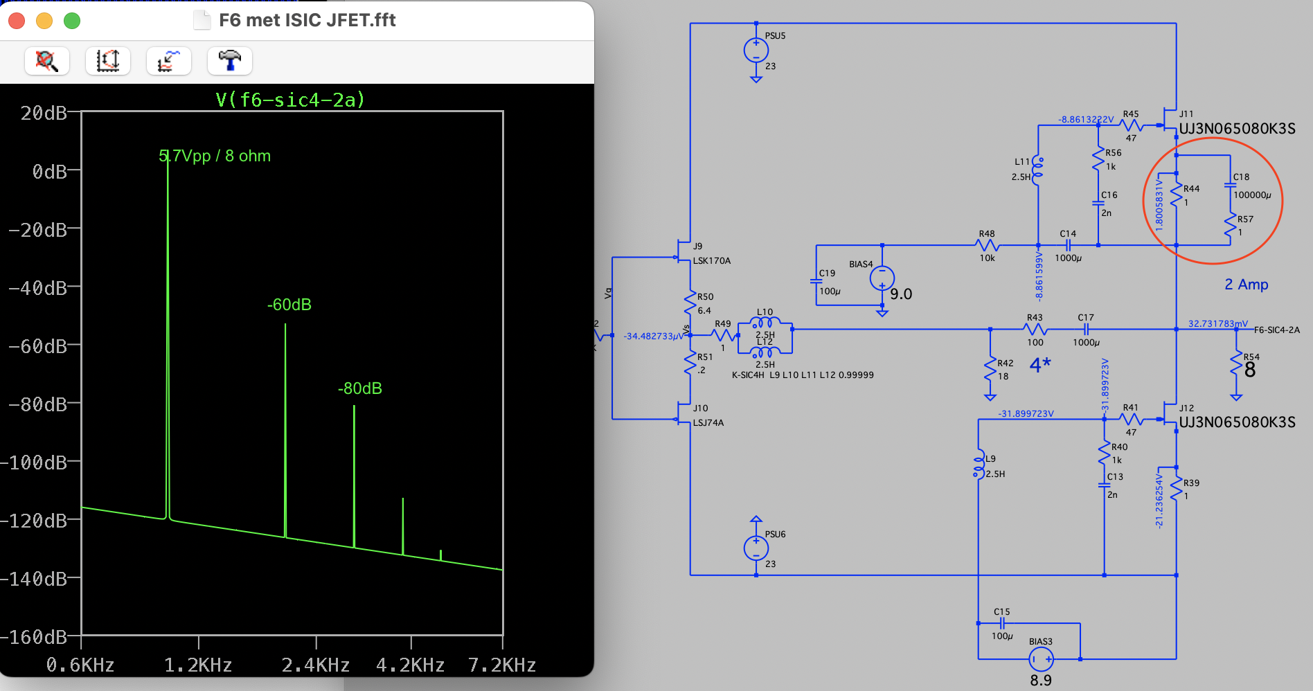

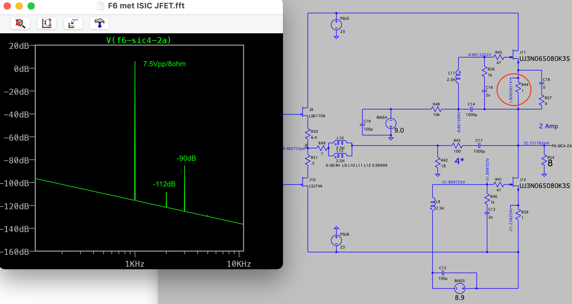

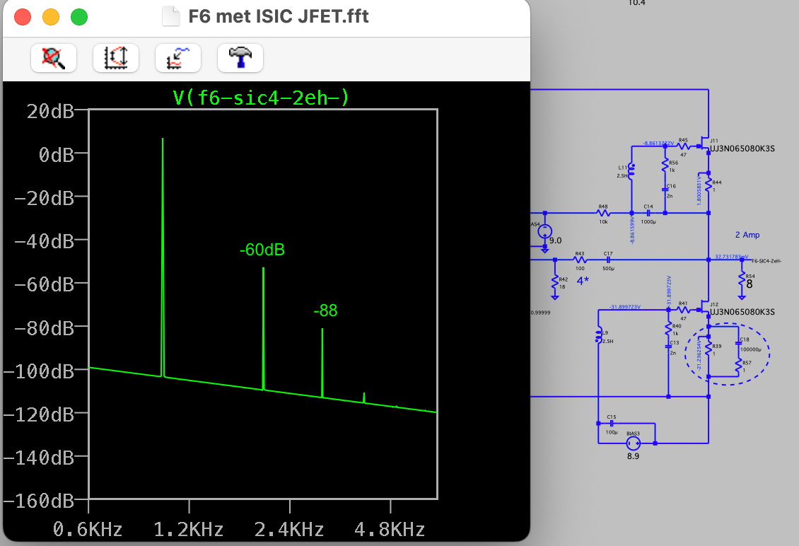

The original F6 was with now obsolete power jFETs. Is the UJ3N065080K3S SIC jFET useable? I have not seen a reference to this yet.
However, one might need mighty tricks to handle it: because the nice behaviour is only there at low Vds --> a cascode os needed?

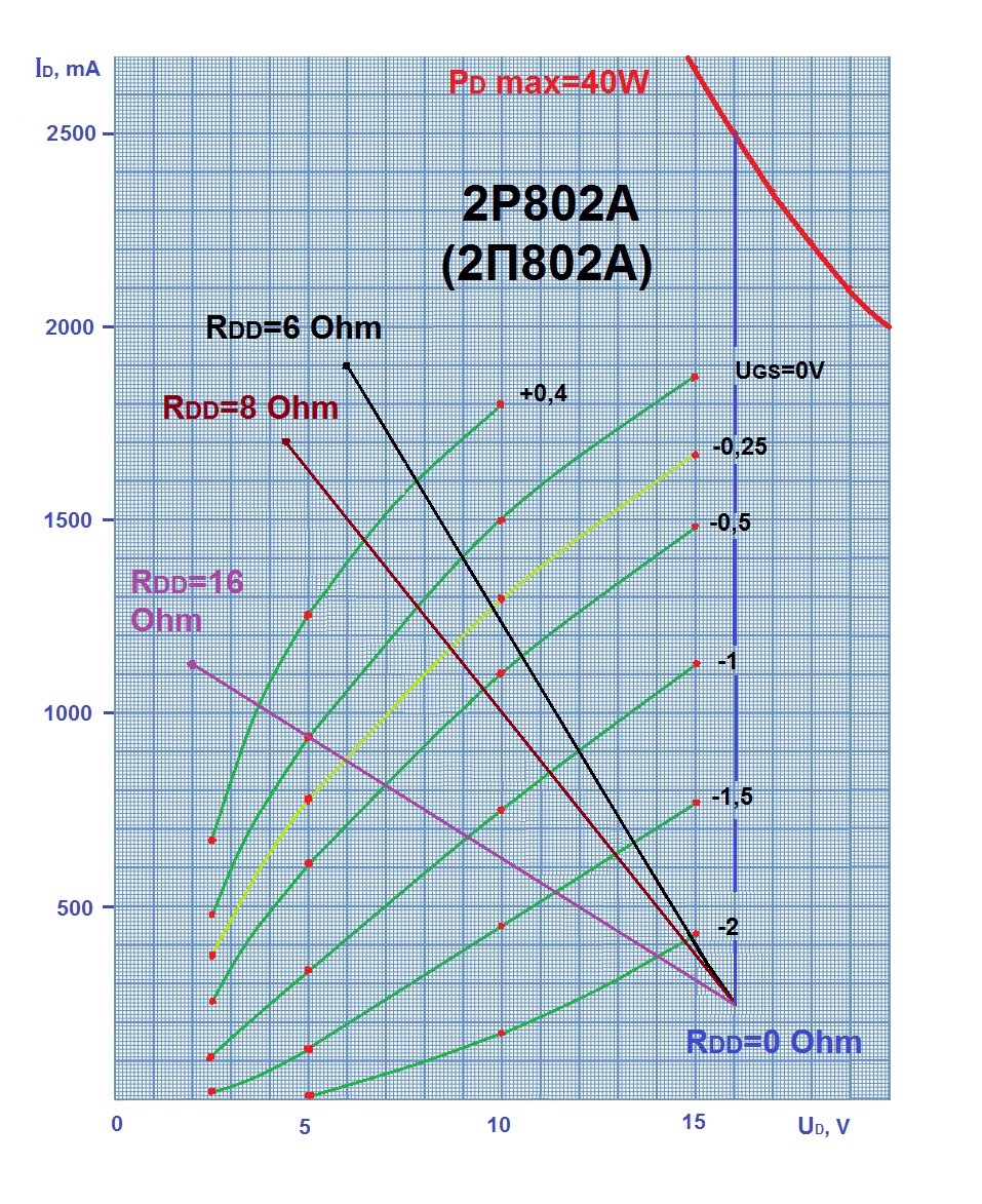

https://www.diyaudio.com/community/threads/power-jfets-in-production.331156/post-6311574
- But then, one could also use the LU1014 . . for a soundwise very reliable result (apart from bias shift), if designing a cascode. . .
