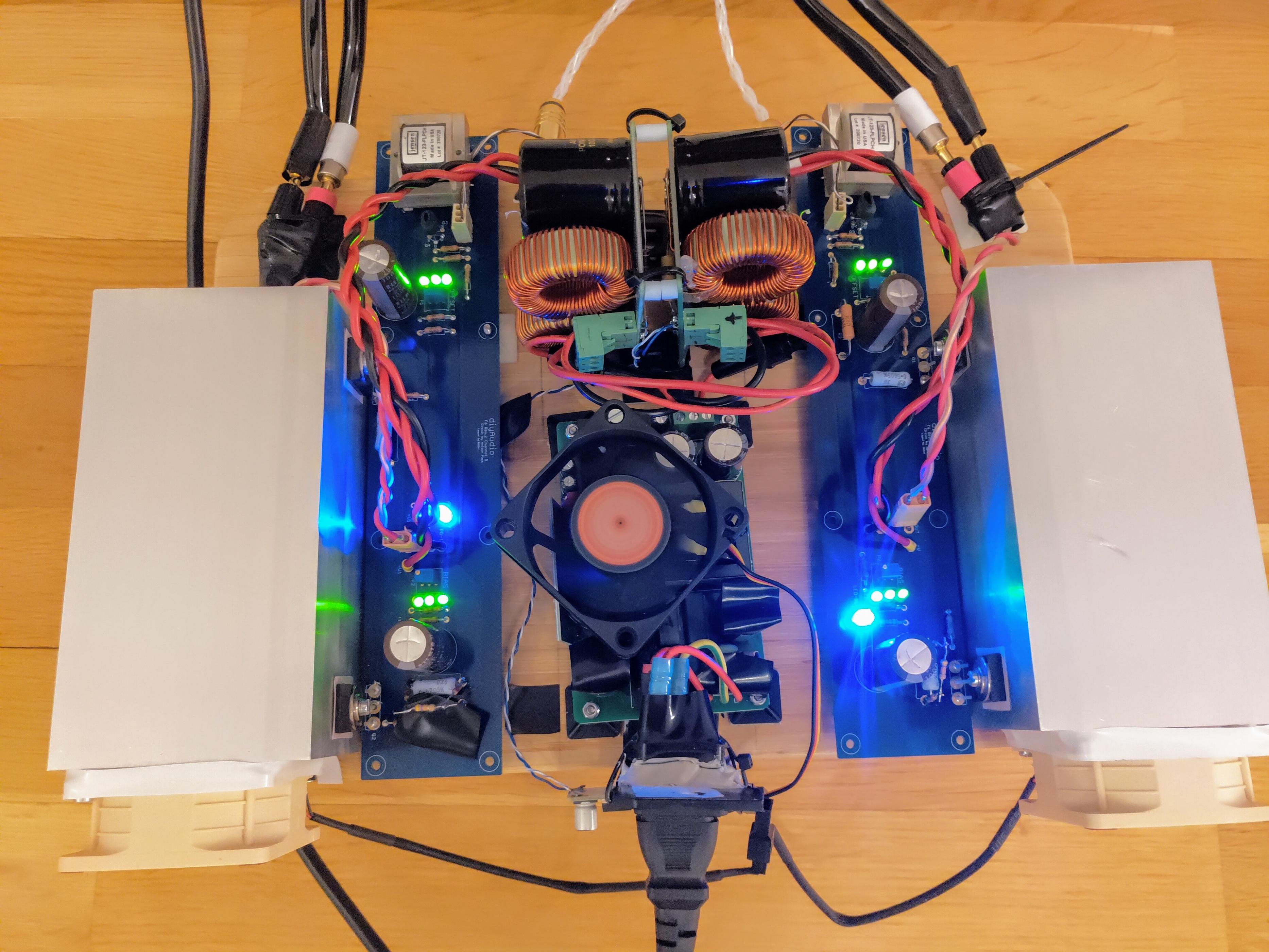

Dear DIY fellows,
I finished my F6 amp last summer. I posted some pictures in the ”Pictures of your diy Pass amplifier thread”.
My F6 is very standard following the DIY Audio F6 build guide, all F6 key components are from DIY Store. Power supply is a standard DIY PSU with +/-18V, 300VA toroidal transformer with +-23VDC output to the amp. Bias is 600mV (1.28A). Offset is close to zero, only few mV max and stable.
After construction I made a set of measurements.
Measurement results attached:
THD vs. Power at 4.1 Ohm and 8.2 Ohm loads
THD vs. Frequency at 1W to 8.2 Ohm
I also measured output impedance which in approx. 1.2 Ohms.
I compared these results to the ones published on the Firstwatt website and found my F6 to be much worse.
Can you give any suggestions if these THD vs. Power level and THD vs frequency measurement results are normal and similar what you have measured on your F6? Can you advise if something is wrong? The difference to published specs is significant, is this OK? Should I be worried that something is wrong and my amp’s is not operating optimally?
After all the amp sounds wonderful and drives my electrostatic loudspeakers to a sufficiently high SPLs. And I’m still sleeping well!
