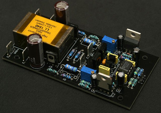

Is anybody using a Lundahl LL1544A in these amps instead of the "stock" transformer? I know it won't fit the board. I have a pair of these waiting to build an Amity tube amp, but I know I'll never get to it.
Looking at the spec sheets of the two transformers I have a hard time figuring out if these are even the same type of component. The only clue I have is this: "In addition, as this type of core does not store energy (unlike conventional mu-metal cores)" so zero capacitance?
I would email lundahl and ask them for the same specs that Jenson offer in their data sheet.
These are basic measurements and lundahl should be able to provide them.
You could even measure them yourself and get a reasonable estimate.
I remember that Gerd tried some of Lundahls in M2
can't fathom which type exactly , but it wasn't pure repeater ......... anyway , by memory - it was better than Edcor ( must be , considering price difference) but wasn't better than ancient Iskra (telephone installation equipment origin)
in short - it's hard to get anything from specs - just try it
I have used 1540 and 1517 and whatnot...
1544 is a good candidate, go for it.
Thanks all. I always think of these Lundahls I have as being high-quality items and would expect them to perform well. Now all I have to do is finish my kitchen remodel, my porch rebuild, my backyard clean up, get rid of my old Jeep, paint the entire house...
Maybe Nelson could organise a custom order of transformers that meet his exact requirements, like the SIT devices.
We would certainly buy them, no worries there.
