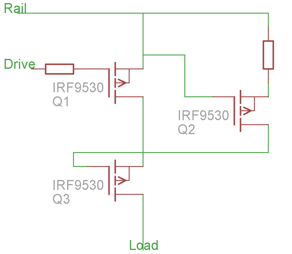

Woudl this work?

And there you have it. Probably the next issue you might want to think about
is the increased capacitance of the gain devices operated at 3 volts.
I was hoping that with cascoded outputs that the increased capacitances of the drive MOSFETs would a relatively minor issue. Perhaps I have a serious gap in my knowledge about cascoded stages. I haven't seen discussions of the capacitance effects due to the cascode devices or parameters of them that should be optimized.
Other than increasing Vds of the drive MOSFETs or using a lower impedance driver circuit, what can be done to reduce the effects due to these capacitances?

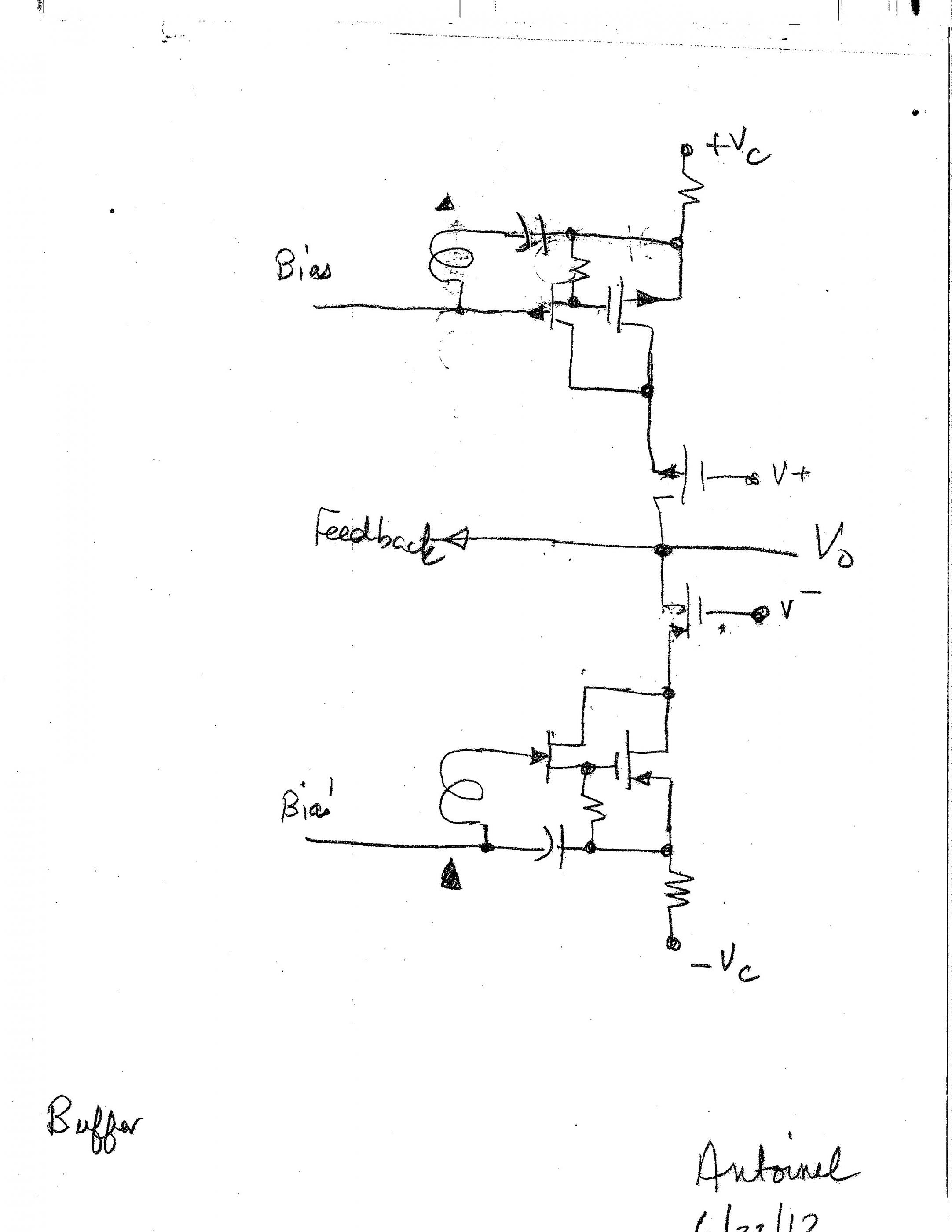

Maybe best of all worlds. A proposed buffer circuit is attached. Complementary enhancement JFETs or bjts; your choice.

and then there goes simplicity outa window.........
even if idea is interesting , per se .......
remember that all 3 (4) windings in F6 are the same , so you're having same AC on disposal ( to feed output gates ) , having it through or without xformer , when input buffer is used

Thanks Zen Mod. Please show a clarifying schematic as your time allows. One may also consider a quasi P-channel complement of R100A [or other JFET] by compounding it with a leading small signal bjt; for example. Mr. Pass used quasi PNPs in older work you showed in a post of Papa's Pub's. It is less symmetric; but the input capacitance presented to the secondary windings is like that in diyF6.

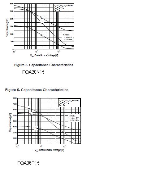

I went with the FQA28N15 and FQA36P15 primarily for their high transconductance. Given that Vdsmax and power dissipation requirements are lower for the drive FETs, I could probably find a N/P FET pair with better characteristics. How about sending me some LU1014s and their P-channel complement? 😀

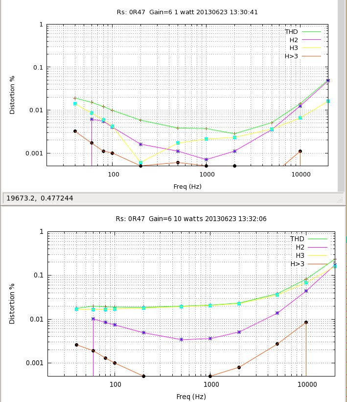

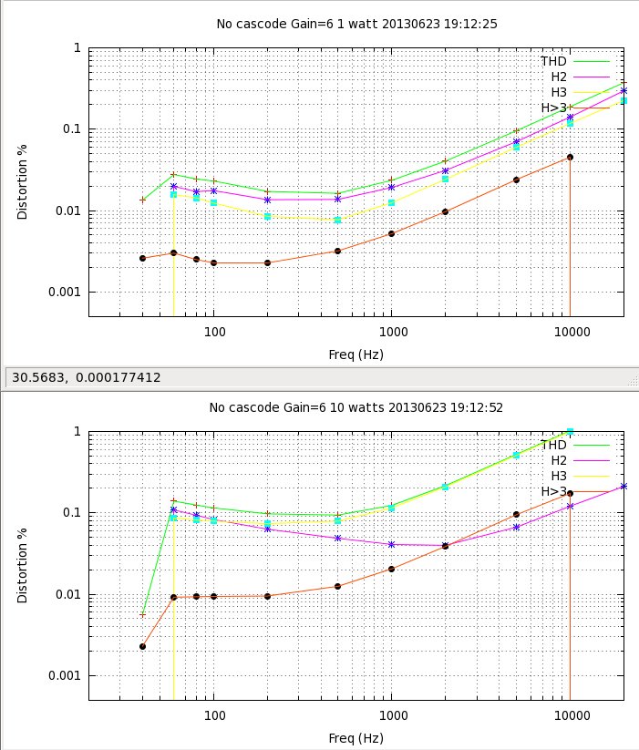

Here is a comparison of my F6CC with and without cascoding. The left plots are with cascoding and Vds=3V on the drive FETs. The right plots are without cascoding. In both cases adjustments of P3 and P4 were made to minimize H2 as 1kHz, 1watt.
What is really interesting is the difference at 10 watts, and how flat the THD curve is for the cascoded circuit.

These are nice comparisons - thank you for posting them.
If you do try the cascoded circ at some point, there are a lot of new and many not-so-new N channel low (and flat) Ciss Fets that you can use in the outputs. You might find that you like the results quite a lot - even without cascoding.

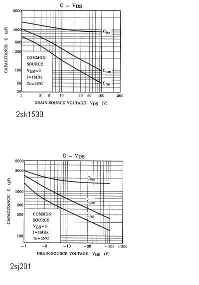

I think you know the 1530/201 pairs and they may be worth a try. I used the n channel only and found it pretty decent. These might do better in your design compared to some direct coupled designs due to their low Vth. The p channel 201s, I haven't tried apart from just measuring them but many say that they are good.
here are the Ciss charts from the datasheets - in both cases the P channel parts have higher capacitances compared to their n channel pairs but the toshiba complements look closer on paper. They appear flatter also.
