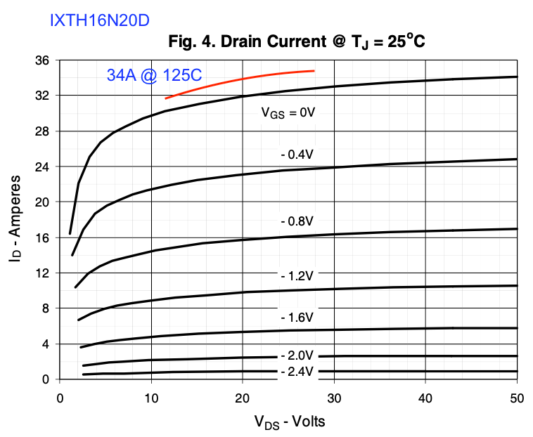

anyway I found these depletion mosfets:
At around 2 amps they need some Rs but then they are fine
1) IXTH6N50D2 Stable with 1.1Ω, Ciss = 2.8nF; at 4.5S ; Stable (Example Rs 0.5Ω+0.56Ω; 1.2Ω//20Ω). Good tempco ... € 13/Mouser
2) IXTH16N20D2. Ciss = 5,5nF Vgs = -2,2V @ 2Amp, 12S; Ron 80mΩ Take a Rs=1Ω or 1.2Ω €22/Mouser. Slight pos tempco, but with such a Rs that is moot.
The second looks like a powerhouse to me. The first one looks very useable too.
How to simulate these? Any models floating around? Any on-hand experience?
With these, it looks like the 'original' F6 with R100 looks like obtainable!

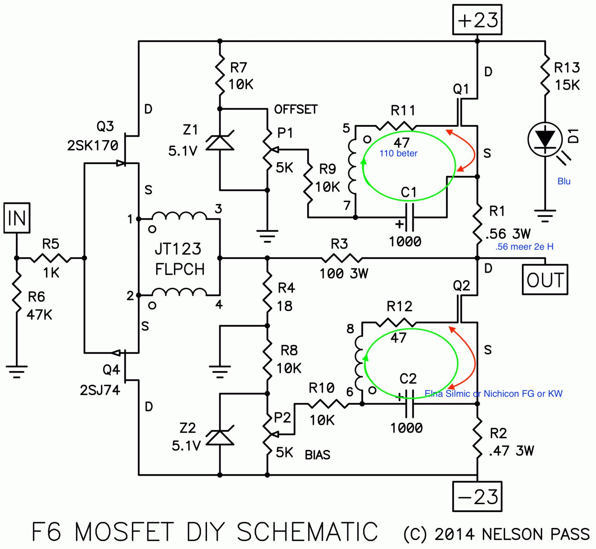

how about this KISS?
the potmeter 5Ω allows skewing of the working points and hence the balance / phase of H2. which one I don't know yet;
once determined it should remain stable.
[I had such skewing on a balanced preamp in the nineties]
I totally agree. all degeneration will destroy the vibration.
and putting a big .1 - 1F across it helps little probably.
note the F6/IRFP has 0.47Ω or 0.56Ω.
This beast has 1Ω. What is the difference?
here the degeneration is as variable as the sloppy drawing of a potmeter to its wiper the capacitor is attached.
top = little; bottom a lot (up to 1 or 1,5dB difference) - theoretically impossible to hear.
or have the other half use this; enfin you know the trick.
A bias V- would be more comfortable and is easy to make for the top. attach a green led (yes green please!?) to earth and the V- and presto you have some -1,7V bias for the wiper to scratch. :scratch: Or a fixed-Voltage-device of 2.5V .
Then no degeneration on top.
But then you will have to test the harmonics of the whole with only degeneration at the bottom. . and that might switch the phase around (It is all in my head now, sorry)
