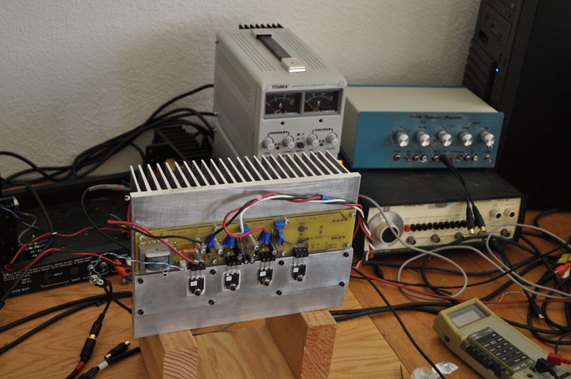

I received my F6CC Teaser boards and parts. Here is a picture of the build so far. Obviously the MOSFETs have not been yet attached with mica and grease. I am about ready for a smoke test.
This is a bench-test setup where the MOSFETs are attached using MOLEX connectors and elevated by a 1/4" aluminum plate which is attached to the heatsink with thermal grease and screws. This makes it easy to experiment with different MOSFETs be unscrewing them and readjusting the bias voltages. Also, using hex standoffs for power and output connections makes board removal easy in order to make component changes.
Will the heat sink be cooled by forced-air?

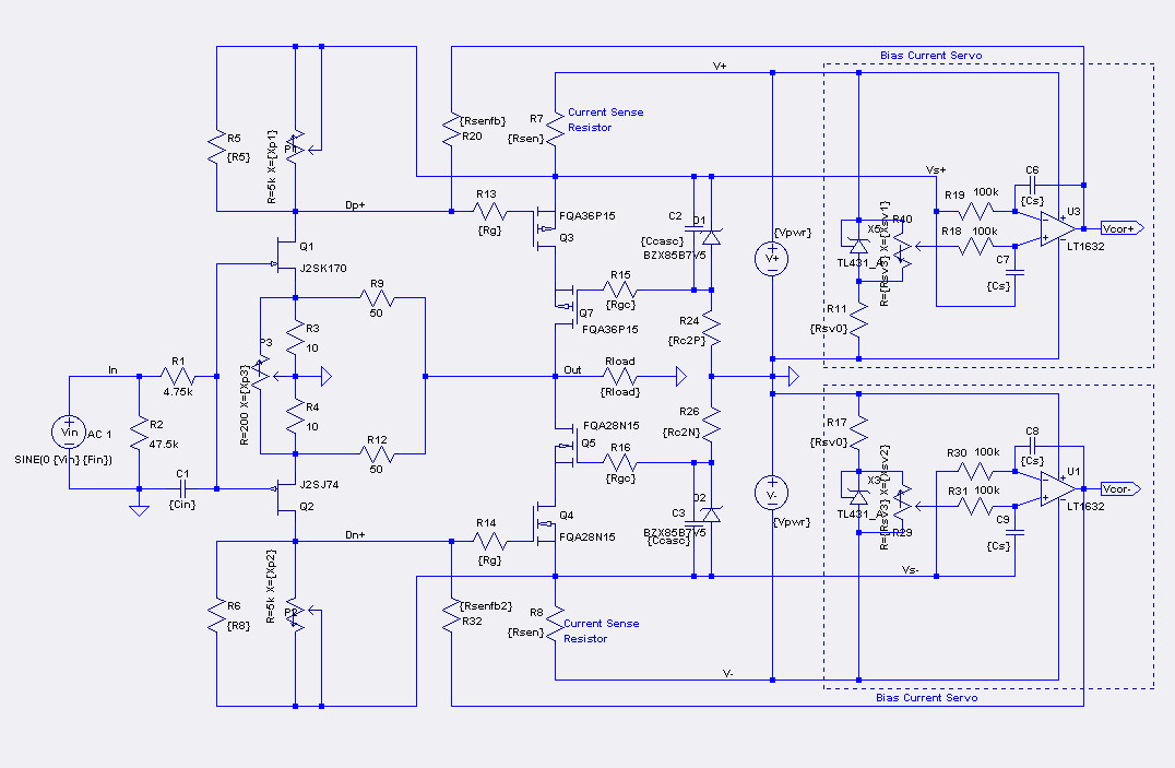

What you are suggesting could be accomplished in a simpler manner using a DC current servo in the gate bias circuit. Here is an example of a design for a cascoded F5 with no AC degeneration using a current servo:
As I have repeatedly stated, with the transformer secondaries connected to the MOSFET source pins, there is no AC degeneration, and the source resistor only affects DC bias stabilization. Same in the F6.
DC servo is a fascinating development; maybe a first to use an op amp in this thread or even the Pass Labs Forum.

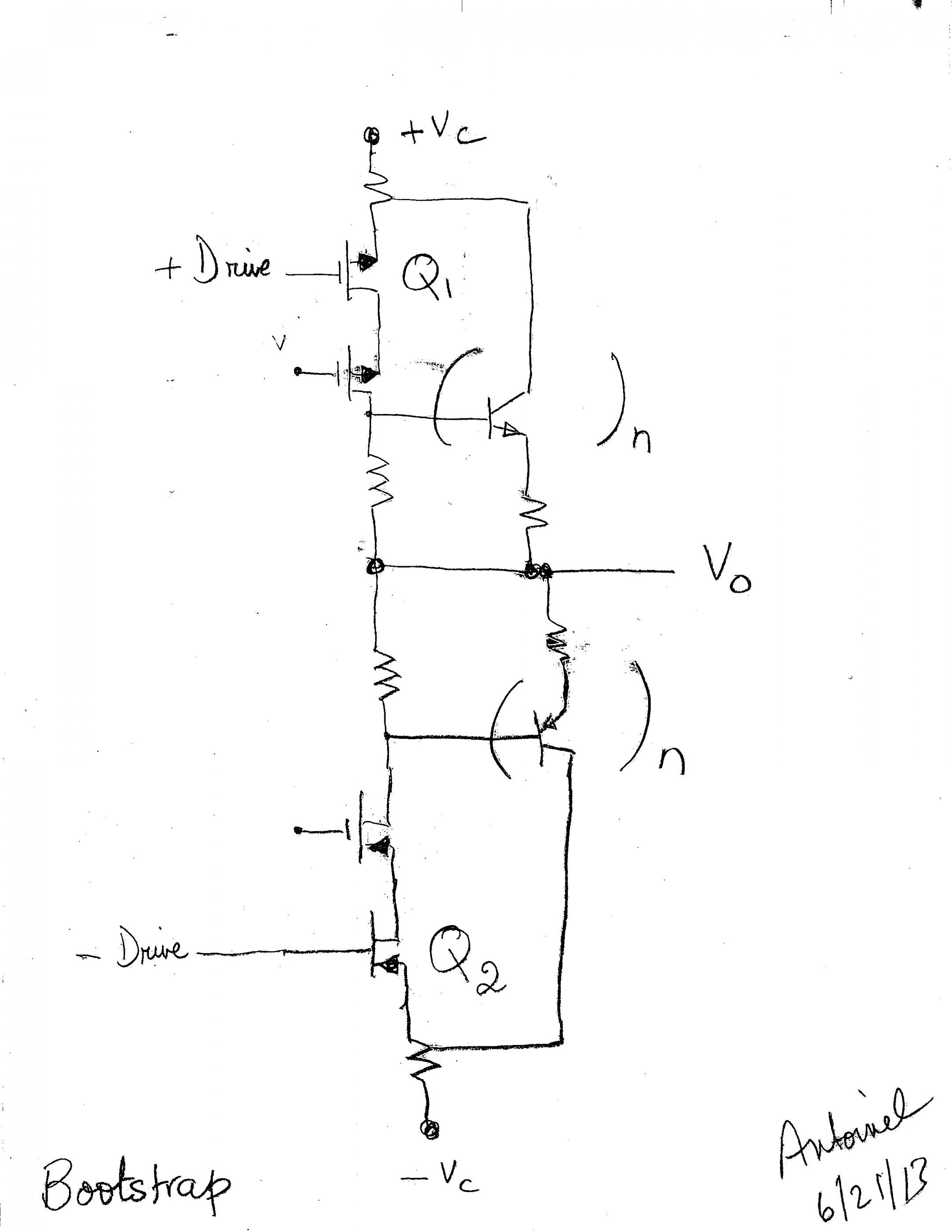

A possible idea to stabilize the bias of the output stage will be to idle Q1 and Q2 at a lower current, and simultanously augment the needed total output current with [n] complementary current bootstraps; shown as bjts for example. This proposed circuit [attached] develops a constant voltage across Q1 and Q2 [your cascodes], and a simultaneous contant current flowing through them. This thinking was borrowed from US 4,107,619 which is STASIS[R] for the amps of Threshold Corp.
It is possible that this circuit may also function as a souped up F5!
No smoke! :) The board layout appears to be fine, except that the pots are backwards wrt. clockwise increasing the relevant parameter (no big deal).
The overall bias current stability is fine, except that the output offset voltage drifts more than I would like. Is this problem related to the cascoded outputs? If so, there might be a simple 2-resistor solution based on negative feedback to the bias circuits.
The THD measurements are OK, but not as good as I am looking for. There is still a lot of tweaking to do.

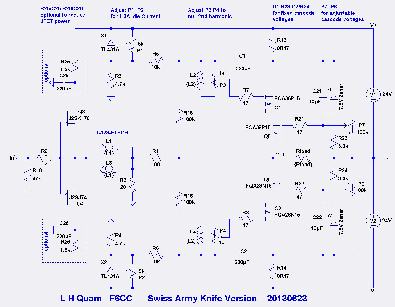

I believe that the DC offset problem is due to lack of any DC negative feedback. In the F6, the upper bias circuit couples to the output voltage, providing negative feedback to stabilize the offset voltage. In my F6CC, both bias circuits are referenced to the rails. By removing the cascode FETS and jumpering source-to-drain, I can easily verify whether the stability issue is due to cascoding.

I found a 2 resistor "solution" to the output offset issue as shown below. R15 and R16 provide negative feedback to the bias voltages sufficient to stabilize the output offset voltage. Because of the symmetric nature of the feedback, the output offset is largely insensitive to equal changes in the rail voltages due to an AC mains voltage change. The downside is that the idle current changes 28ma per volt change on 120V mains. Thus if the amplifier is biased for 1.3A at 120 volts, the bias will drop to 1.244A at 118V on the mains. I have not found a simple circuit that does any better.

Will the [feedforward] proposed approach in post# 4381 help? Does diyF5 have the difficulty Teaser F6CC have?
Please show on your schematic the voltage drop across R25, R26 [on drains of front end], and Vgs for Q1 and Q2.
Thanks and best regards
The F5 does not have the output offset problem because it is entirely DC coupled, thus the negative feedback applies to output offset as well as to AC voltage.
Here is the schematic with some voltages added.
