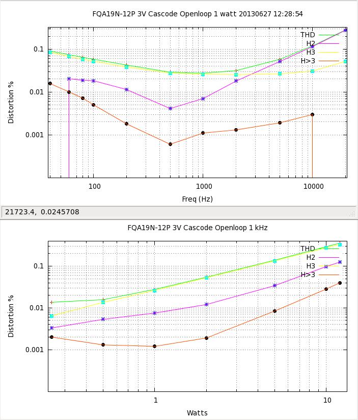

Switched the output drive FETs to FQA19N20C and FQA12P20. Here are OPENLOOP THD sweeps. The output offset voltage is much more stable than with the FQA28N15 and FQA36P15 drive FETs. It probably means that the added stabilization resistors can be increased in size, thus reducing their influence on bias current when the rail voltages change.
I am pursuing the additional complexity of cascoding the output FETs and using complementary output FETs. The challenge is to push the limits of that twist on the original F6 design.
