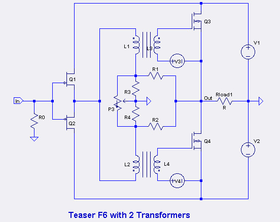

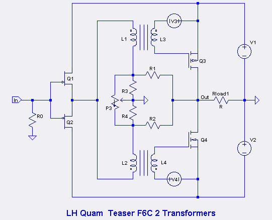

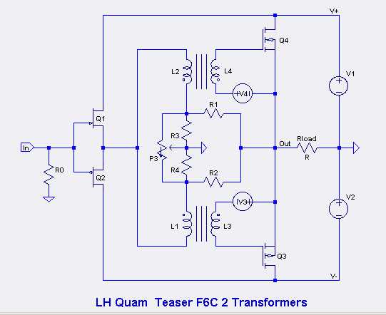

Here is a sequence of F6 variants using 2 bifilar transformers and the feedback network modifies for nulling H2. The leftmost variant is the original F6 using only N-channel output FETs. The middle is a non-cascoded complementary variant. The rightmost is another non-cascoded complementary variant with output FETs swapped top-to-bottom. Yes, it looks like a complementary source-follower, but the voltages on the gates are relative to their source pins, not ground. Therefore it is a complementary common-source output stage. I am not sure why one would use this variant.

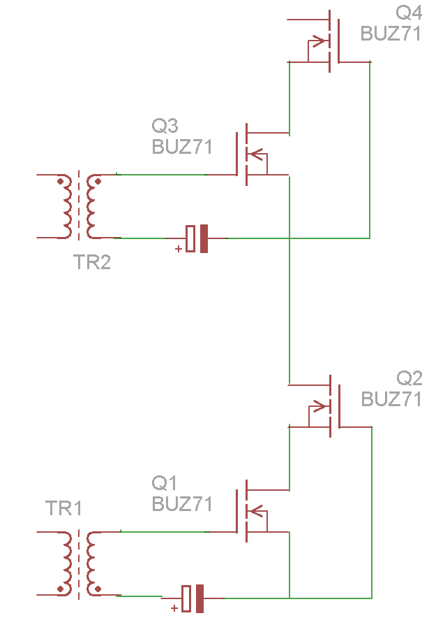

If one of the transformer windings is flipped, that should work as a (non-complementary) cascoded F6. Generating the bais voltage for the upper cascode FET might be a little tricky, but not that different from the bias for the upper drive FET.😀
I didnt know how to put voltage source in the schematic, but this is general idea, I tihnk.
I was just tryign to illustrate an F6 with cascodes. Two transformers are shown, but they are intended as quadrifilar, as in the original F6.
I think it would be difficult to overcome H2 in a cascoded F6.I was just tryign to illustrate an F6 with cascodes. Two transformers are shown, but they are intended as quadrifilar, as in the original F6.
There are two (or more) separate distortion mechanisms to consider.
- First is the output FET transconductance equation, which defines the drain current as a function of the gate voltage. Ignoring the internal source resistance, the equation is: Id = Kp/2*(Vgs - Vt)^2*(1+lambda*Vds). Cascoding causes the Vds term two be nearly constant, and the equation becomes mostly a quadratic function of gate voltage. This is good, because push-pull output stages can cancel the even order distortions.
- Second are the AC capacitances which cause frequency dependent currents in the circuit. Transformer winding capacitances are major contributor to the H2 distortions in the F6. In the F6, the upper secondary winding is connected to the output voltage, which injects a significant frequency dependent current into the other windings. The complementary version of the F6 significantly reduces the distortions due to the winding capacitances.
Thank you for the very clear explanation. Would a balanced version be an opprotunity to cancel the 2nd harmonics generated in a standard F6 cascode?
Yup, if the two halves are well matched, but it will not sound like an F6.Thank you for the very clear explanation. Would a balanced version be an opprotunity to cancel the 2nd harmonics generated in a standard F6 cascode?
I like this concept. We have a SE version of a cascoded F6, the F6CC, that accomplishes 2K cancellation and a balanced version that does the same thing. Parts count and simplicity clearly favor the F6CC, while true complimentary devices favor the balanced version. Thank you again. I may try this.
