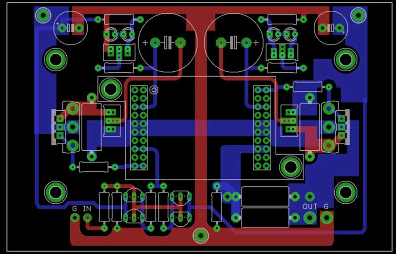

I don't think you really need the mounting flanges on the daughter boards. That will also add to the cost due to more than 5 points of routing.
I chatted with the board house on this. They dismissed any difficulty or high cost associated with it, and to essentially treat as a square board measured from the edges. It was CRTs idea to bolt on (and he has done the most work, me I just complain a lot about small things) and I think a good one. Probably a Jensen will not fall off, but I suspect an Edcore Xs-4400 like Generg uses might. Good precaution. I will start seperate thread soon once i am close to sending gerbers out for production.
So, with Nelson's approval, I will try to post something close to the following for sale after a prototype is made and built.
It will use a daughter card concept to add in a Onetics or Jensen transformer, or allow a Perfboard to be mounted on the 2x10 2.54 Male pins to roll your own transformer onto it.
It will have all four pots and will be based on the F6 Second Harmonic. If one wants a simpler versions than jumpers need to be put in place for it. It may not be for everyone, but it will reach market, pending approval and I don't get hit with a snowplow or something.:hohoho:

Tea
first one ( se.jpg ) is original, while second one (see.jpg ) is edited
difference is in point where you're going to solder main gnd from PSU
I moved it to mid bottom , that way securing that sig gnd is not poluted with speaker soaking :clown:
