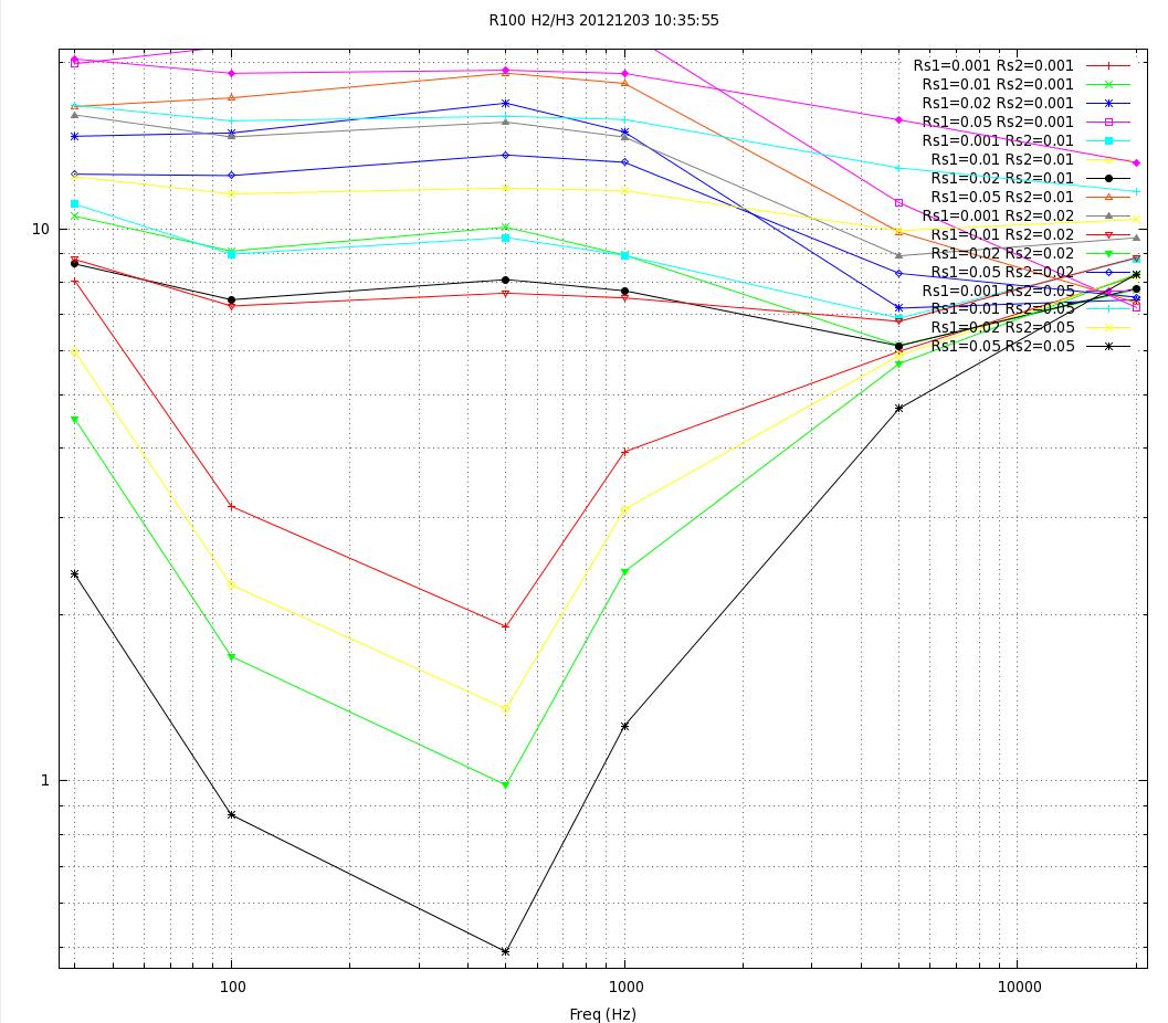

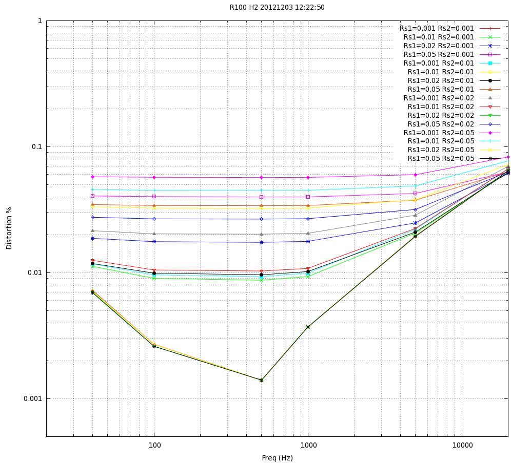

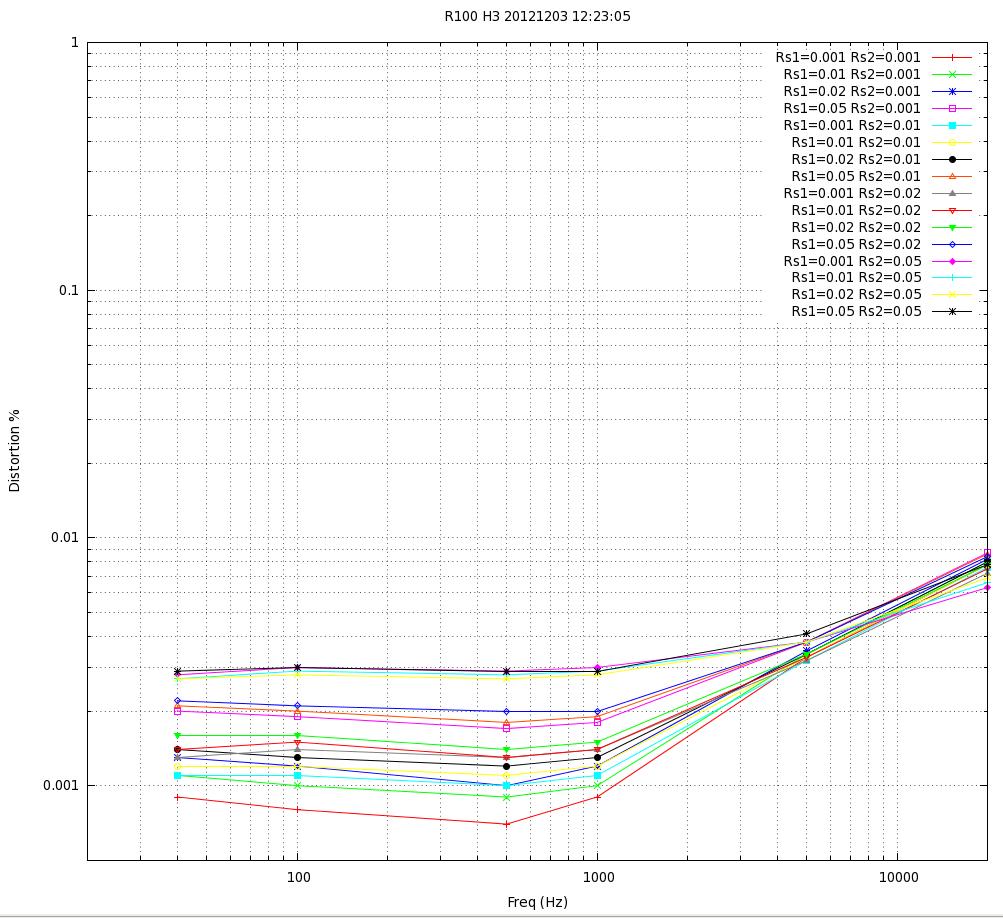

Here are some interesting plots based on Spice simulations with combinations of Rs1 and the Rs2, the upper and lower source resistors respectively. In all cases the F6 is driving an 8 ohm load at 1 watt. The plots are of the harmonics H2, H3 and H2/H3.

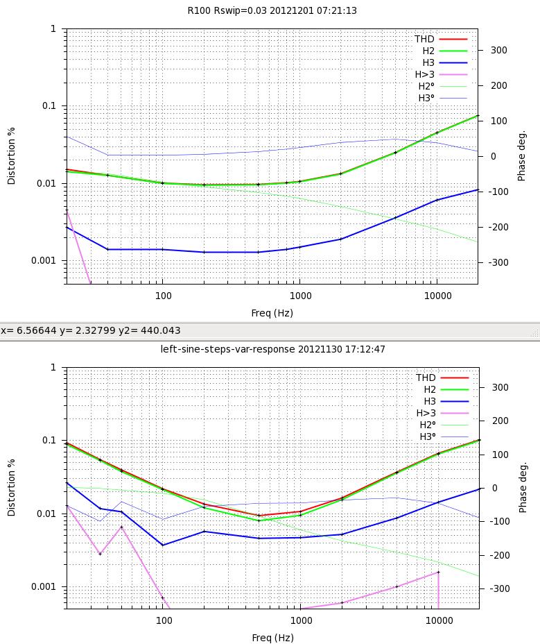

Simulation vs Measurements
For those of you who are sceptical about the utility of Spice simulations, particularly when transformers are involved, here are two plots that show a reasonable degree of agreement between simulation and measurement.
The plots show THD, H2, H2, H2phase, and H3 phase. The upper plot is from simulation; the lower plot from actual measurement of the Teaser-6 left channel.

Could you explain the 3rd simulation, H2/H3. The scale starts at 1% and goes off the chart?
Rush
The scale is not %, but the ratio of H2 to H3. Yes, one of the plots goes off the chart - I just got overzealous in windowing the graph.
