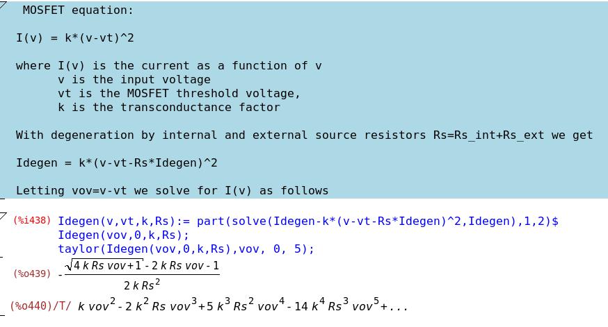

I think you are missing the point. The primary source of distortion in any FET amplifier is due to the square law nonlinearity of the devices. Any feedback, whether a global loop or local source degeneration introduces higher order distortion components.
The figure below shows a mathematical derivation of the harmonic components of a single ended FET common source amplifier with degeneration. The coefficients a powers of v, v^i correspond to the magnitudes of the corresponding harmonics. In a push-pull amplifier, the even harmonics tend to cancel if the device parameters and Rs are properly matches and/or adjusted. The important point of this derivation is that the odd harmonics can be reduced by minimizing Rs.

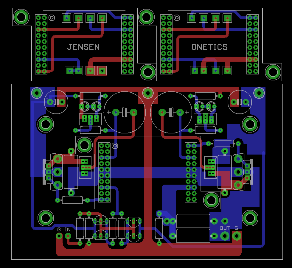

Thanks lhquam, you have the gift of such skills I can only wish and imagine to have. Please strike off the above clone STASIS (TM) idea with MOSFETs.
So, with Nelson's approval, I will try to post something close to the following for sale after a prototype is made and built.
It will use a daughter card concept to add in a Onetics or Jensen transformer, or allow a Perfboard to be mounted on the 2x10 2.54 Male pins to roll your own transformer onto it.
It will have all four pots and will be based on the F6 Second Harmonic. If one wants a simpler versions than jumpers need to be put in place for it. It may not be for everyone, but it will reach market, pending approval and I don't get hit with a snowplow or something.:hohoho:
