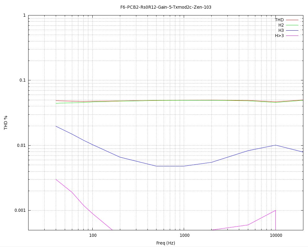

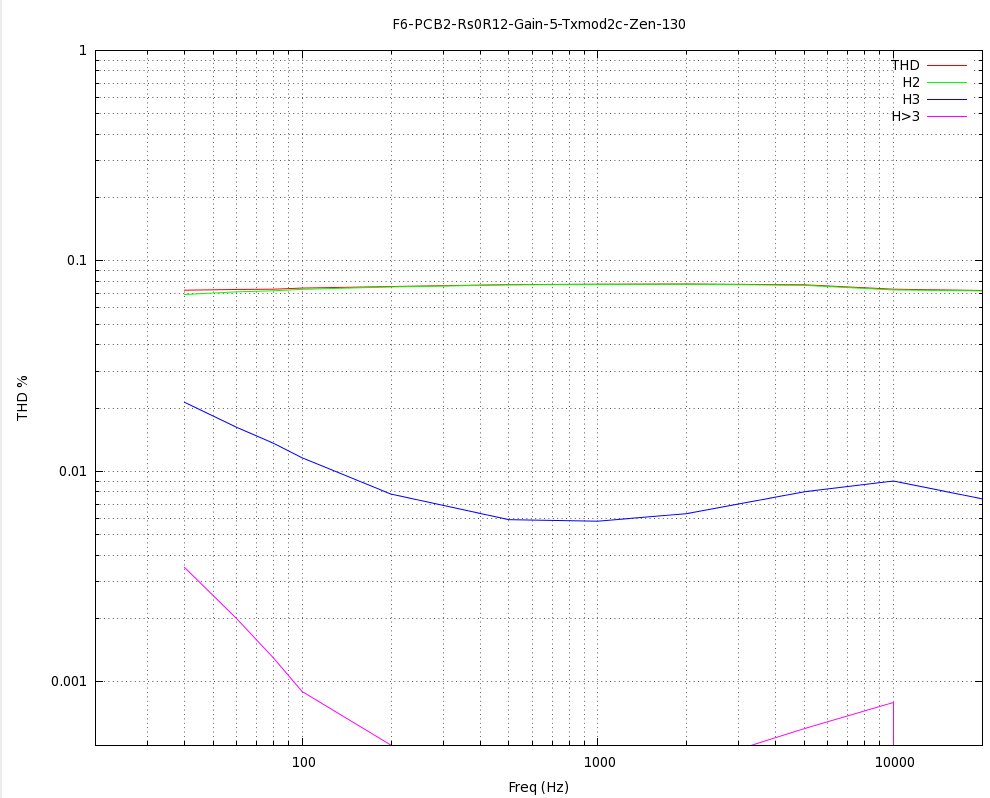

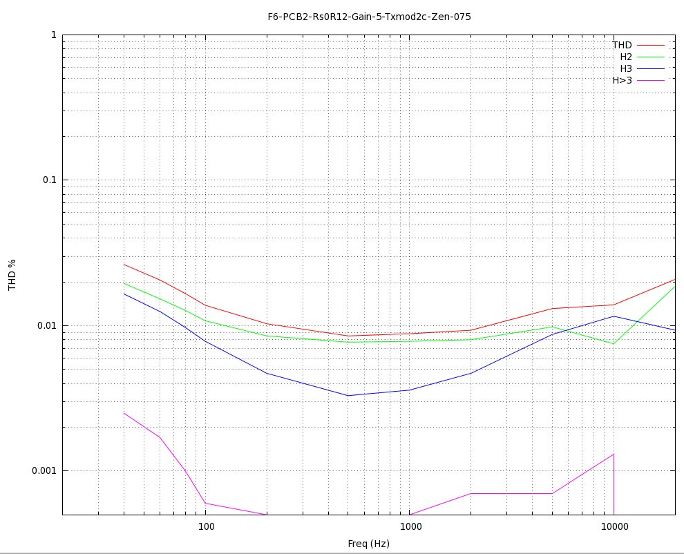

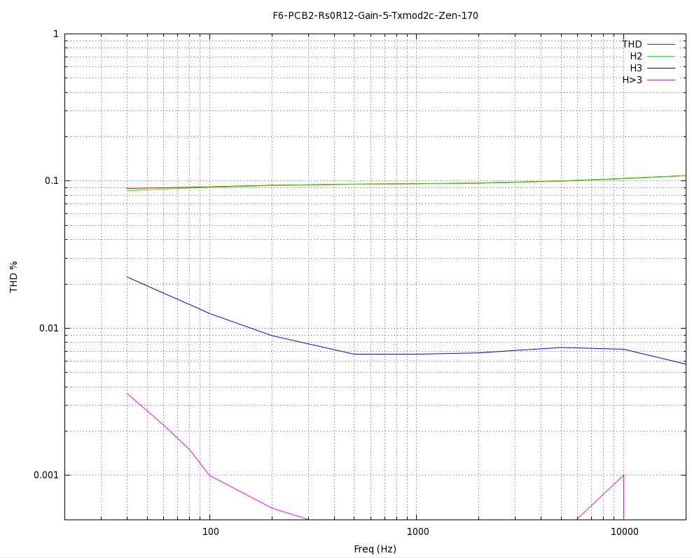

Here are actual measurements of the circuit shown in #2213 with a variety of adjustments to the Zen pots P3 and P4. The "spare" primary winding is modulated at 0.8*Vout.

I experimented with adjustments to the other PCB which still has the primary windings in parallel. For Gain other than 2.0, I could not obtain distortion spectra comparable to those in post #2237 which has the "spare" primary winding modulated by 0.8*Vout.
If anyone is interested, I can offer an explanation for why the modulation is optimal at (Gain-1)/Gain*Vout.
