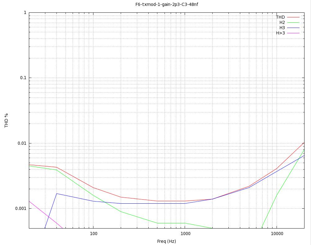

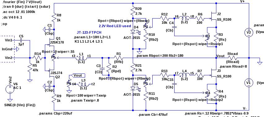

Here is a simulation of my latest circuit tweaks shown in the attached schematic. The purpose of these tweaks is to see how low I can get the 2nd harmonics and THD.
The primary changes are to allow one on the primary windings to freely float, the careful choice of the Rswip values to balance the AC currents through the source resistors, and the careful choice of C3 to null the 2nd harmonic at high frequencies.
The objective is to understand the role of the circuit parameters in determining the 2nd harmonic, not the configuration for best listening.
BTW: In the sweep, the sum of the harmonics greater than H3 is lower than H2.

With the winding floating, its AC voltage will be Vin*(Gain+1)/3 (ignoring all other circuit capacitances). If Gain=2, then the winding will float at the same AC voltage as the other primary winding.

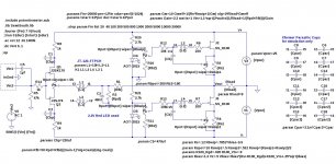

If two transformers are used in the way shown in the F6 Conceptual Schematic, there is still a problem. The AC voltages between the secondaries and the primaries are different. The top trafo has (Gain-1)*Vin AC voltage. The bottom trafo was -Vin AC voltage. If the Gain is chosen to be one, then the interwinding currents will cancel, otherwise they will not.

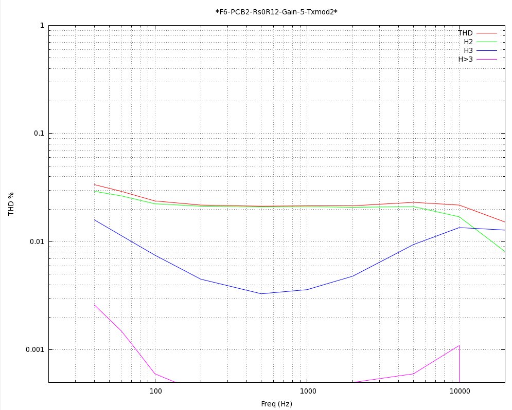

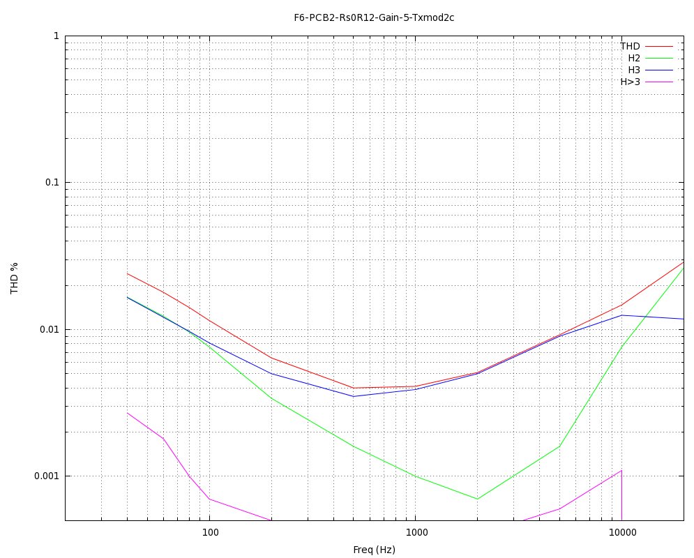

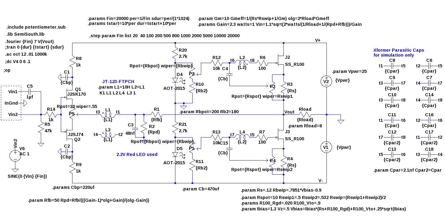

If the "spare" transformer winding is connected to a resistor divider generating (approx) Vout*(Gain-1)/Gain as shown in the schematic below, the interwinding parasitic currents are nulled.
I used a potentiometer to adjust the resistor divider ratio and generated the following harmonic distortion sweeps with slightly different adjustments of the Zen amount pot.
If you want to add more 2nd harmonic, use the Zen amount pot to increase it.
I like that mid pic

Zen, consider the 3.5k to 90k multiplication factor provided by the core, to any irregularity in the B Field transform from antenna to antenna up through 3.5 kHz. Then consider that it is physically impossible to wind quadfiller and keep all wires where they should lay. You can get a bifillar winding to couple perfectly, or very nearly so. You cannot say the same for four wires, wound into a narrow winding well, guided by either delicate fingers or uncontrollable mechanical traverse. The graphs shown will sound different, if for no other reason than where the differences are in the FR.

In post #2213 I forgot to mention that the graphs were NOT from simulations, but actual measurements.

You are overlooking another location for trimming the cancellation, which is
resistance across the secondary coils. Typical values would be on the order
of 200 ohms or more.

I briefly experimented with that in the early days of my Teaser-6 build, but other parameters were too far from the "sweet spot" at the time to detect an improvement. I will experiment with it again.
