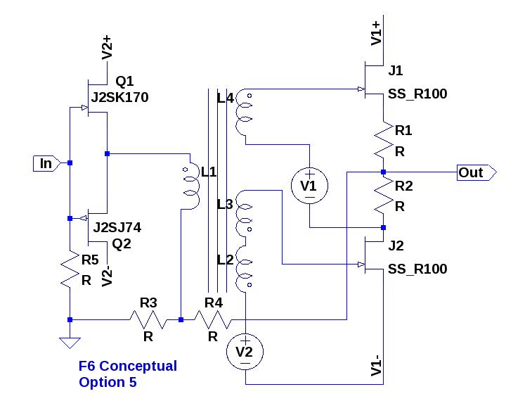

look at FIG.4B , for instance
Input signal Vi is shown as positive starting voltage signal at base of Q1
that became negative starting Voltage signal on node 102
which means rising current signal through R4
which means rising voltage signal across R4
which means positive starting voltage signal for Q3 base
which means negative starting voltage signal at base of Q2
which means Q1 and Q2 are fed with antiphase signals on respective gates
which is exactly shown on FIG.3B

F6 Decoded
I clearly misunderstood the invention US 5,710,522, and thus misinterpreted the operation of the Aleph Current Source. %7#* happens said Arnold's Predator. My apologies to y'all for inadvertently causing negative emotions, frustration and other ill effects. But; my screwup has a silver lining and I am happy to report its upside:
I have a great respect for Mr. Pass, you, and the rest of DIYers. Fortunately, I am not implying anything.
- The drive signals to the gates of the output JFETs in Conceptual F6 are out of phase like we've come to know and practice [e.g. by buzzforb, lhquam etc..]. This correct phasing is a fact, and is exactly like that in the invention US 5,710,522, and the Aleph Current Source. The upper output JFET in Conceptual F6 is a modulated current source load to the lower output JFET operating as the sole gain device. It follows from this analogy that Conceptual F6 is US 5,710,522; and in personal opinion, a simple and brilliant development.
- The in-phase signal drive to the gates of the output JFETs in Conceptual F6 is not US 5,710,522 or the Aleph Current Source. There is absolutely no relationship or connection between US 5,710,522 and the in-phase signal drives to the gates of the output JFETs in Conceptual F6. But; is there a reason which will prevent you and/or I from driving the gates of the output JFETs in Conceptual F6 with in-phase signals? Absolutely not. buzzforb: thank you for your ongoing coaching to stop speculating and test instead my hypotheses by actual diy building. I will gladly do this experiment and report my findings in a couple of days. But, buzzforb, lhquam and others may wish to race me to the answer!
I clearly misunderstood the invention US 5,710,522, and thus misinterpreted the operation of the Aleph Current Source. %7#* happens said Arnold's Predator. My apologies to y'all for inadvertently causing negative emotions, frustration and other ill effects. .......
no negative emotions , I was just somewhat tired showing you that you're splittin' wrong hair
[*]The drive signals to the gates of the output JFETs in Conceptual F6 are out of phase like we've come to know and practice [e.g. by buzzforb, lhquam etc..]. This correct phasing is a fact, and is exactly like that in the invention US 5,710,522, and the Aleph Current Source. The upper output JFET in Conceptual F6 is a modulated current source load to the lower output JFET operating as the sole gain device. It follows from this analogy that Conceptual F6 is US 5,710,522; and in personal opinion, a simple and brilliant development.
well , if you insist on looking at upper Jfet as CS ;
that's one way of observing the reality (sez that man who sez - gimme support point and I would move the Earth) ;
but - contrary to Aleph CCS , F6's "CS" have no any connection with current going to load , which is ,naive me , pretty much important virtue of said Aleph CCS
[*]The in-phase signal drive to the gates of the output JFETs in Conceptual F6 is not US 5,710,522 or the Aleph Current Source. There is absolutely no relationship or connection between US 5,710,522 and the in-phase signal drives to the gates of the output JFETs in Conceptual F6. But; is there a reason which will prevent you and/or I from driving the gates of the output JFETs in Conceptual F6 with in-phase signals? Absolutely not. buzzforb: thank you for your ongoing coaching to stop speculating and test instead my hypotheses by actual diy building. I will gladly do this experiment and report my findings in a couple of days. But, buzzforb, lhquam and others may wish to race me to the answer!

Here is F6 Conceptual Option 5. This might nearly double the open-loop gain.

I suppose I should cut a bunch of traces on my PCB and give it a try. But I am still tweaking my "original" Teaser-6.
Clever Ilquam. Toldyou this was tweakers amp.

Don't take it bad, Zen Mod, though you might be a little bit responsible of Antoinel barking up the wrong tree cause in phase driving should'nt seriously be contemplated like in the post you point at.🙂
that was my hysteric attempt to make sense from Pa's repeatedly confirmed but still incorrect schmts
catch is in fact that I'm/we are often thinking too much about hidden agenda behind his decisions , putting unnecessary burden on his shoulders
there is no reason that he must be serious and uber-responsible all the time ......
conclusion - there is nothing wrong with good olde quasi push-pull ....
