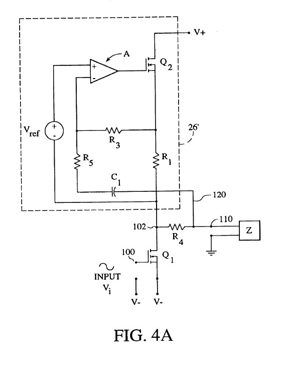

flg: Thanks for your explanation. lhquam: Zen Pot originated as a resistor in US Patent # 5,710,522; inventor Nelson Pass.
It is best to visit www.uspto.gov . Search for this patent by its number. Click on Images to see the first page which shows the schematic of this invention.
Or read the Zen ver2 paper authored by the One and Only, in wich you will find this quote "In 1991 I authored U.S. patent # 5,710,522 which detailed the operation of an active current source which was constant for DC characteristics but variable at AC frequencies and which could track an arbitrary percentage of output current to a load, relieving the active single- ended Class A gain device of some of the work." 😎

Mighty ZM invented both Aleph CCS and ZAP ;

illustration :
if you make R5 as variable resistor OR if you put 100R pot across R4 and connect C1's feed to wiper , you're having ZAP on Aleph

I'm not sure I would agree the control of Aleph current source modulation % is the same thing as the "P3" or Zen Pot. As I said, Papa put it on the F5 and the BA-3 F.E. The SRPP type circuits with tappable output point is a similar function though, as is the Aleph.
I would also not agree it is an introduction of "good distortion". It is more of the same distortion being introduced out of phase causing cancelation of the distortion.
