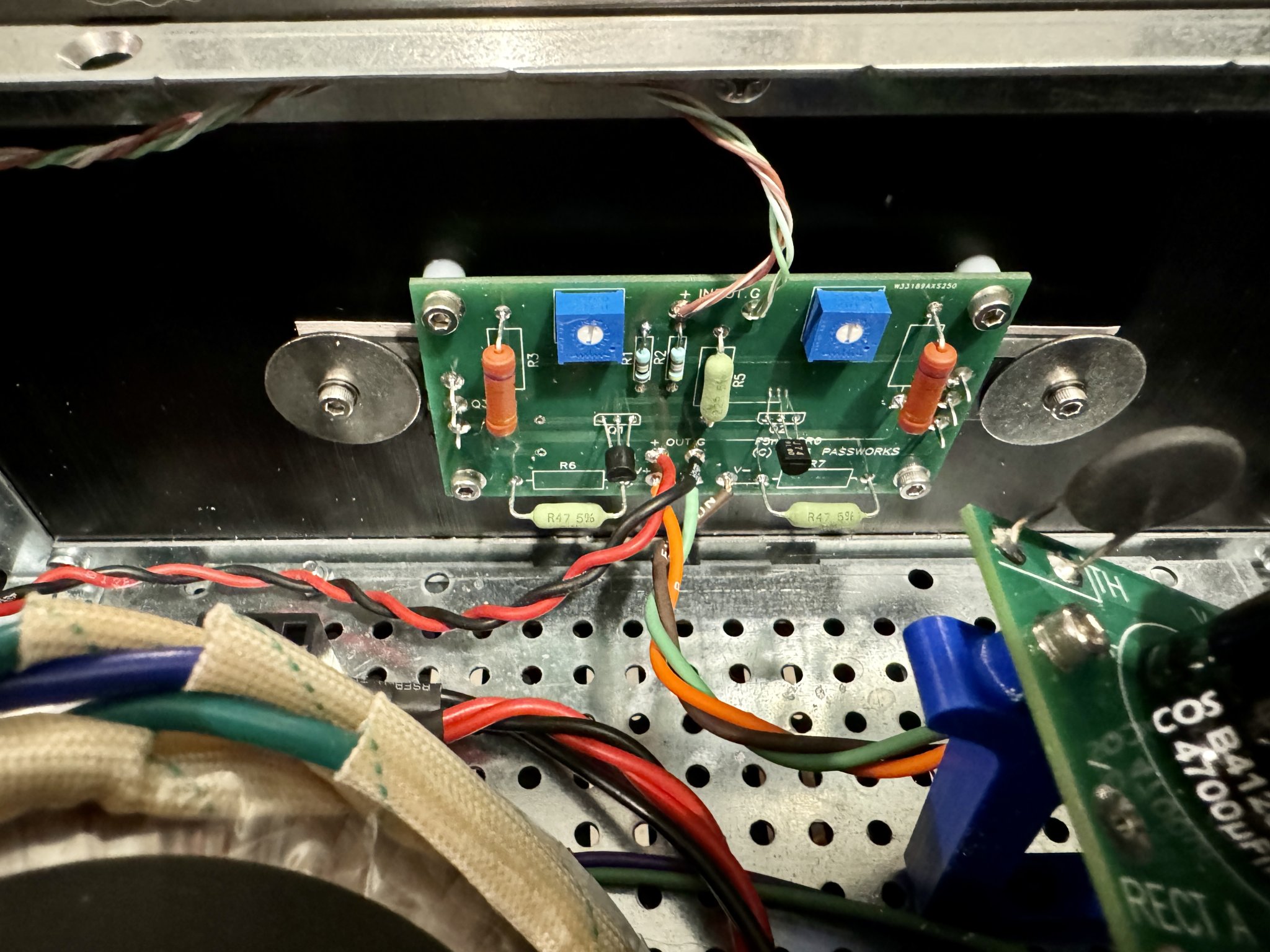

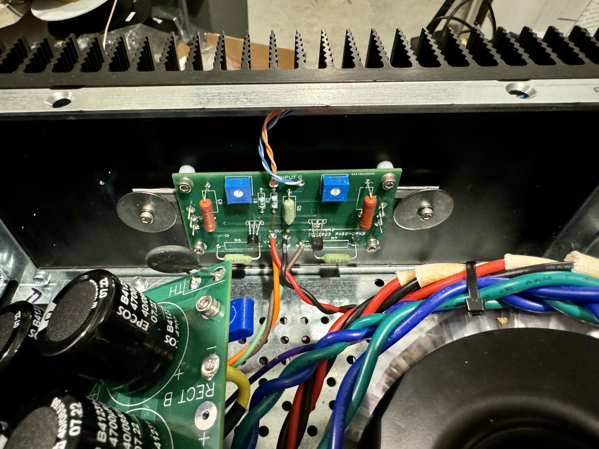

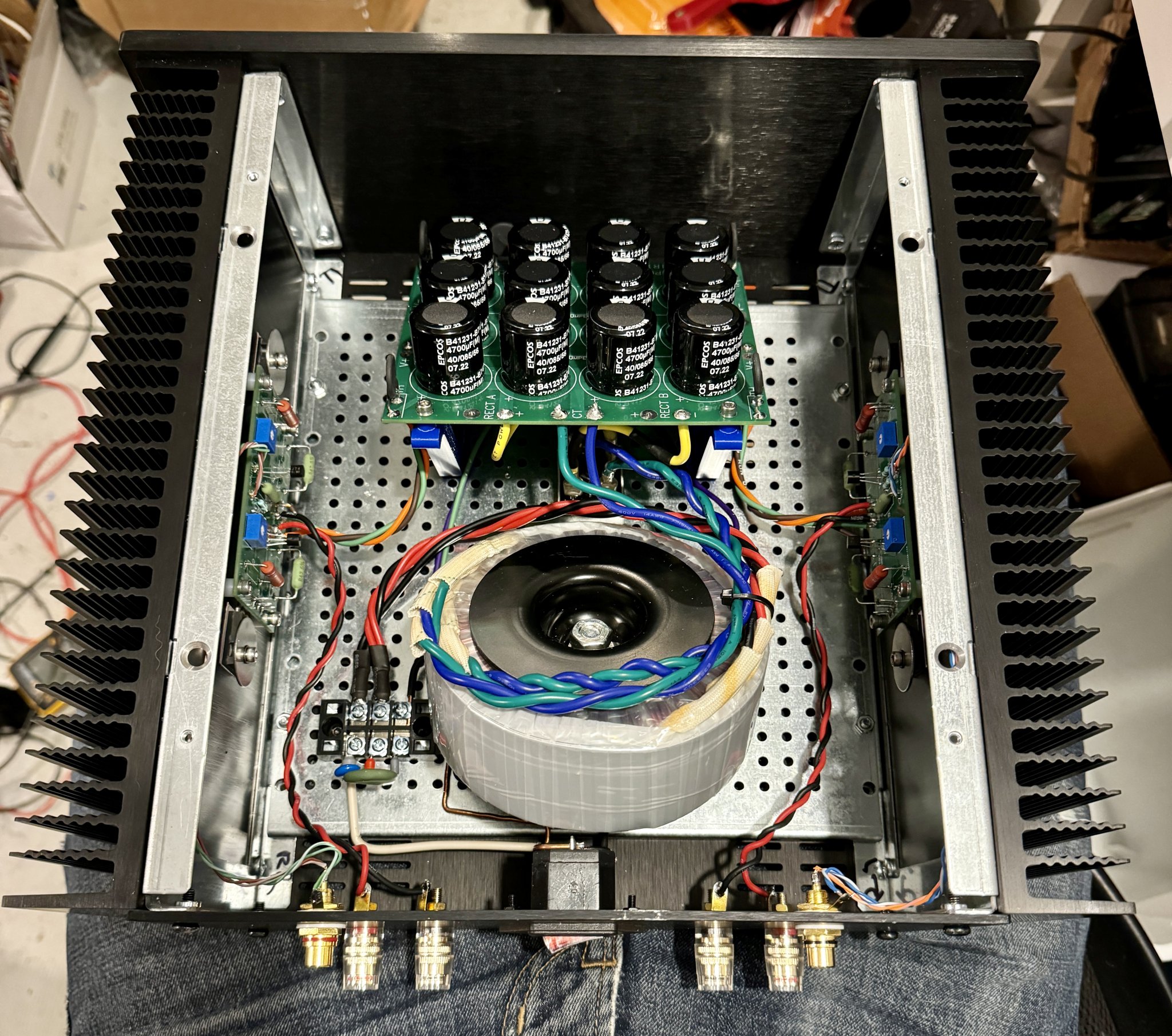

IMG_4412.jpegIMG_4408.jpegIMG_4406.jpegI was wondering about the power supply voltage when setting the bias. I ended up using the 200VA because the 300vVA being out of stock at the time. When setting the bias, I notice the supply dropped to around 21v. Is that expected from the 200va? I set the bias to around .5v and it sounds great. I will attach some photos of it being stuffed in the Mini Dissipante 3U chassis
Reactions: skidave
You can measure the secondary voltage. It should be somewhere around what the power supply is rated at if it is not sagging. I assume 18vac. Looking at the bias current, you should definitely be below 200 watts.
Next, you can look a the DC coming off of the rectifiers. You should see something in the neighborhood of around 24-26vdc. If the voltage going out of the power supply to the amp boards drops quite a bit, then you know your drop is somewhere in there.
If the voltage drop is on both polarities, then you probably do not have a bad solder joint. You can check the voltage drop across the thermistors and see if it is there.
Also, calculate the bias current.
For good measure, you can check the Line going into the soft start and after to make sure the drop is not there either but I suspect it is somewhere else.
glancing at the pics, it looks like a nice clean build. I don't see anything obvious poking out other than typically you would want the transformer at the front of the amp in order to cut down on noise.
