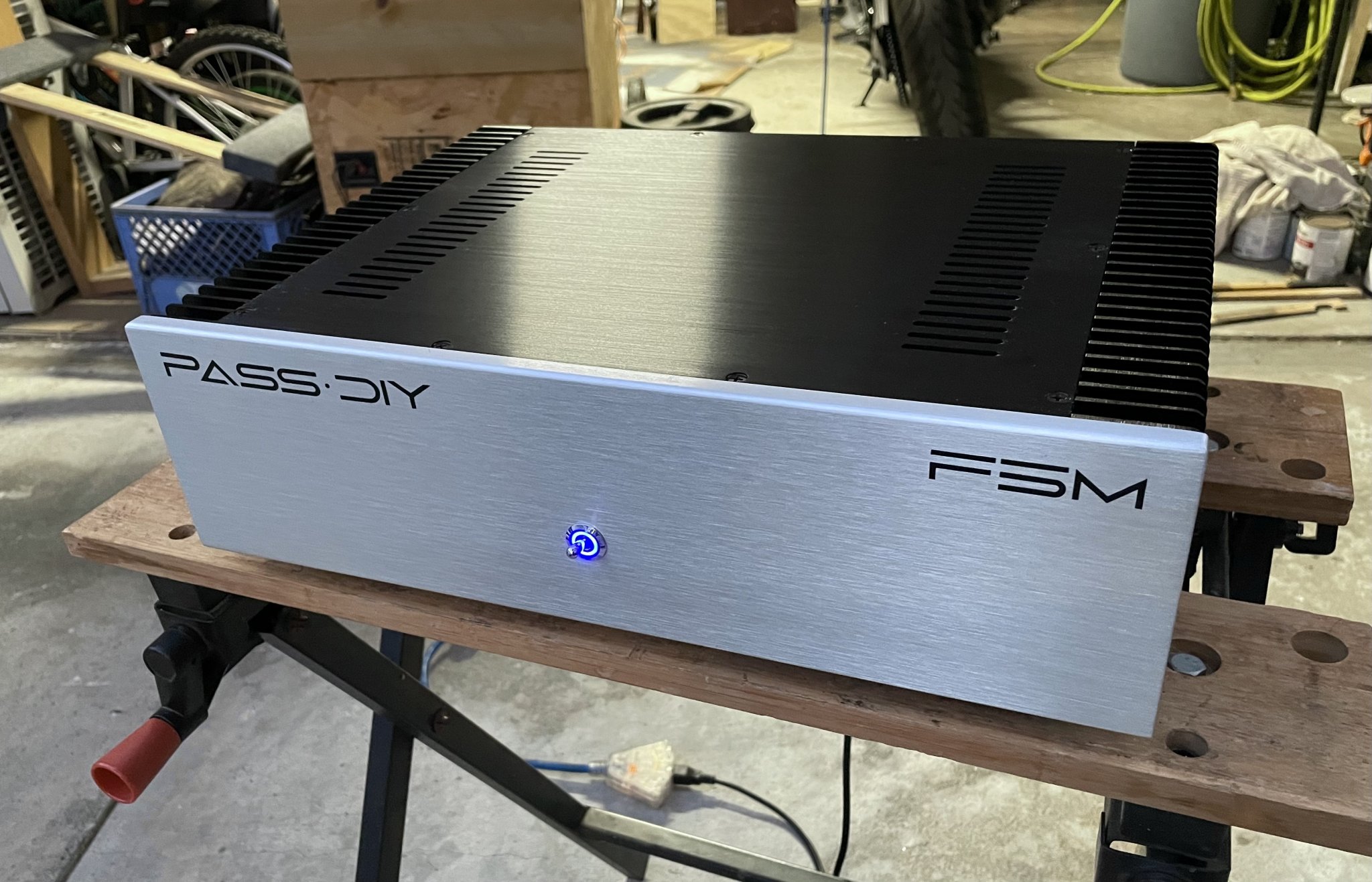

I got my amp lettered up! Here, look!
I wanted to do something non-permanent, so this is a vinyl transfer sticker. I used the free font "Abnes" and made up the text and sent it to Sticker Mule for a transfer sticker in black vinyl. It was about $20 (small qty, what can ya do). I shoved the text 4x into the standard sized sticker template, so if this holds up I'll prob give away the other 3 at Burning Amp.

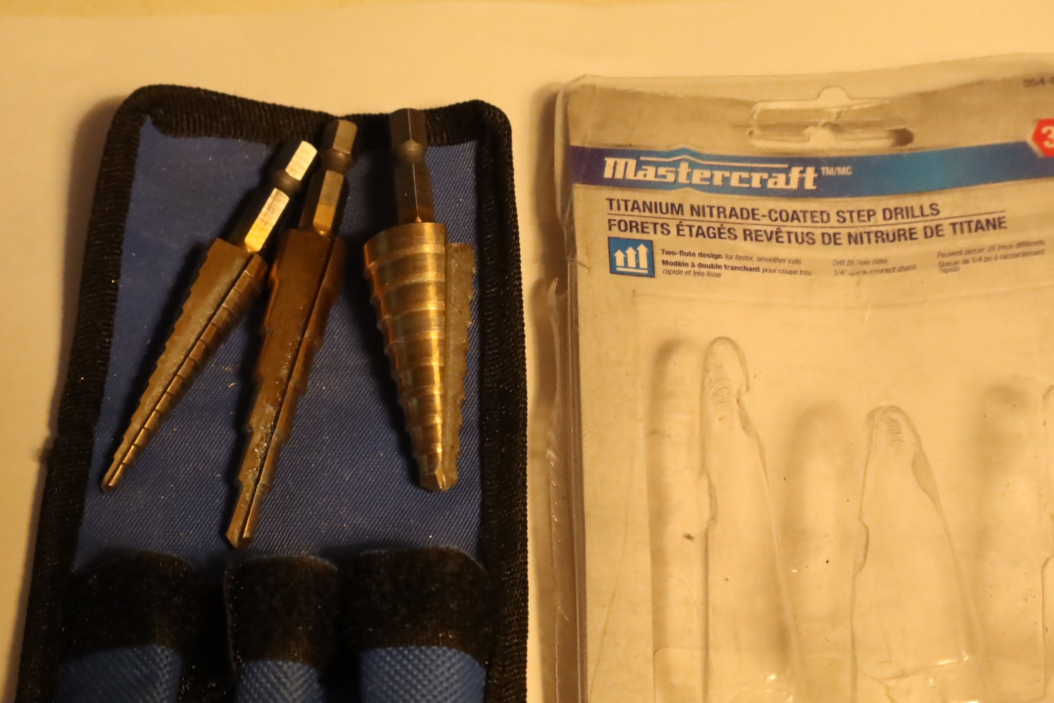

Drilling a hole for a switch is not difficult. I have done that with my amplifiers.
First cover the front panel with masking tape, then measure and mark the location. Next, use a centre punch and punch a dimple at the hole location. Make the dimple deep enough so that a drill bit will not slide out of the dimple. Then drill a pilot hole with a small diameter drill bit, say 3/16". Finally, drill the final sized hole with a stepped drill bit. If the front panel is very thick, it may need to be drilled from both sides.
As always, measure twice, and then check again before centre punching. Also work slowly and carefully.

Fancy-pants aluminum cases with big heat sinks love a thick front panel. Mine was 1 cm thick, which was too much for the switch I had. I used a hand router with a straight / square cutting bit to remove ~3 mm of material around the hole on the back so I could get the retaining nut on the switch.
Aluminum isn't too hard to work, you can do it with wood tools usually just go slow. It's easy to mar the finish on it, so be careful of that. I use some WD40 for cutting fluid when drilling stuff. Do you have a drill press? I would hesitate to try to do it by hand.

Good to know, thanks. I own all those tools too.
