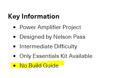

I received my 2 F5m kits including the power boards! I'll be ordering transformers/PSUs soon. Any suggestions on brands for various types of good quality wiring I should stock up on? What gauges should I have, and should I use stranded or solid core wire? I know sometimes the holes on the PCBs are a bit too small if the wrong gauge/type of wire is used.
There is no formal F5m build guide (yet).
Everything you need should be in the article and/or in this thread. If you run into any issues, helpful folks will chime in.
That's not a broken link... it's a page (as it says) that you found that is not intended to be viewed directly. Click the link / button at the bottom to go to the main store page.
Nelson Pass mentions a build guide, and I am basing my inquiry on this info. I purchased the kit assuming the guide was ready, but I can work without one.. Also, I do appreciate this thread quite a bit, but at the same time I notice many of the posts are not related to building the f5m kit. It's difficult to decipher a build guide from these posts. I did suggest we use AI to summarize posts/comments into something more digestible but was asked to remove it due to being too much off-topic. Although I do agree my post was a bit off topic ( I started the post stating so ), the thread seems to have been 'polluted' with side-info. Perhaps there could be a new 'F5m Build Guide' thread and we can start it there? ( specially seeing it is not out yet... )
Also, the build guide could be very simple. Just some simple steps on where to start. Over time, we can add more detail to each step. Step 1 could be ordering tools and wire. ( recommended tools and wire type, ie 16AWG silicone tinned stranded ) . Step 2 could be build the case, leaving screws loose until fitting all parts. I would now be on step 3. Ordering the transformer with some recommendations. I guess step 4 is building the power boards, step 5 amp boards, with special care to line up mosfets to heatsinks before soldering? Maybe having a link to another guide to start would help too.

^ @roboDNA - There definitely will be a formal build guide. Agreed, many threads veer off-topic. Nature of the beast I suppose.
What you could do (and many might appreciate it) is to start a thread specifically for your build and document it along the way. That's what Jim (6L6) did for a number of projects and started the wonderful build guide trend. If folks veer too far off topic, you can report the posts (per forum rules) and have them removed / moved if you like.
In the interim (knowing that it's tough to gauge just exactly how much guidance you may need) or how many similar projects you've built in the past ... As it notes, this project is intended for "Intermediate" builders, but IMO, if you're careful and ask questions along the way when you run into any obstacles... it shouldn't give anyone issues.
A basic build sequence may be:
Build and test your PSU. Validate that you have roughly +- 24VDC (it will likely be a little higher with no load). A dim bulb tester and/or Variable transformer are wonderful to have. I didn't build the exact PSU included with the kit, so any pics I'd show may add to confusion vs. help.
Stuff the amp PCBs minus the output MOSFETs. Some folks also like to connect / solder their DC supply wiring and I/O wiring to the amp boards before they're mounted to the heatsinks. My advice is to leave the wiring bit long if you do. There are a number of completed board pics in the thread to show some examples.
Mount the amp PCBs / solder the output MOSFETs.
Connect and test one amp channel at a time. Rough in the bias and offset. A number of people have mentioned various ways they prefer to set the bias and offset. Again, a variable transformer and/or dim bulb tester may be nice to have. Make sure to watch the bias closely at first power up and ensure you don't have it cranked all they way to the "max". As many have noted, the single-turn pots make dialing it in a little "sensitive". Go easy. Nelson's article does a really nice job, IMO.
Button it up in the chassis. Set final bias and offset at temp equilibrium.
Ask as needed for any clarification. Not sure how much detail is needed.
Jim also posted some really nice shots of a completed amp, and I likely have photos showing most things if needed.
Go slow... have fun.
