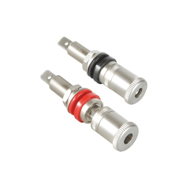

I bought to my F5m amp these nice looking Jantzen Premium Binding Posts M9/26 Satin Nickel model 012-0220. How to solder wire these things? I filed the connection area but still my tin is not getting to it very well with a cable. Do I need to use some special soldering flux for these? Right now my soldering looks really fugly!
Bigger and more solid soldering tip for greater heat capacity is equally important.
Too high a temperature will cause the flux to char and will cause more problems at the soldering process than it will improve.
But by using push on connector the issue will be soved.
They may need scuffed up a bit. That with some liquid flux and of course the right amount of heat.
I use the push on connectors a lot but add just a dab of solder to both parts and cover it with heat shrink. I can always split the heat shrink, add some heat and remove the connector. Seems to work very well. Good luck!
Okay! That gives me some ideas to play with. Thank you 🙂Think F7...

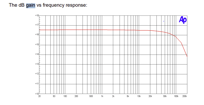

What would be the max input voltage to F5m? Right now my tube amp has a lot of amplification.
Any ideas and thoughts about that hum kind of noise?
Does the F5m hum with any other pre-amp or is it only with the tube pre-amp. That may help determine where to look next.Any ideas and thoughts about that hum kind of noise?
Every build will be a little different. The chart above is from Nelson's article noting the typical gain of the circuit.
You know what your V+ and V- rails are...
The Vgs of the output devices is probably .... about 4V or so ... I often use 4V to include other losses as well. It's an estimate... and each MOSFET is different .... as are the losses ... Let's call 4V the "fudge factor".

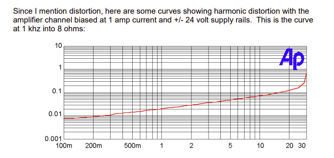

Rail voltage - the fudge factor => ~Vp. For a typical build, let's estimate it at 20Vp
So... the maximum voltage output will be around 40Vpp. That also aligns with this chart in the article... if we assume voltage clipping at ~25W is what causes the distortion to rise dramatically.
With the gain... and the max voltage output, you can calculate the "input sensitivity", which I think is what you are actually asking for.
Max voltage output (Vrms) / gain multiple => input sensitivity
You can do the arithmetic .... or... you can just measure it with your DMM.
That's a long way of saying... You can put 10V IN if you want... but the voltage OUT is the limit.

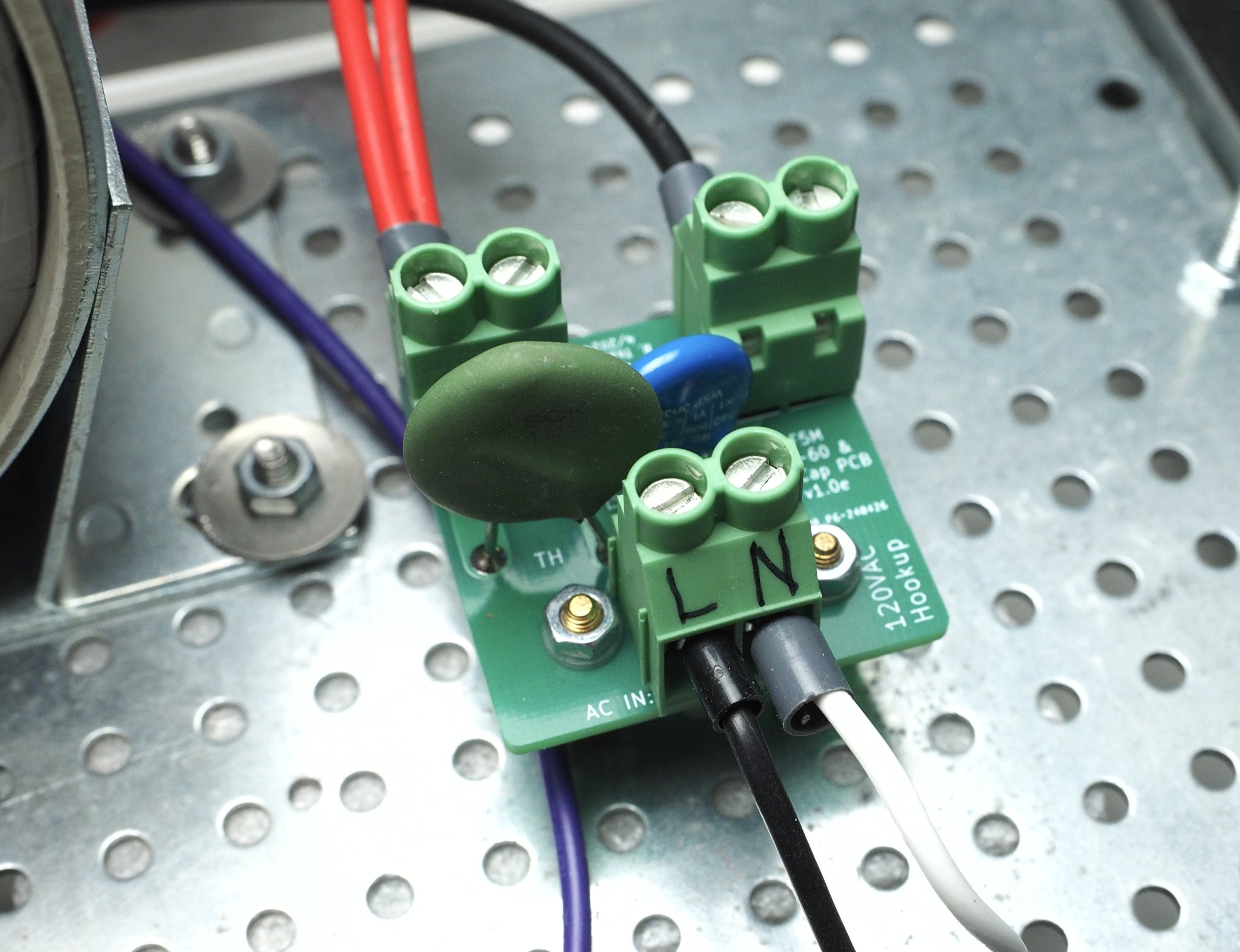

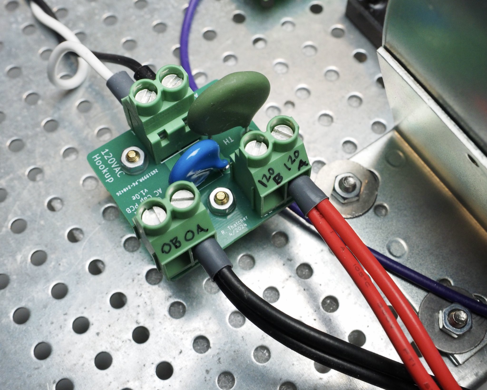

What is the best way to terminate wires to the pcb pads? Should I use my newly acquired Hexagonal Ferrule Crimping Tool to add terminals to the ends? Would anyone know what McIntosh or other manufacturers use so I could consider using the same method?
^ I don't know what McIntosh does.... First Watt amps (that I've seen) have the wire directly soldered to the PCB.
I do not recommend using "bootlace" ferrules with solder.
