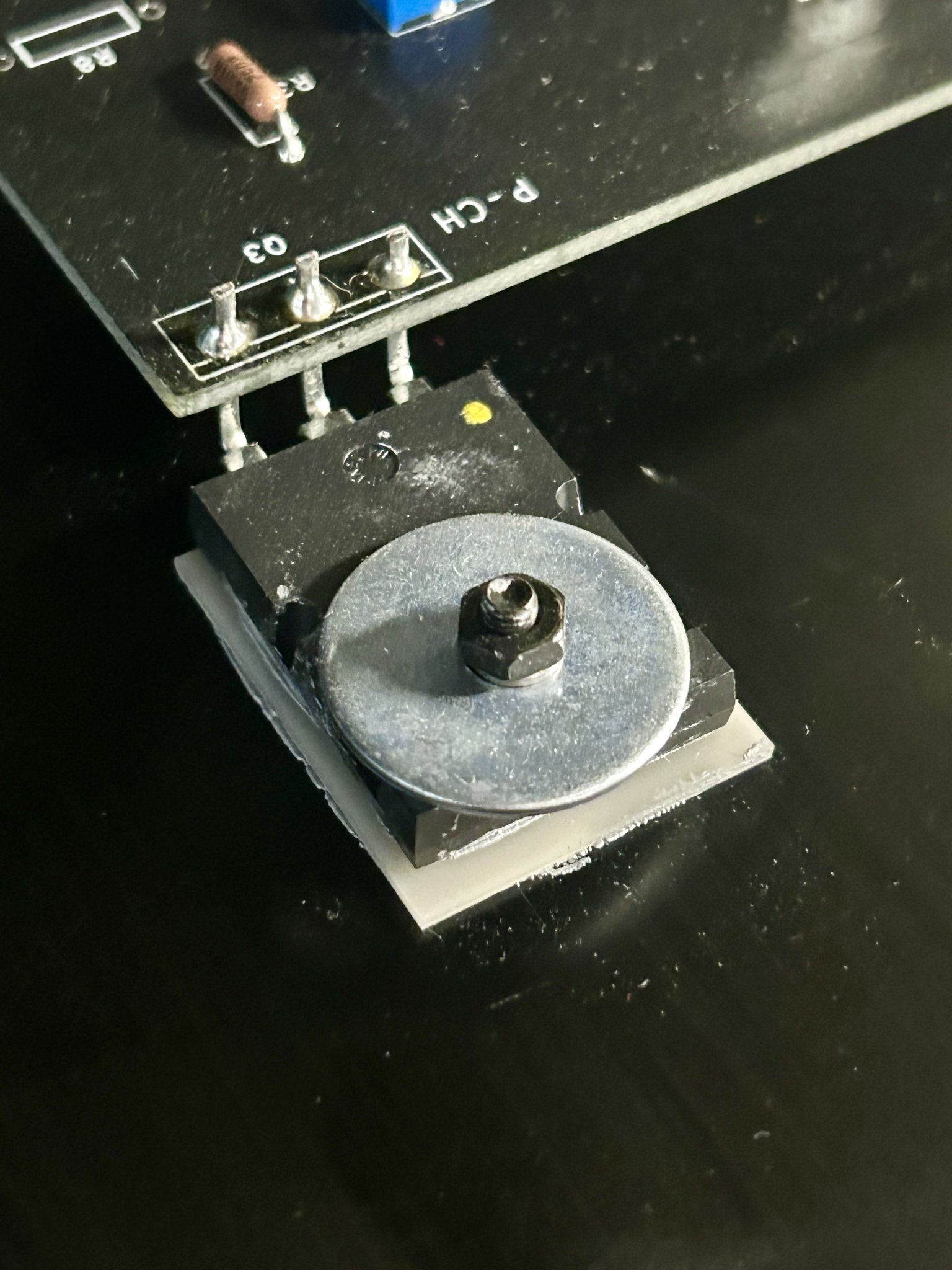

Just to be clear, the low performance silicon pads I measured did not come with the F5m kit, they were a purchase from ebay as a base line stock buy, but I didn't look into it further for improvements, so that is my fault entirely. I presume and hope that other proper branded soft pads and those with the kit are better. I hope I didn't cause any confusion.
I also bought lots of mica washers cheap, but didn't use them either. I'll stick to these ceramic pads and paste in future. Thanks again.
Reactions: Mikerodrig27
Aluminum nitride ceramic interfaces and goop worked really well for me with the F7ish boards I got from another member.

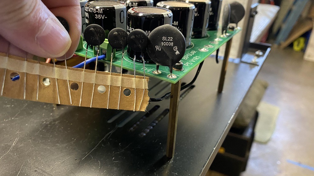

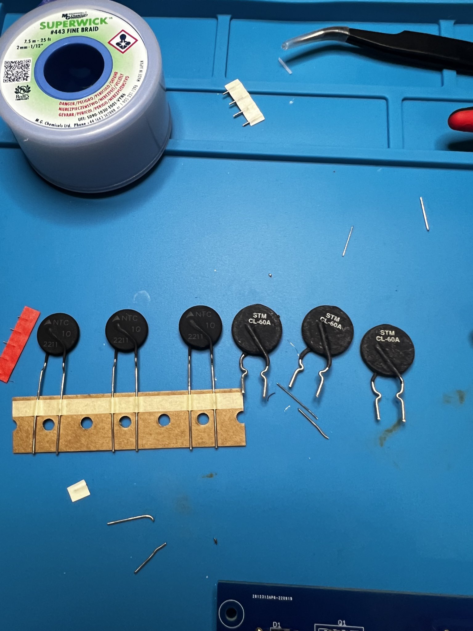

Your question is a bit confusing, which ones are the ones you ordered and which are the ones that are installed on the PSU?
What's on the board now is what came with the kit. The writeup mentions an alternative part, B57236S0479M000, which I ordered and are on that cut tape, in case you were planning on running higher bias levels.
I went ahead and ordered a bunch, and they just seem kinda weenie. Maybe they sent me the wrong ones.

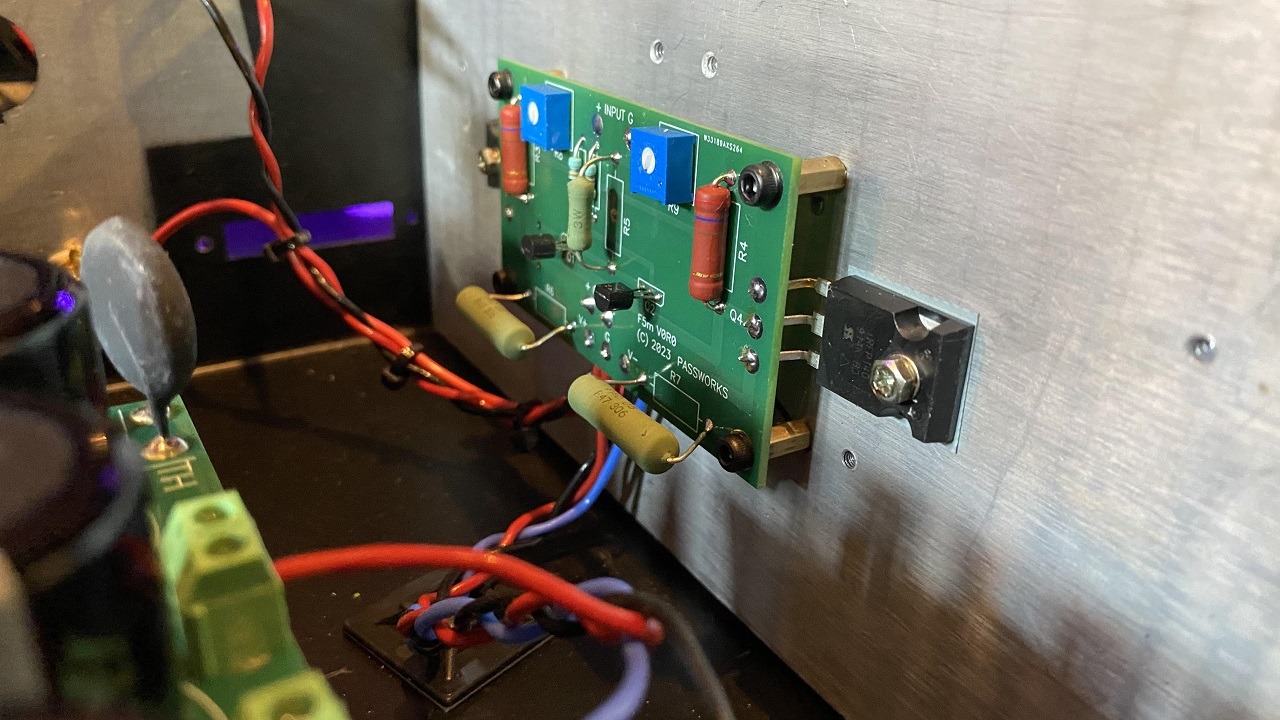

Also, I noticed in the write up, something to the effect of R3 and R4 could possibly be combined, but opting for a 5w part seemed excessive.
Well, I dunno about you guys, but on mine, R4 and R3 are cool as a cucumber, it's R6 and R7 that get smokin hot, so I decided to throw some 5w parts in there. They still get warm, but at least I can't smell them.
I used the Epcos B57236S0479M000 for my build per Nelson's F5m article when I realized I wanted to run higher bias current and the 10ohm thermisters were not recommended to be used over 1A bias (I used a 4U/300 Deluxe chassis). Don't worry about size difference, the Epcos are still rated at 7.5A. The whole point is they get hot and resistance goes down after preventing inrush due to capacitors charging on power on.
https://www.diyaudio.com/community/threads/f5m-kit.408290/post-7637342
For clarity, the CL60 @Jacruzer787 posted above were intended for the @rhthatcher PSU/AC-In boards (or the store V3 PSU), not F5m PSU.
