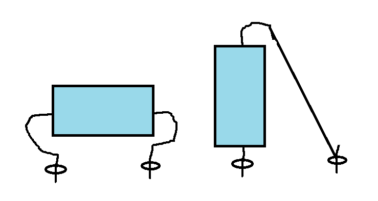

3W power resistors are fine. Just check that their lengths are not longer than the lead spacings on the PCB.

There should be enough space to do this if needed:3W power resistors are fine. Just check that their lengths are not longer than the lead spacings on the PCB.
