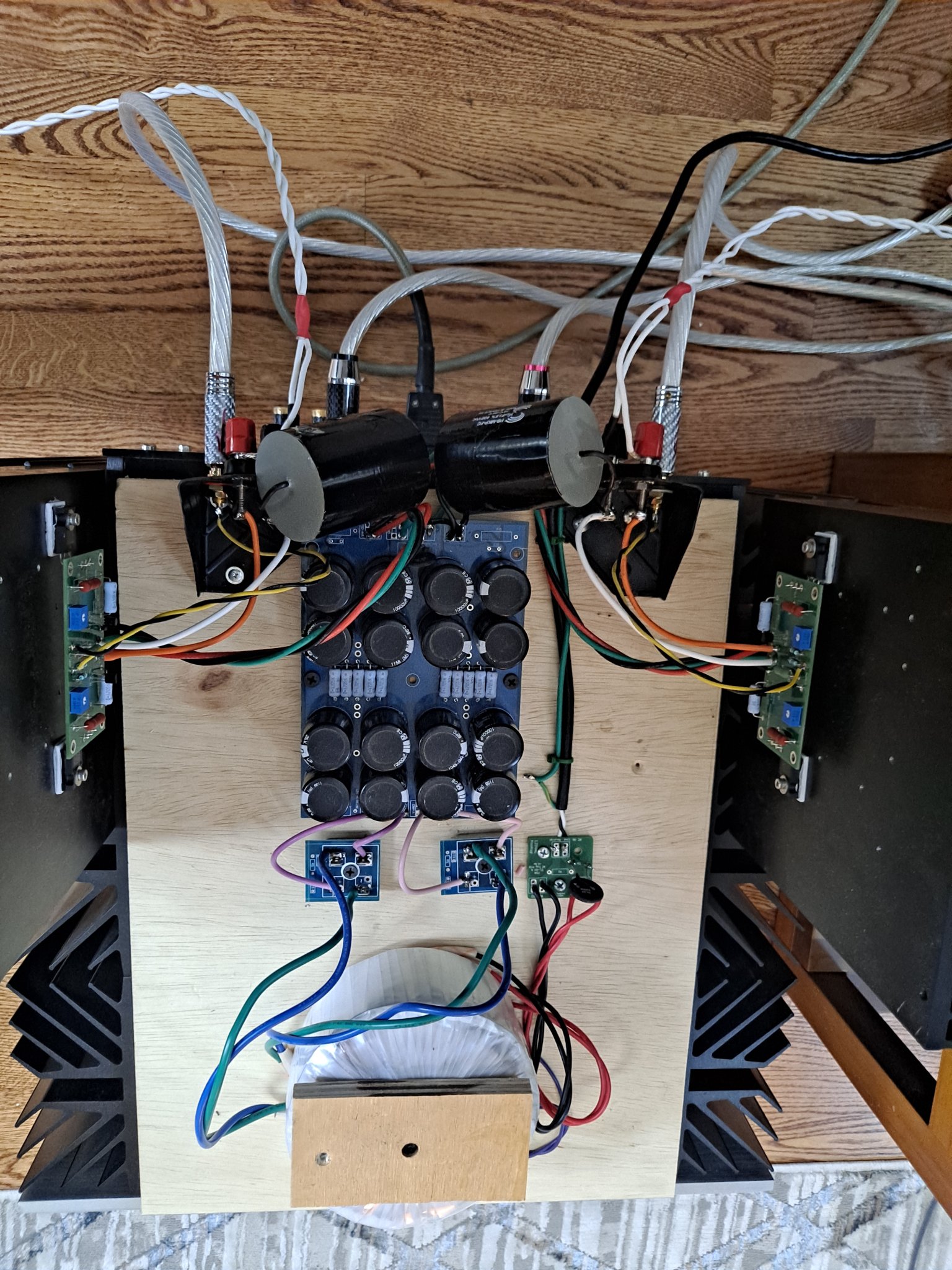

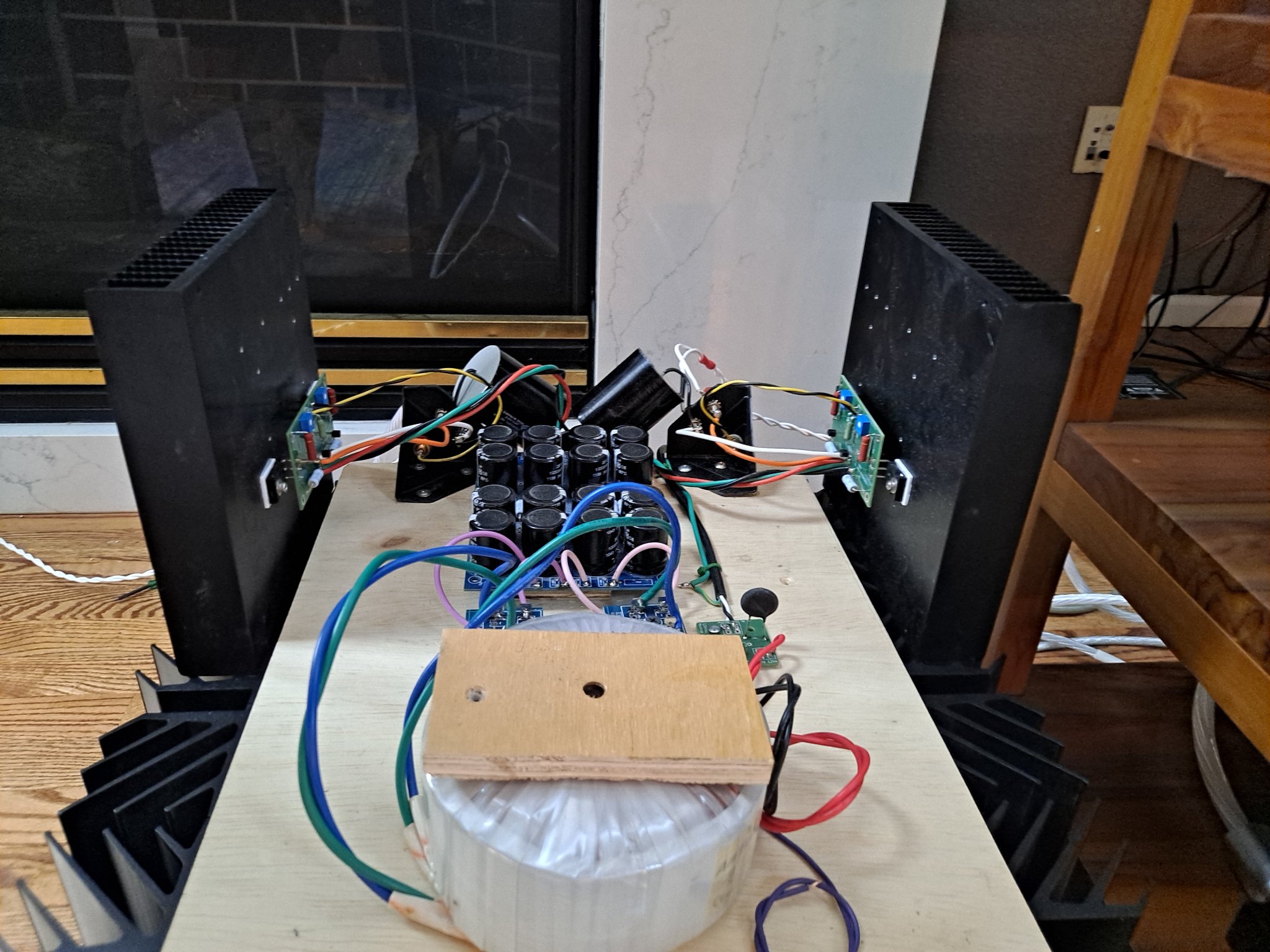

So I built my own Rawson version of this amp and It is deadly! It is simply a test setup. All of this will be tossed into my dads old Aleph clone pretty soon.
I am very impressed with it. It sounds fantastic! Lots of detail and air which is really awesome! I will say, there is something to be said for a simple complimentary JFET pair feeding a couple of tired puppies... I added some 70uF film caps to the final stage of the PS so I could keep... Ahem, "testing" the amp... With my janky setup, there is absolutely no noise coming from the speaker! I can put my ear up to the tweeter and get nothing. I must have grounded the wood properly.
Things are sounding great! Wonderful imaging, lots of mid and high frequency detail, deep soundstage, no grain etc. Smooth but not dark or dull. It isn't the most dynamic amp that I have heard but it is definitely not lacking in dynamics for such a small amp. It isn't lush like an Aleph. The bass is tight but doesn't make a point of itself.. The mids and highs are the focus of this amp. The amp has a sofness to it while not feeling like it is giving up deatil.
You know that an amp is good if you are listening to it quietly at night time. All the noise has settled for the day. Then you close your eyes imagine yourself walking into the music. I think I will "test" this one for a while. I do have a couple of questions:

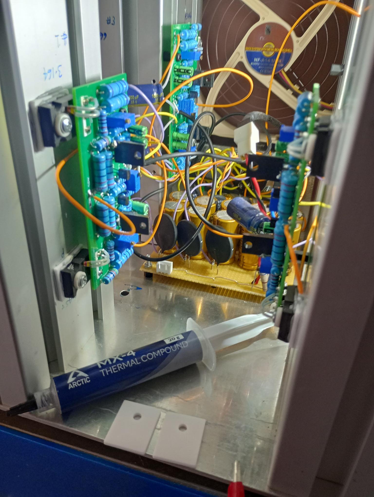

I've just changed pads and measured temps on one mono block channel to see what difference the ceramic pads would make to the elevated temperatures I was measuring on o/p devices with vertical sinks and fan case (see post 1,888).
I can confirm that the ceramic pads with Arctic MX4 paste have reduced metal tab temps on the devices by 22C, while increased h/sink temps close by devices by 10C. That is quite an impressive improvement, and brings device case temperature back down to reasonable levels.
I hadn't realized how poor the performance of silicon tabs could be at these power levels.
Thank you very much to Mikerodrig27 for the recommendation in his post #1,899 ! Now I've got to do the other channel today.

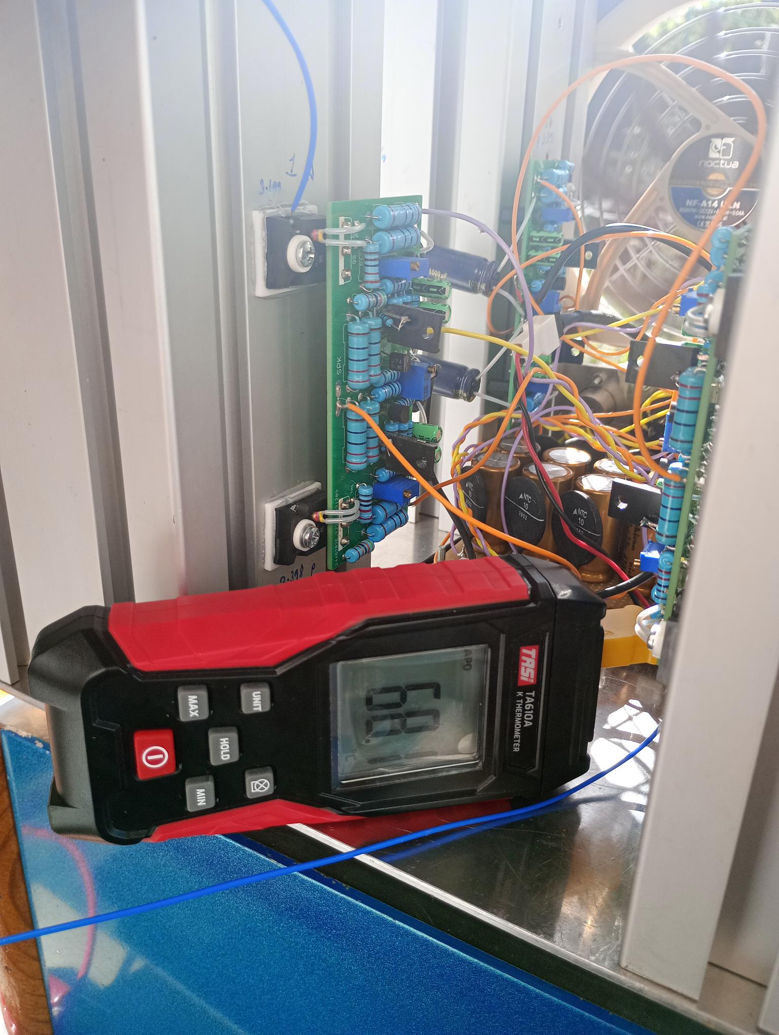

Any comparison with the Keratherm pads vs. the Aavid / Arctic MX-4? I see there is also a MX-6 product that claims "20% lower thermal resistance" Would it be better?
I'm using a thermocouple contact probe & meter. I'm touching the probe from above onto the exposed metal back of the devices. In this photo attached the metal tab is measuring 68.1C and ambient temp is 32C at bias of 0.8A and +-27V rails, the amps is outside here after swapping to ceramic pads, so it's probably benefiting from a little extra airflow in the breeze.
I wanted to also ask what you think the temperature of the metal back should be as 1-reasonable, 2-high and 3 -too high ?
I got the recommendation for the insulators I believe from Tungsten audio. The thermal goop was just research looking for decent bang for the buck.
I had a couple of mica insulators fail to insulate which was part of the decision for me to switch to these ceramic insulators. Now I don't have to worry about it.
I am surprised at the performance of the ones that came with the kit. I wonder if there was an issue with them.
