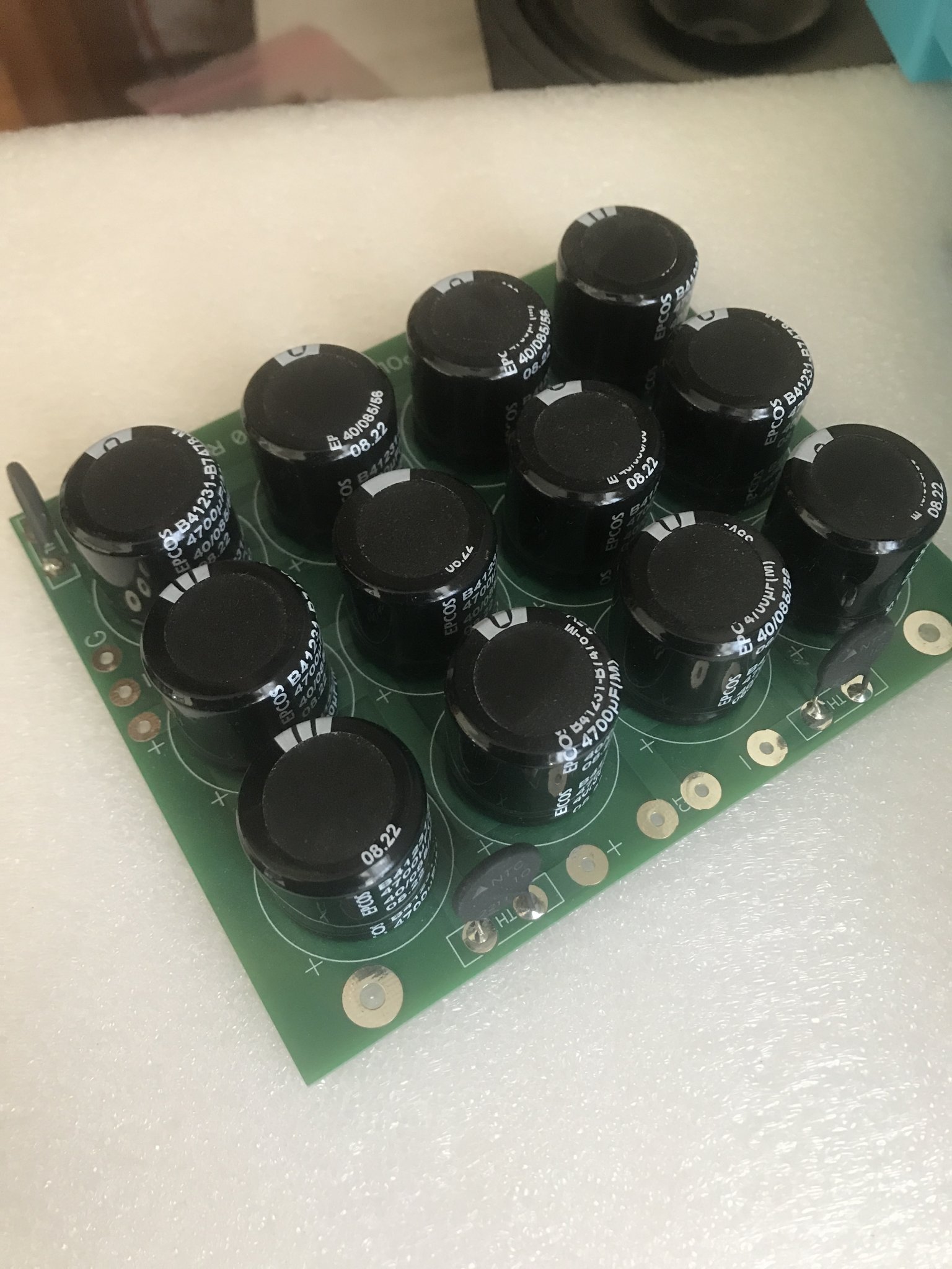

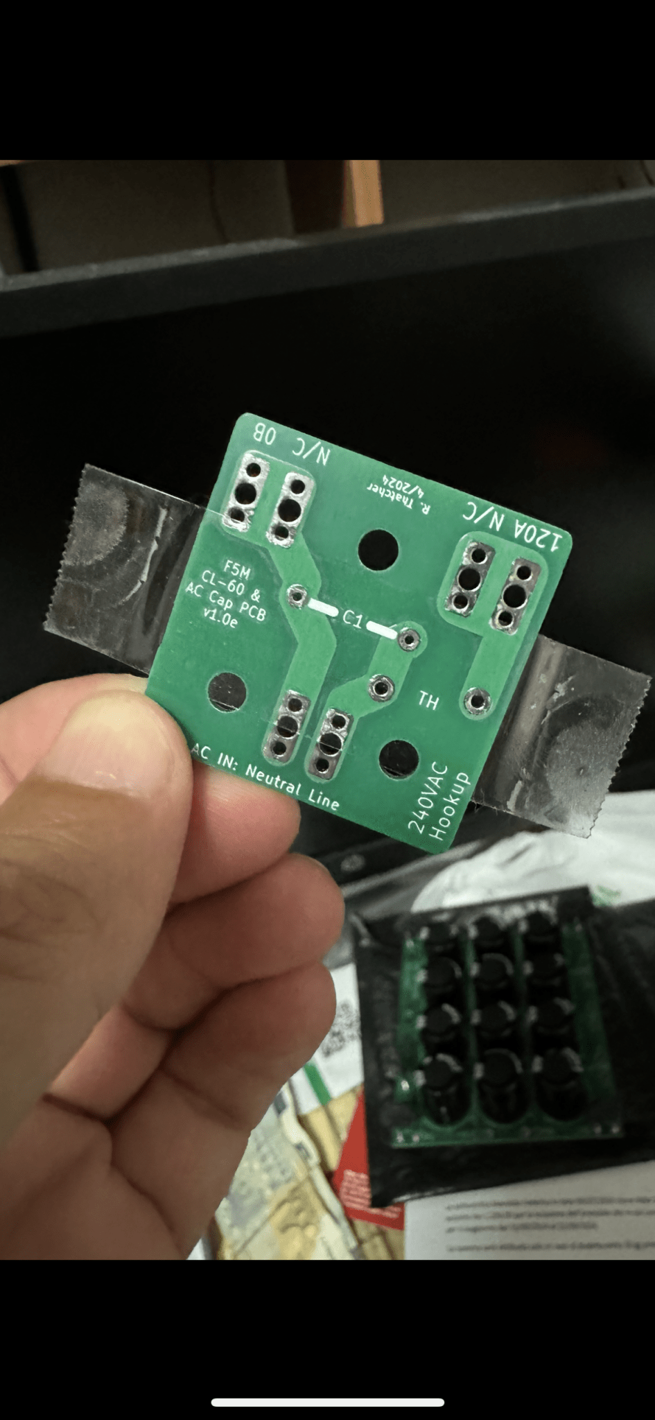

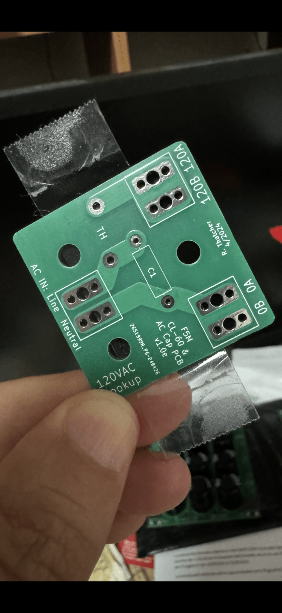

Hi guys,
Do you know how to use these pcb? I’ve got them with the Diyaudiostore kit, but I’ve never heard anyone talking about

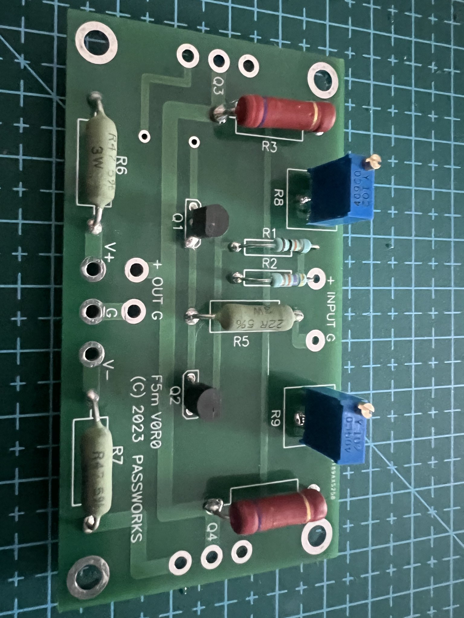

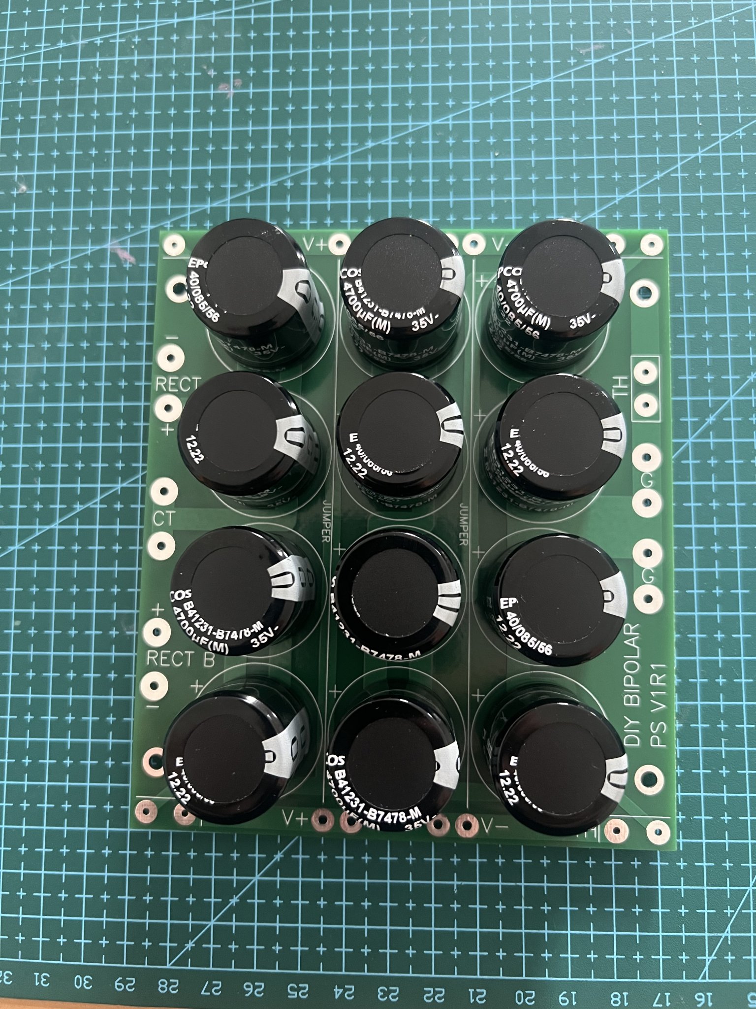

Hello all, (sorry in advance i'm really a dummy in electronic)
i have start welding and...
i have V1R1 power supply wich i have receive with my kit. But i have order exactly the list from Nelson in his file at first post and i see on this board there is 5 place to put thermistor and in the list there is only 3? it miss me some ?
it have been forget to be replaced in the list of nelson....
there is some other thing that it have been changed?
i have change the trimmer by these one below but i have been forced to bend the paws if i'm right....
https://www.digikey.com/en/products/detail/bourns-inc/3296Y-1-102LF/1088084 Try this if you would like a multiturn version. Check the Datasheet for exact dimensions and specs. It is linked on the page. There are several configurations available, including straight pin, triangle pin arrangement, top adjuster, side adjuster, etc. choose one that will fit your board.
in your opinion all is ok?:
