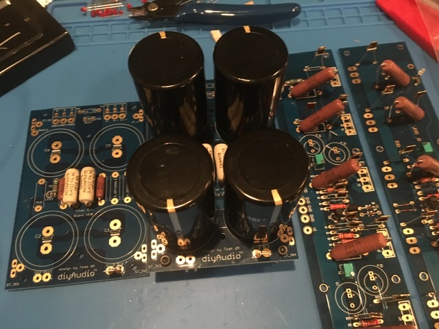

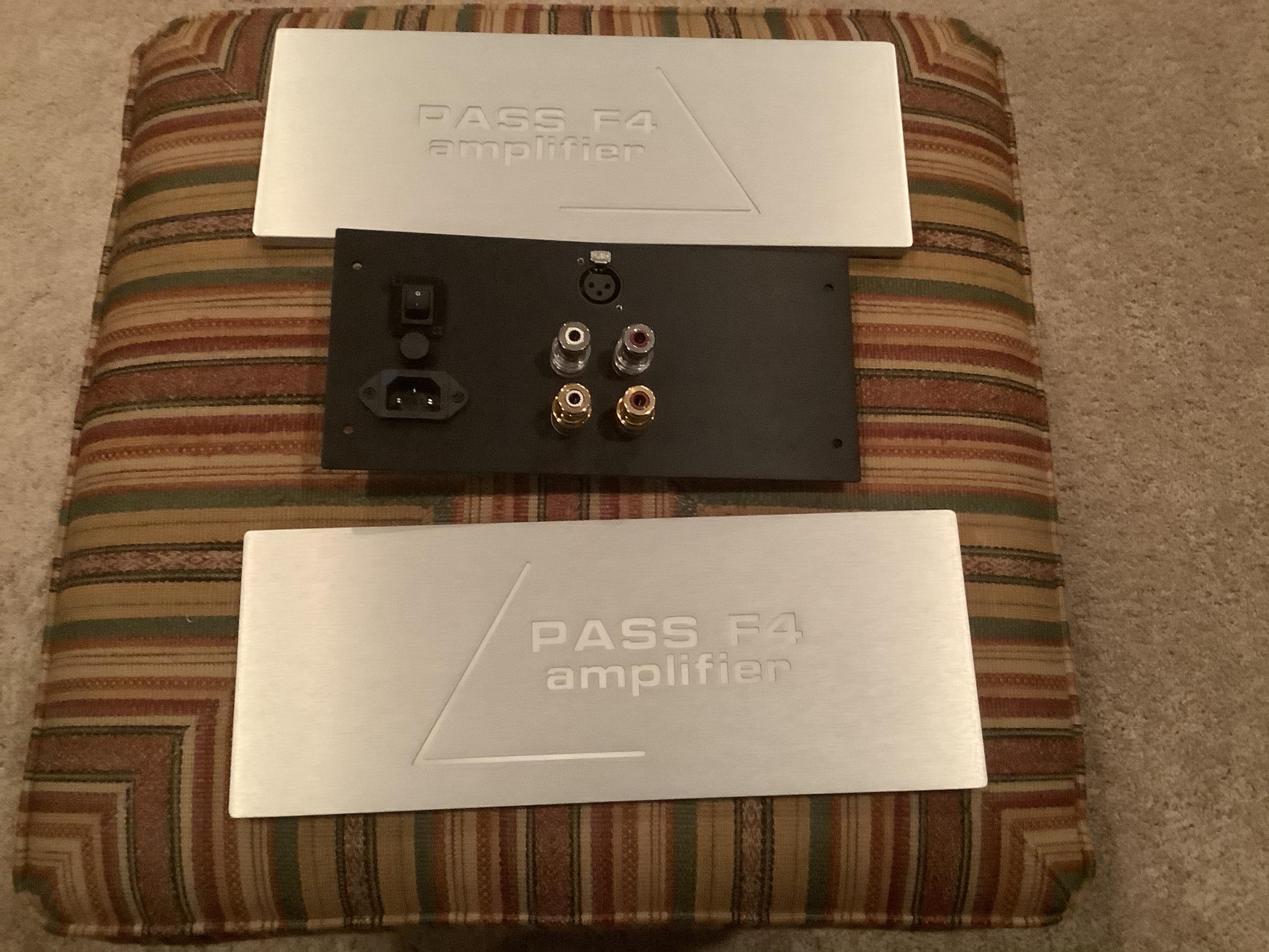

My F4 Build
Sharing some pics. Just got my Mini Dissipante chassis from Hifi2000. They did a nice job on a customized faceplate🙂
Another pair of F4’s coming alive soon😉
You've built a great RF-reveiver with those foil-resistors >1cm away from PCB with a "loop"-antenna... It's better to form the leads with two fine pliers so that the leads are as short as possible.
I am planning on building a "maxed out" F4 with the z-foil resistors too. Nice to see an example and get some feedback on how best to install.

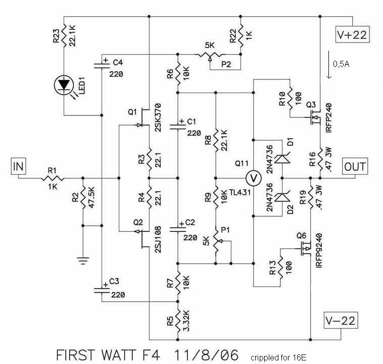

If I build this crippled version of the F4 to drive some headphones, do I really need R47 source resistors? What's the lowest value I could probably get away with in the case of a single n/p output pair?
Also, I'm considering building it with FQA19N20/FQA12P20 outputs, but that shouldn't make a difference in regard to the source resistor choice I suppose.

The goal is a scaled down F4 with fewer output pairs, hence I arrived at the crippled F4.

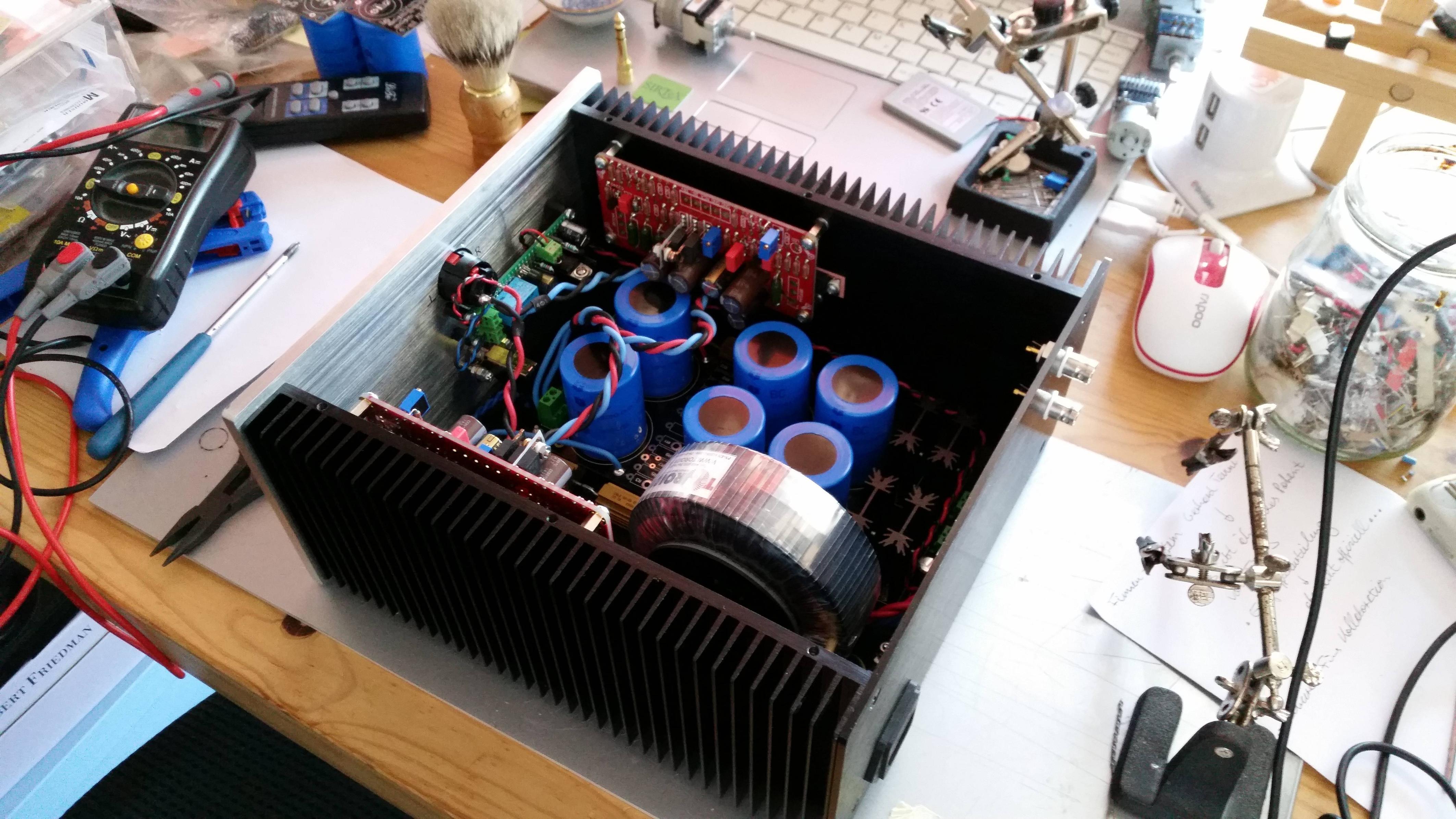

The F4 headphone schematic as seen in post #3026 F4 power amplifier may be what you're referring to, ZM? I still prefer the bigger output FETs.
I already have a case and PSU from my Aleph H build (see attachment), and a 18VAC 250VA transformer, plus a pcb and all the parts for the F4. If I read my notes correctly, the Aleph H currently conveniently dissipates something like 20W per channel, so the +\-22V @0.5A each should fit the current heatsinks nicely.
The amp will drive a HE6 headphone, with a ruler flat 50R impedance. The F1J drives them nicely. According to innerfideliy, the HE6 takes 1.018Vrms to reach 90dB SPL. Vrms=Vpk*2^-.05 and thus Vpk=1.44V. Ipk=Vpk/R and thus Ipk=30mA, roughly. With 6dB of headroom we're at almost 100mA.
then make it s you wish
looking at FQ datasheet, I believe you can make it without source resistors ..... but with them , you'll have lesser difference both in Iq and output offset , cold vs. hot

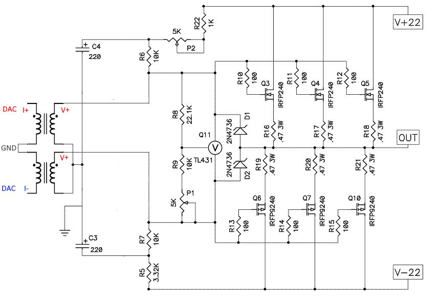

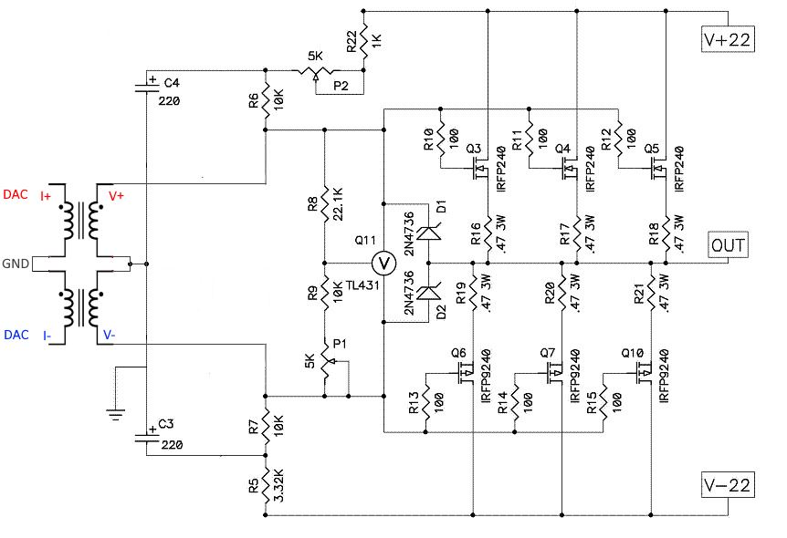

I am building F4 amp. I have dual mono ad1865 DAC with output transformers doing I/V conversion.
How to connect my dac to F4 to skip AC C1,C2 coupling caps?
Could guys help with this? Do you see any drawback of such approach? Which schematic is correct?
