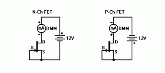

I have two pairs of Toshiba 2SJ74GR / 2SK170GR Matched lost in the box, I can use it to build an F4 Amp. or have to be BL grade.

What are the resistances that you speak, are the 0.47 R -3W ?. Don't tell anyone that I asked this, I have an F5 running for 3 years and I don't understand much of it, but I know how to weld well.

ref. to sch in post #3 , make R3 and R4 0R , both

ZM, those are the resistors for degeneration right?
If I got it right from NP’s latest BA talk.
Do you have a rough rule of thumb for a good matching level between Jfets for taking out 22.1 Ohm source resistors?
