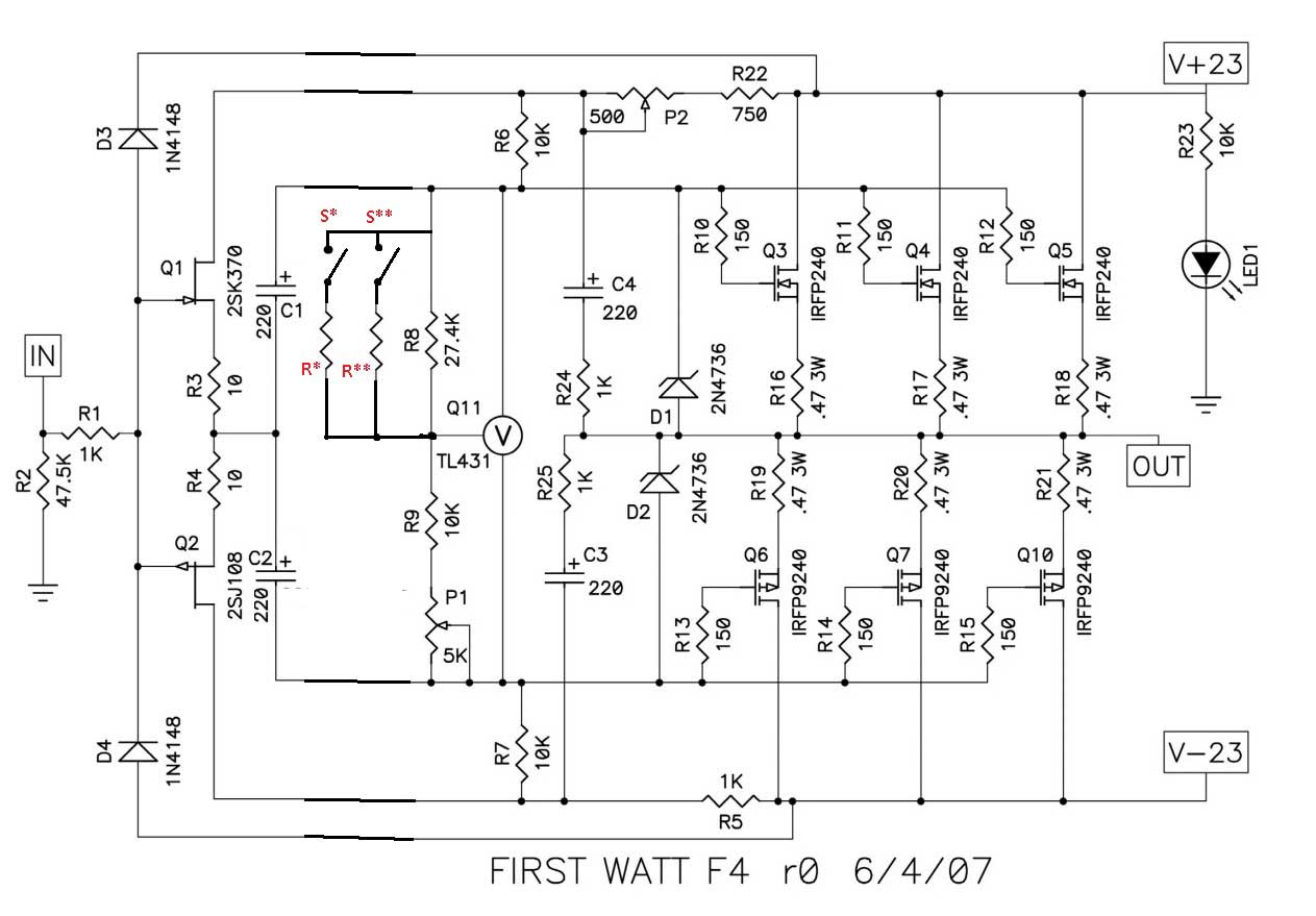

No hurry Zen Mod. I just wanted to know variable resistor idea could work so I could settle on the holes needed in front panel.
I’d appreciate any knowledge on what a typical resistance range is needed to change bias by 100 to 150 mv...
Rob
S* and S** - whatever you fancy - nice switch(es) or relays controlled with switch(es)
include R* - first lower Iq step
add R** - second lower Iq step
you must get values experimentally - per your wish
with relays - you can wire them Normally On , so lowest Iq if relays aren't energized ........ or the other way
I'm not commenting do you need entire thingie or not , even if I'm using my Papa's Koan almost every day in my workshop , rarely going above 500mW
