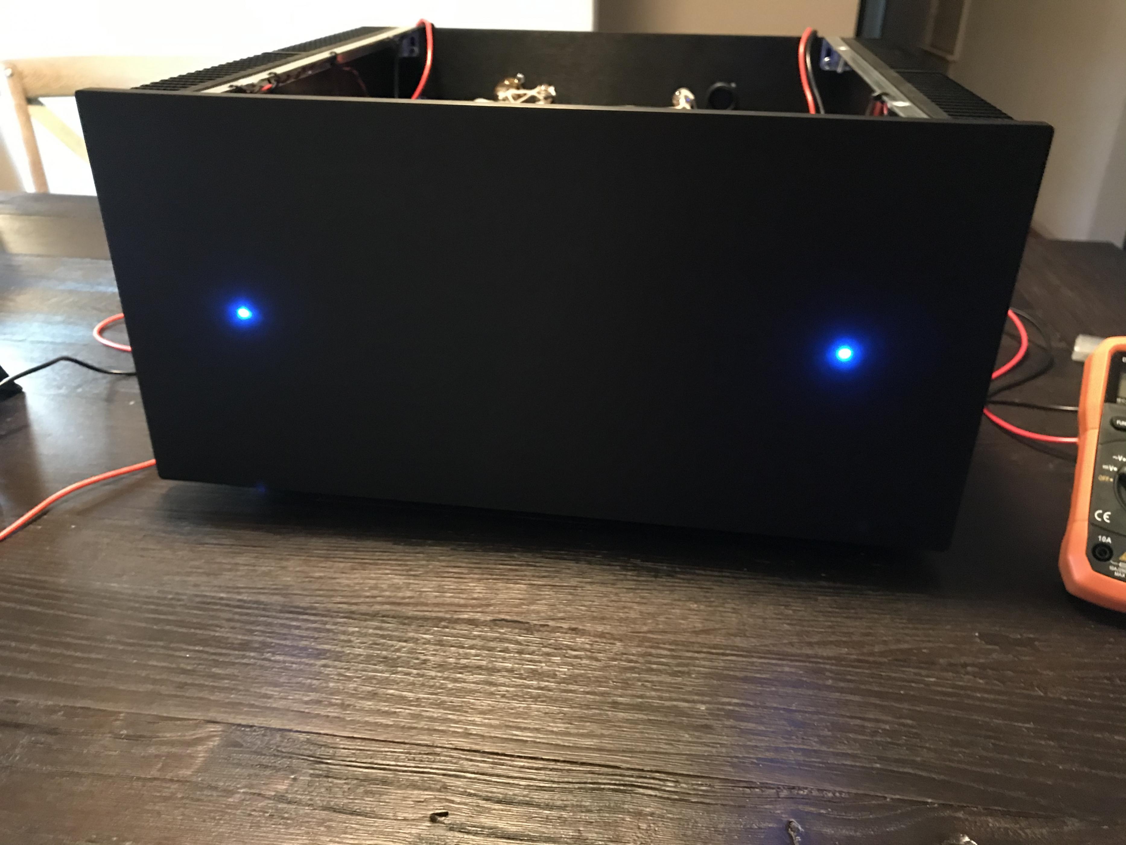

After my dad lusting over my M2x for months I just gave it to him for Christmas. Since I had an open space on the shelf I decided to build the F4 and damn this one is dope. Me like!!

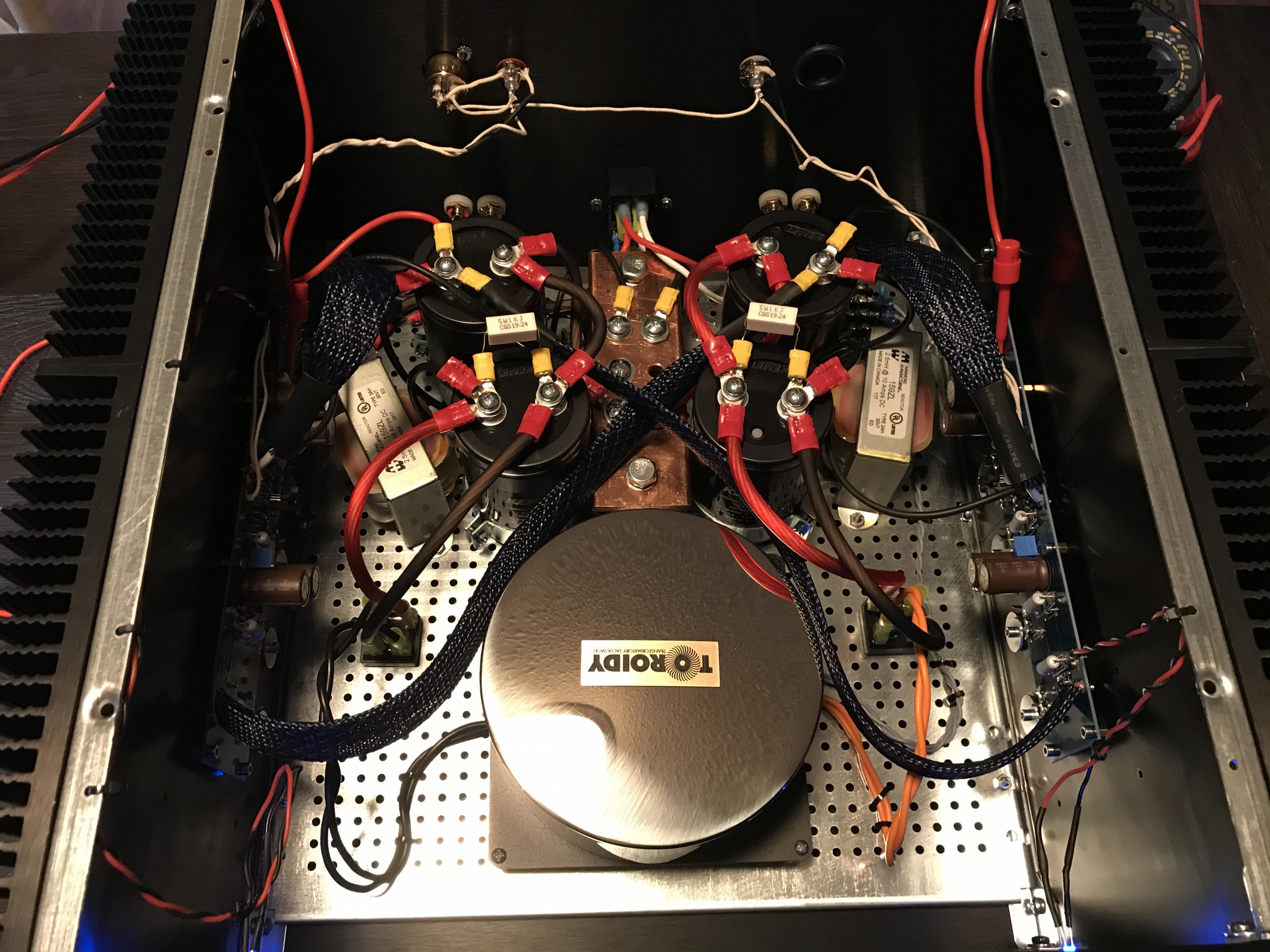

I noticed your toroidy transformer...there’s a dude asking questions about them in the M2X thread post 2731. Maybe you could follow up with him.

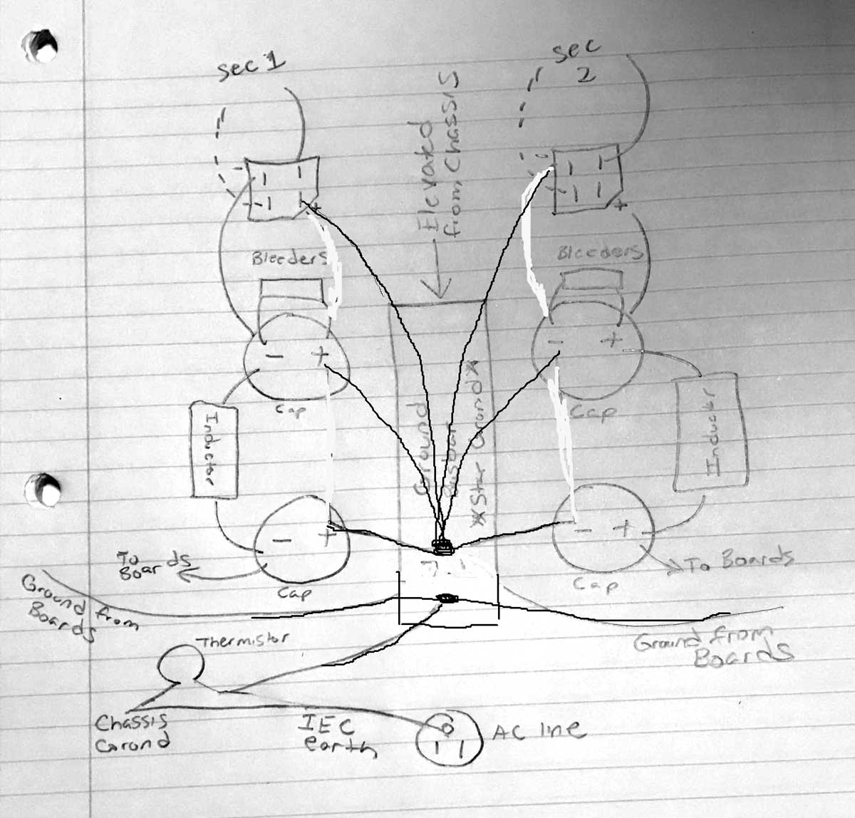

I'm terrible at explaining things but I'll give a better explanation when I'm off work. Essentially I followed the same schematic as the store PSU but instead of resistors I used an inductor to create a CLC. The caps are 82,000uF each so I'm using 164,000uF per rail. The large grounding busbar is for home doorbells or other home needs. I cant comment on how an F4 sounds between the store PSU and the one I used but I will say with the more capacitance, the noise floor is MUCH lower. My Aleph J is pretty silent on 98db speakers using the store PSU but this one I have to physically put my ear on the cone to hear anything.

Thanks, I'd really appreciate that. I keep looking at everyone's power supplies and wondering how they'd compare. I did build mine with a large capacitor reservoir... 4 x 180,000uF (Panasonic TS-UP) + a 50uF motor run foil bypass cap per rail. Thanks again for posting...

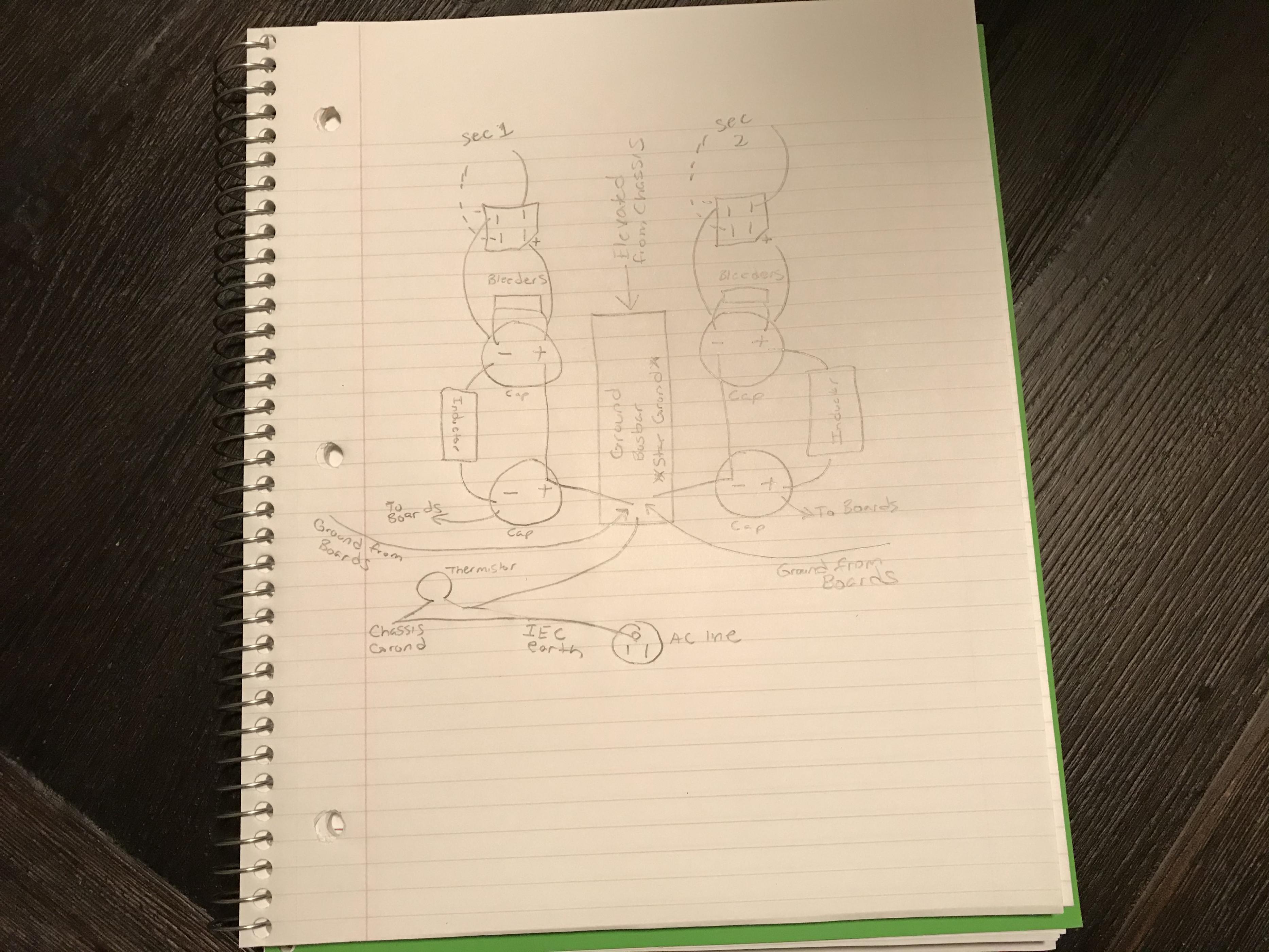

Let me know if this doesn’t make sense but this is my PS setup. And like always, use your light bulb tester. I don’t think I missed anything but it was a long day at work and I’m sure someone will chime if I did miss something

Thanks, much appreciated... that looks perfect.
Could you (or anyone else) mention why having a choke in between the cap banks is more desirable than the more standard resistor approach? Just trying to understand the circuit a bit better. Thanks again.

I’m not good at explaining theory but a choke is a reactive component with no resistive losses. A choke should give better regulation since it stores energy and has less losses than an bunch of resistors for a power supply filter. Inductors in the power supply are good at reducing ripple. Again this isn’t always the case but in a lot of cases. I’m not fully qualified like the pros here but I’m sure someone will give a better explanation than I did.
