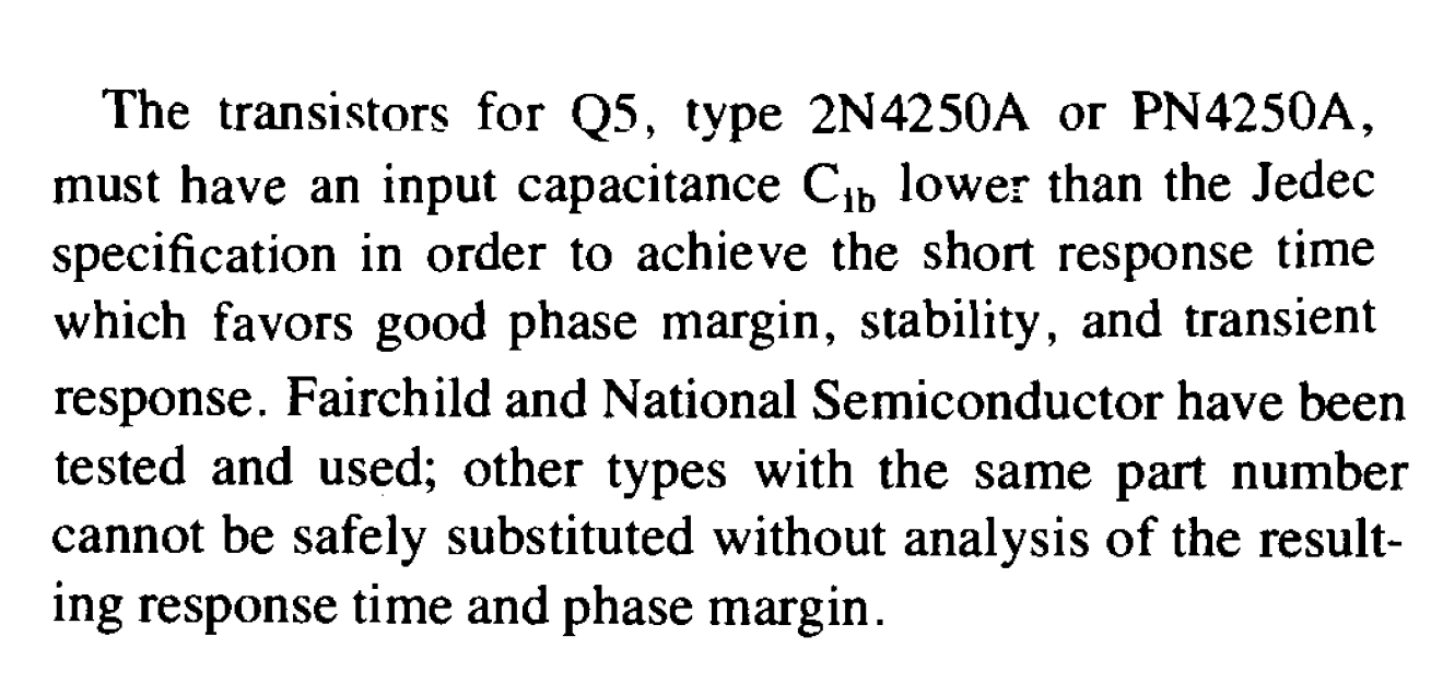

It's the inductor (thank you, Richard Burwen and Deane Jensen) and the amazing PN4250A transistor (thank you Deane Jensen). Citation
