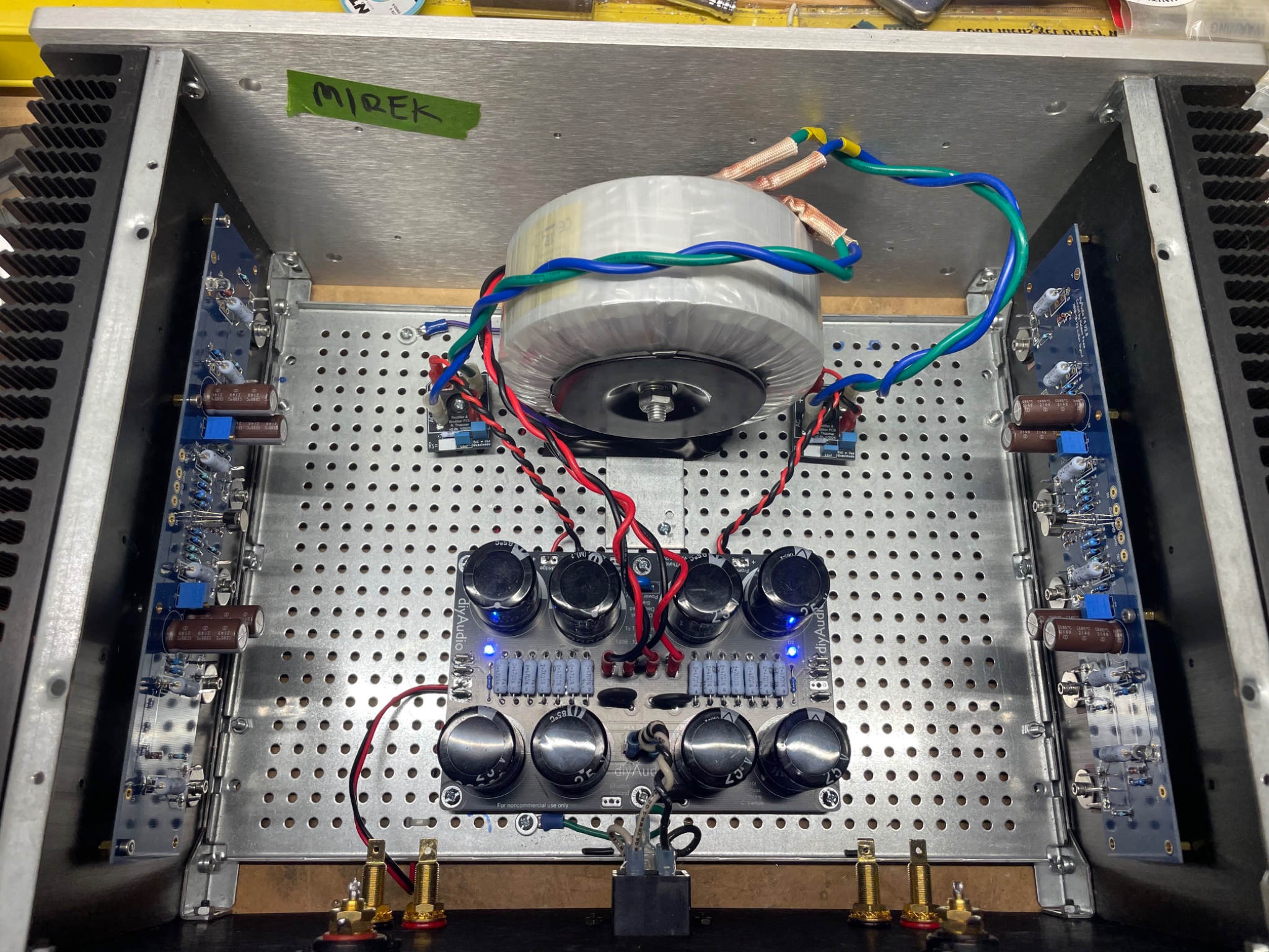

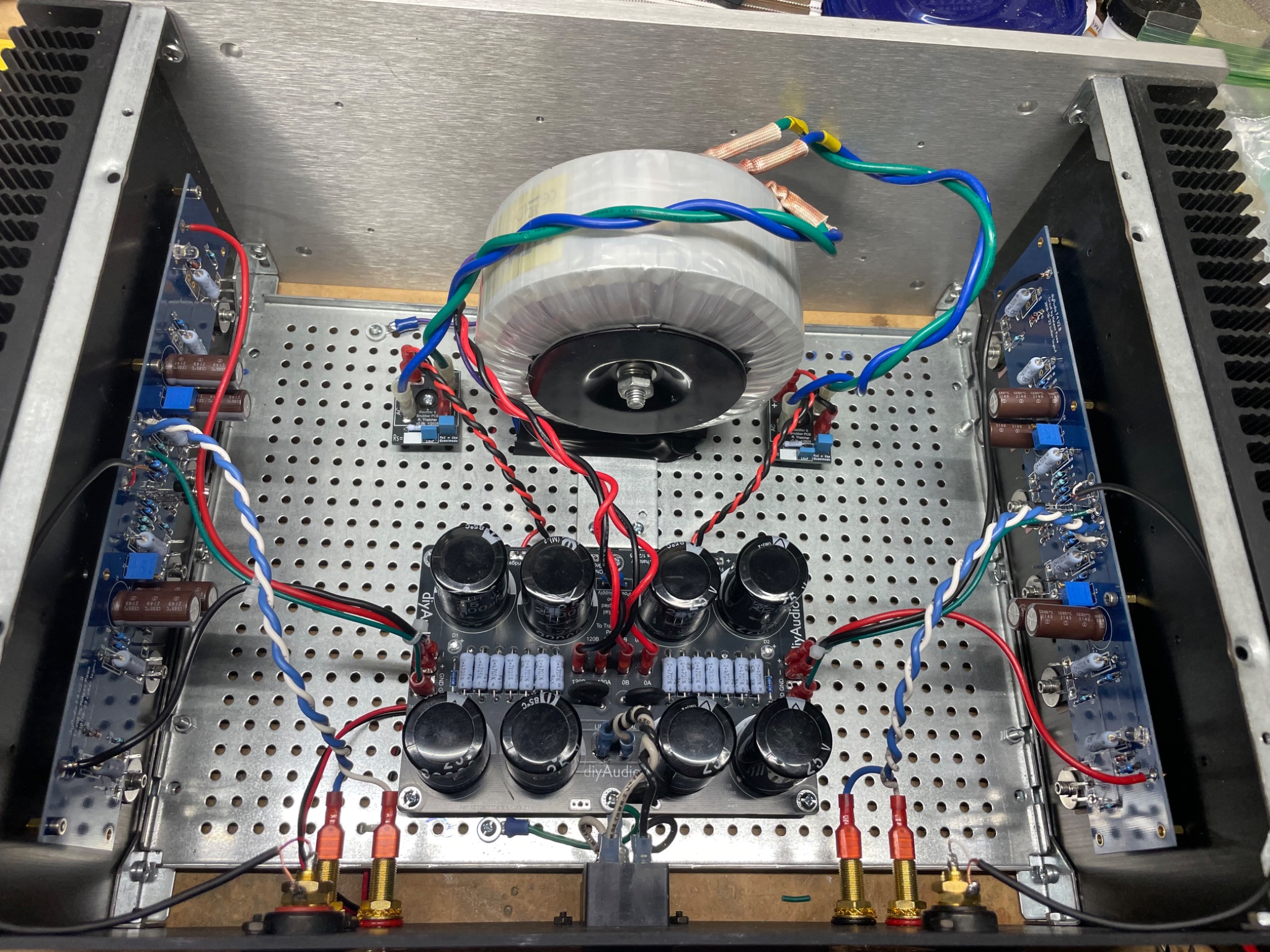

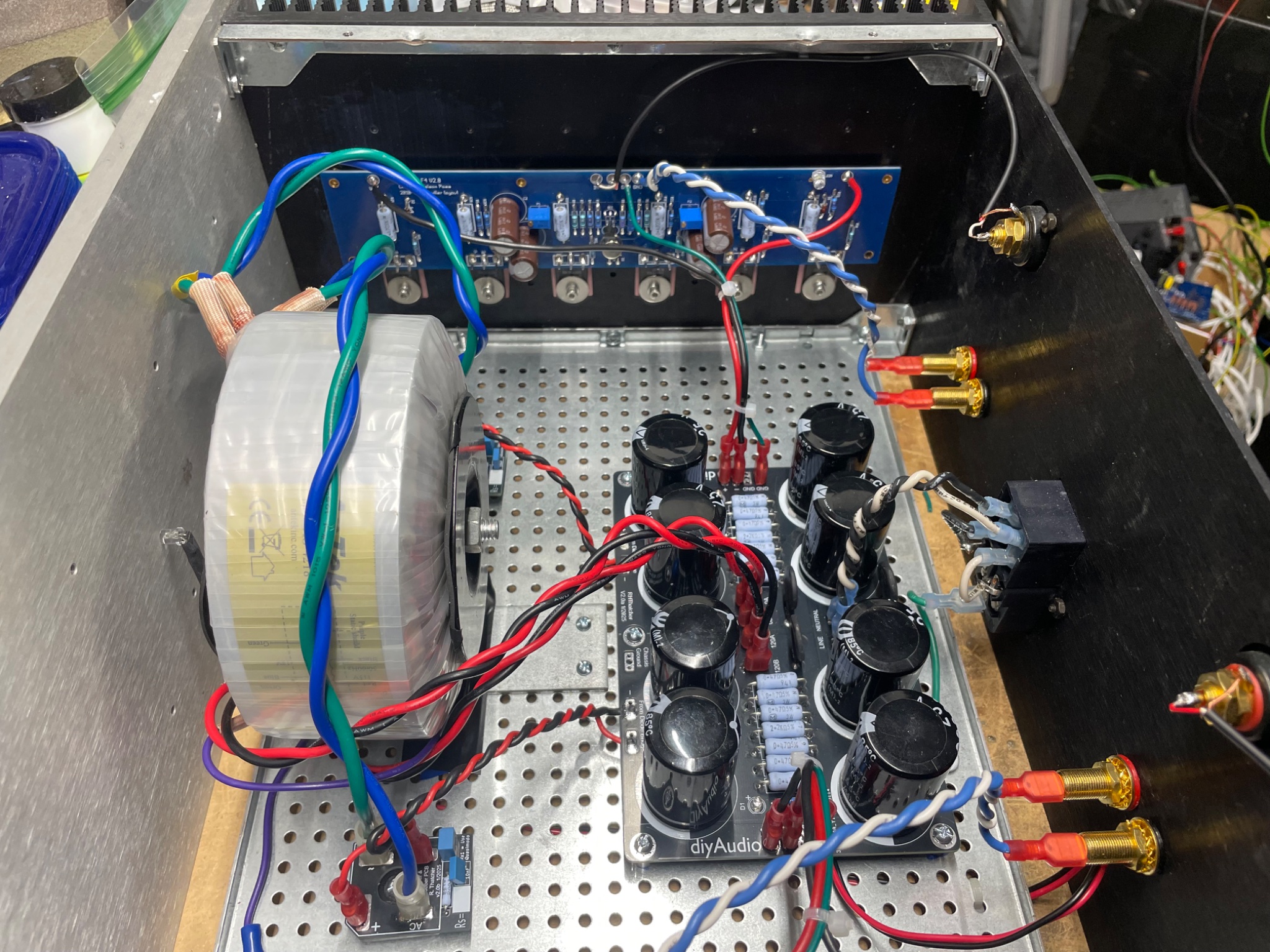

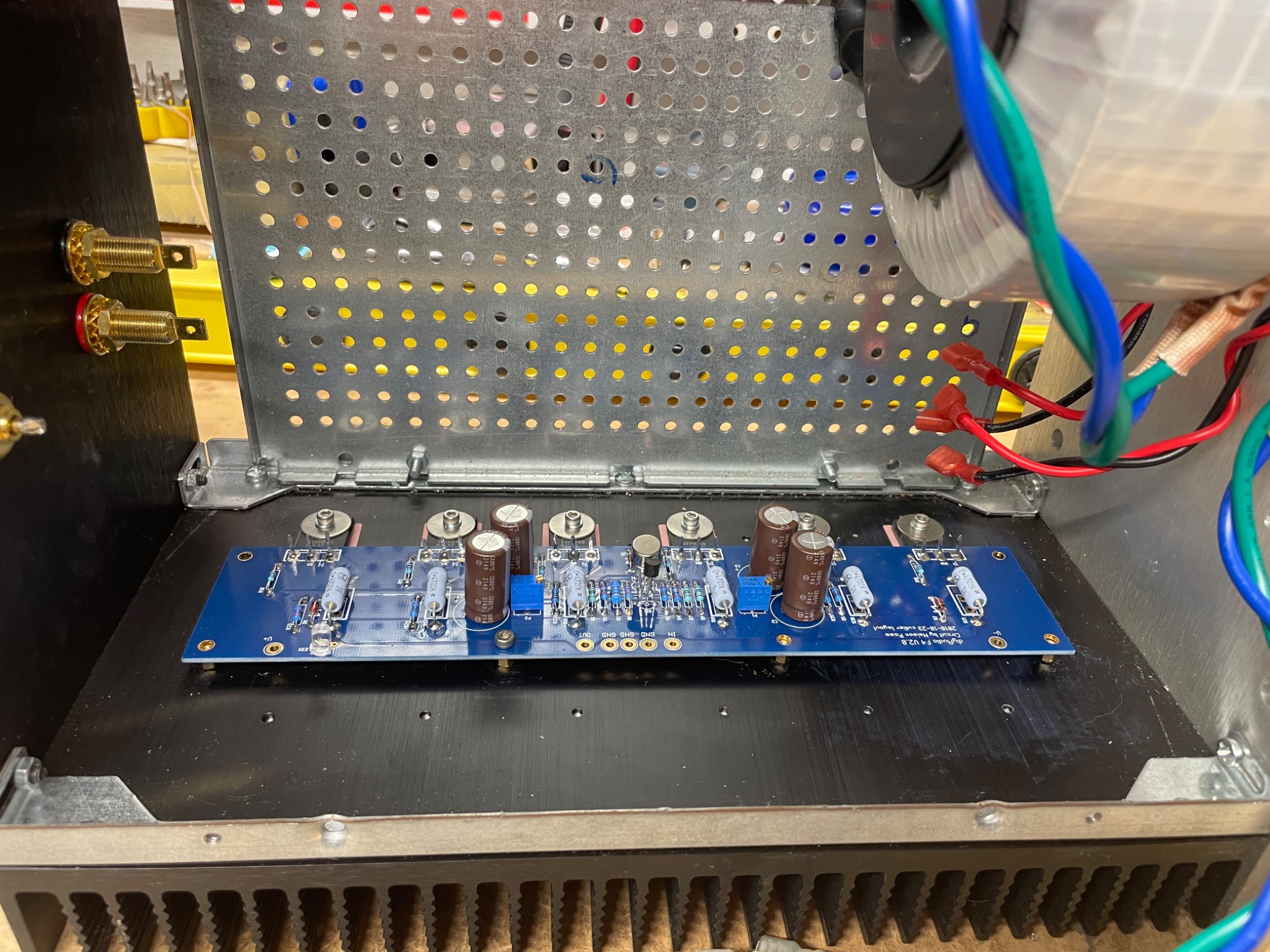

Fresh F4 build is cooking on the bench. This is a “classic” build with Toshiba JFETs, Harris MOSFETs, Silmic IIs, Panasonic 3W resistors, 400VA Antek, etc.
I love how simple the fire up, bias, offset setup is for this amp.
First thing will be to have Pearl 3 and SCG preamp feeding the F4. Then sometime I’ll swap in a Juicy Music Blueberry preamp in to the system.
Great build guide as always by 6L6! Thanks!

I cooked the F4 overnight and bias and offset are both rock solid. I just put the F4 on my Tannoys after a cup of coffee, getting the kids off to school, and seeing the missus off to work. Music is cranking and I'm really digging the F4. My first impression is that it's very transparent and punchy. I'm also happy that now I have the use of much more of the attenuator positions compared to 20dB SCG + 20dB Aleph 30 gain chain. 20dB total is plenty for this particular speaker / room / volume combination, even for heavy metal.
