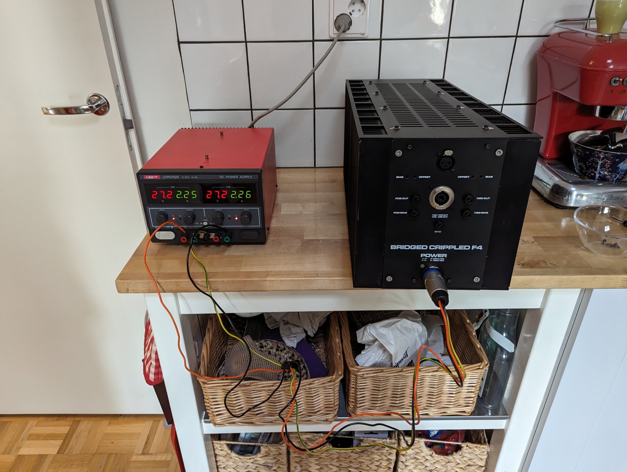

I'm (very slowly) building a pair of crippled bridged F4:s to act as a output stage for my (balanced) iron pumpkin. I'm now at the stage where I need to make a PSU (I have tested them to work with a +/- 28V psu, but this leaves little thermal headroom to crank the bias), and I would like to ask what the lowest reasonable rail voltage for bridged F4 is.
I have efficient speakers, and 4 V RMS is loud enough. A bridged F4 is really silly for me, but this is what I am building=)

With 28 V, it gets uncomfortably warm somewhere above 200 mA bias.Lowest reasonable... ??? I think I've seen some posts from trusted people say perhaps 18-20Vdc has produced acceptable results. However, why not try the 'factory' 24V first? If you're running the 'factory' Iq now at 28V, and your goal is to crank it and/or have a bit of headroom for hot days... that might get you there.
Transformers are expensive for me, so I would like to go for a reasonable low voltage from the start.

A cap multiplier is a good idea, but my 28V psu is for the diy vfet part 2, which i love and want to keep operational.
Also, that psu is not quite up to the load of two channels of this.
Thus my need to build a new one (like dual mono 600va or something, toroidy goes much more expensive at 800va).

Makes perfect sense. I'm sure you know this, but the dissipation drops with the square of the voltage, so you may not have to go too far... If you drop 4V on the rails, that gives you 'quite a bit' of room to play with Iq, IMO. As @Stanislav suggested above, maybe you can experiment by dropping a few volts prior to making a commitment.With 28 V, it gets uncomfortably warm somewhere above 200 mA bias.
Is there anything I'm missing that prevents you from dropping the voltage on the bench PSU in the photo to test how you like the particular sound / measurements of lower voltage / higher Iq?A cap multiplier is a good idea, but my 28V psu is for the diy vfet part 2, which i love and want to keep operational.

And of course, you are correct in that I can just test it with the bench PSU. Stupid me again =)
