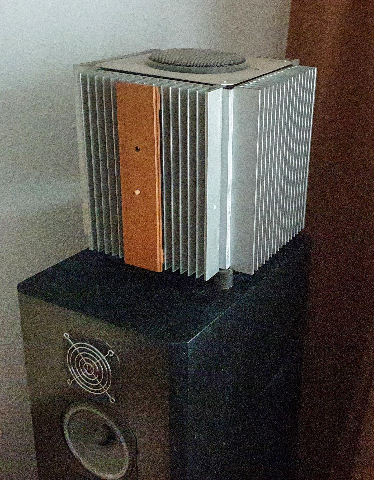

I don't remember why I used balanced XLR interconnects between the preamp and power amplifiers when building more then 20 years ago my audio system. Probably because I wanted to be more professional.
I recently experimented with bi-wiring between the F4s and the loudspeakers - I used a LAN cable to power the midrange and tweeters. The sound has improved a bit. It is true that I found a video in which a guy destroys the myth of bi-wiring quite logically explaining why it does nothing. For me it worked because the LAN cable is better for medium and especially high frequencies.
And now it turns out that all this doesn't make sense because I got even better results in the following way:

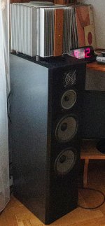

I significantly shortened the speaker cables (I gave up bi-wiring) from 7 meters to 1 meter, and as interconnects between the F4 and the PUMPKIN preamp I used 10 meters long XLR cables. I put the F4 monoblocks on the columns, which certainly won't please my wife. As a result, the equipment clearly gained a new quality - more details, a deeper stage. The sound got a bit too aggressive, but it's enough to turn it down a bit. I have two Chesky test CDs and enjoy listening to test samples that demonstrate stage depth. And the rain test - now it's like pouring from the sky and splashing on the floor in the room. I hope I didn't say it at the wrong time because once the neighbors flooded us twice. And on the beginning, when I started with the equipment, this test was an annoying rattle.
